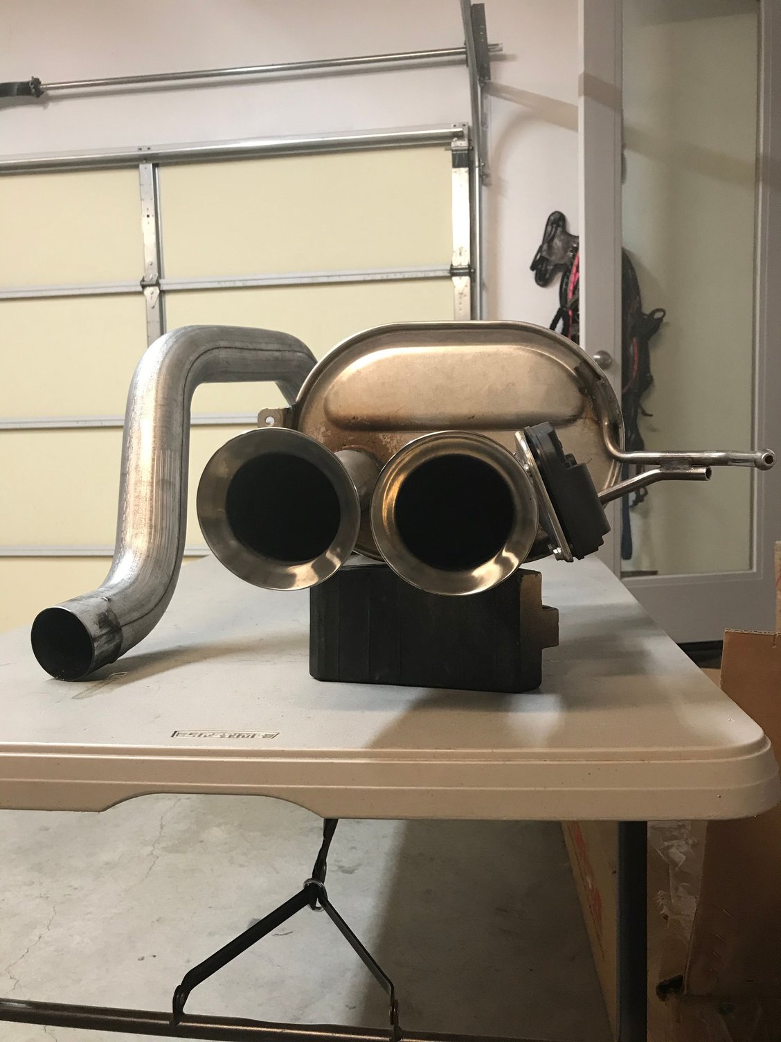

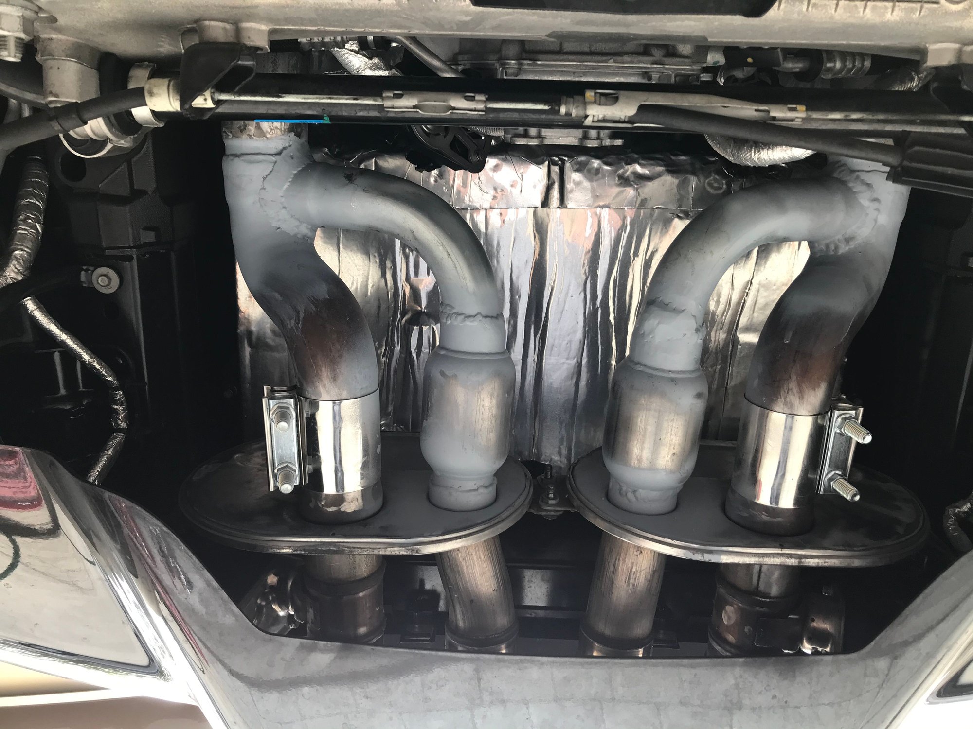

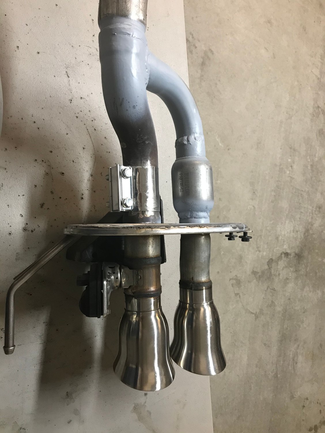

So now it time to bolt them on and see how it sounds

Awesome looking WINDOW Mod! Now you can Watch the Exhaust FLOW!

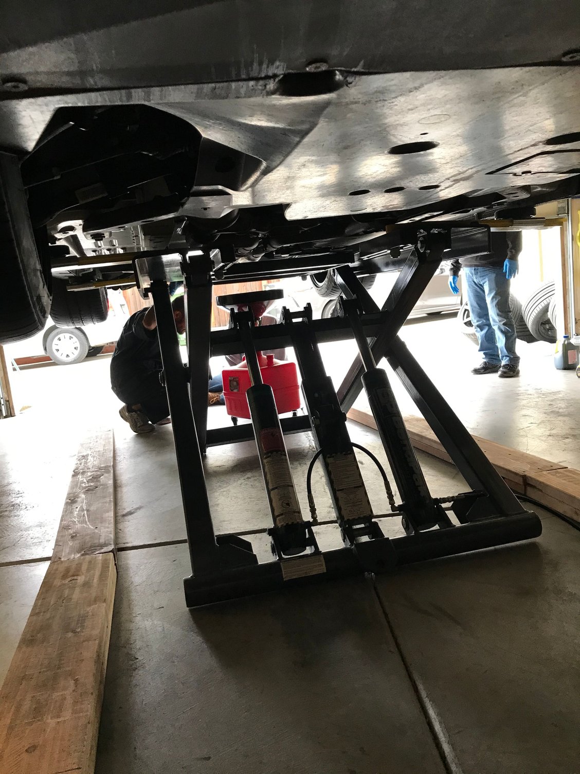

To Muffler Mod
Old Apr 25, 2021 | 12:55 AM
  #38
0311 jarhead's Avatar
0311 jarhead
Veteran: Marine Corps
Joined: Sep 2019
Posts: 923
Likes: 155
From: North Port, FL
Originally Posted by MorrisZ51
Who makes that lift ?

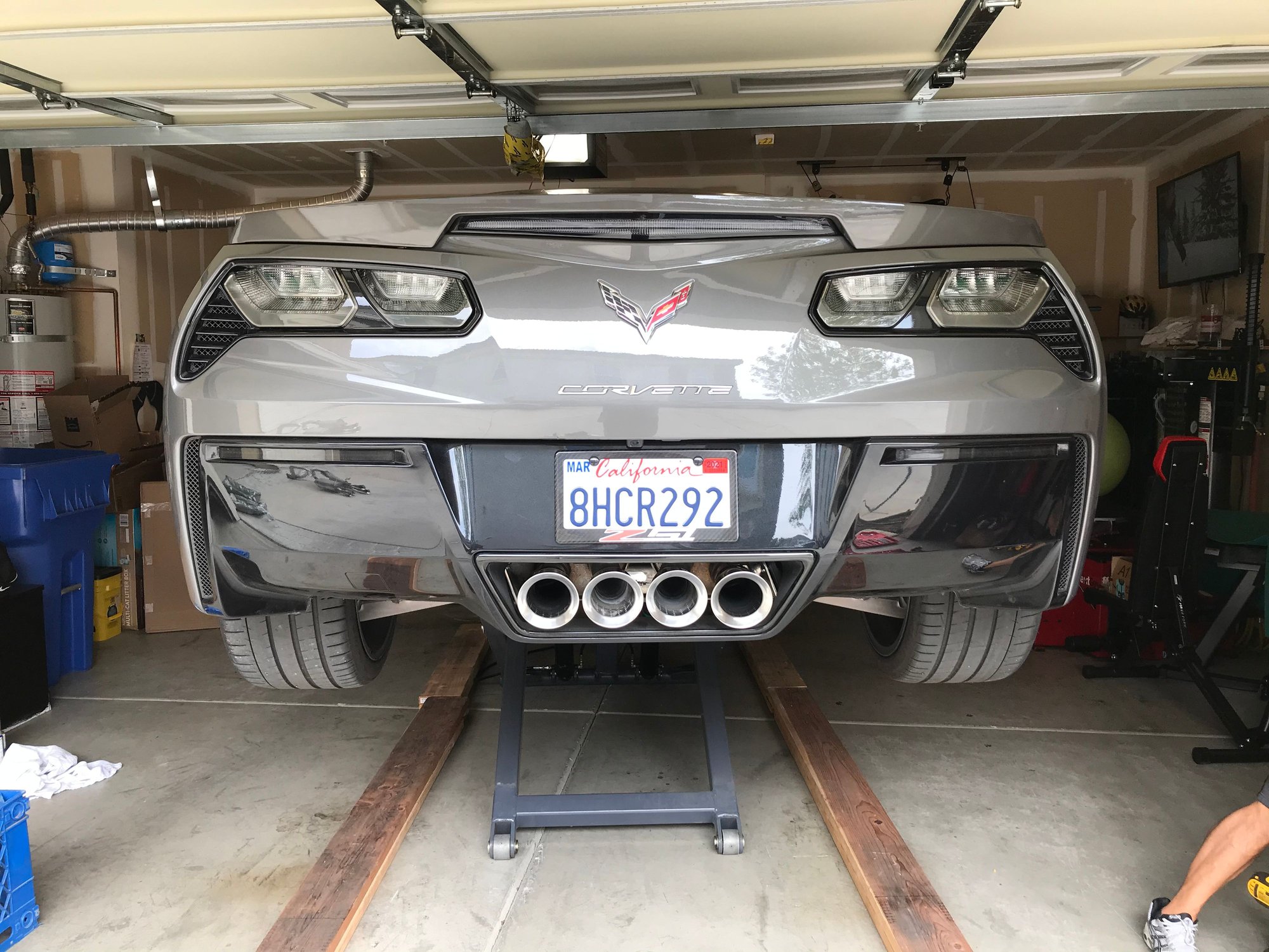

Old Apr 25, 2021 | 07:07 PM
  #39
MorrisZ51's Avatar
MorrisZ51
Joined: Mar 2020
Posts: 458
Likes: 104
From: Brentwood
Old Apr 25, 2021 | 07:09 PM
