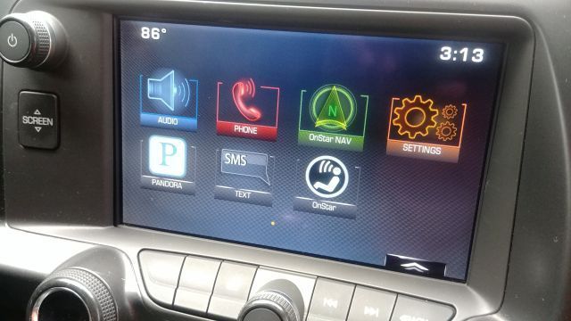

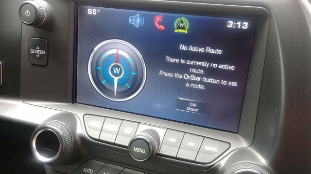

So Bill, my infotainment unit (C7) has a Nav icon. The display does not show a constant screen of location in map form. When I need directions I go to app or contact OnStar and they dowload directions with voice prompts and small directional icons. My thinking was that all units are the same except software. Which may allow some to view a constant map. So, can I change software to provide a constant map of location or are the units different in every way?
