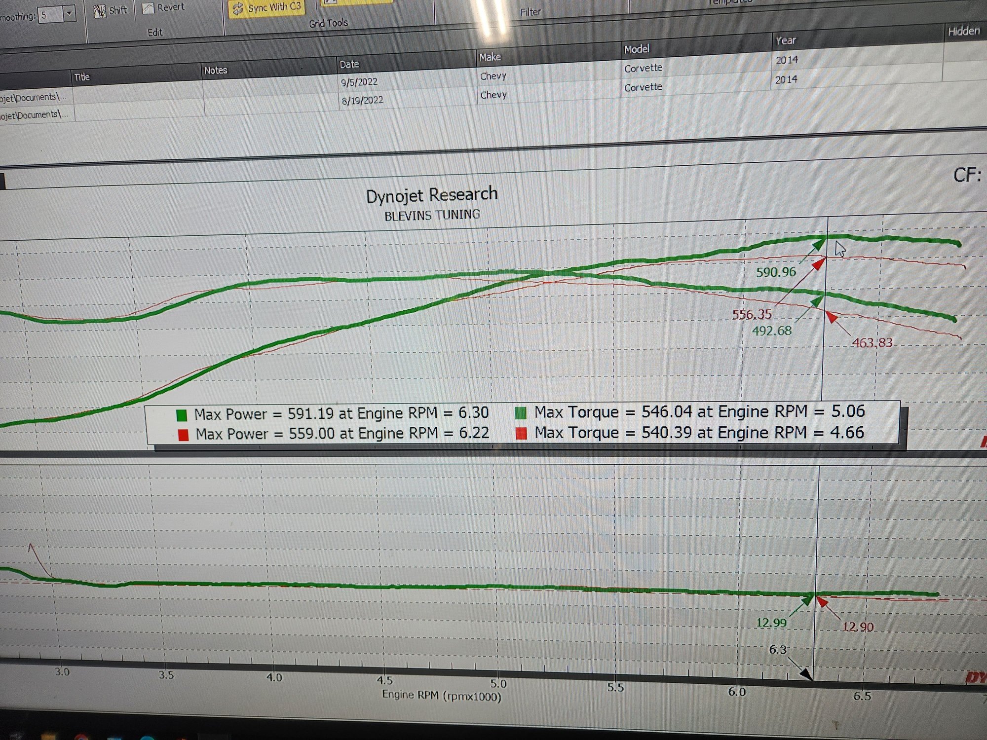

Un ported msd vs stock lt1 manifold on a 416 stroker. Prc ported heads. Custom tsp cam and e60 fuel. Very conservative dynojet in 100* muggy conditions both times but the gains are un deniable. Nearly 40 wheel+ out the back door.
