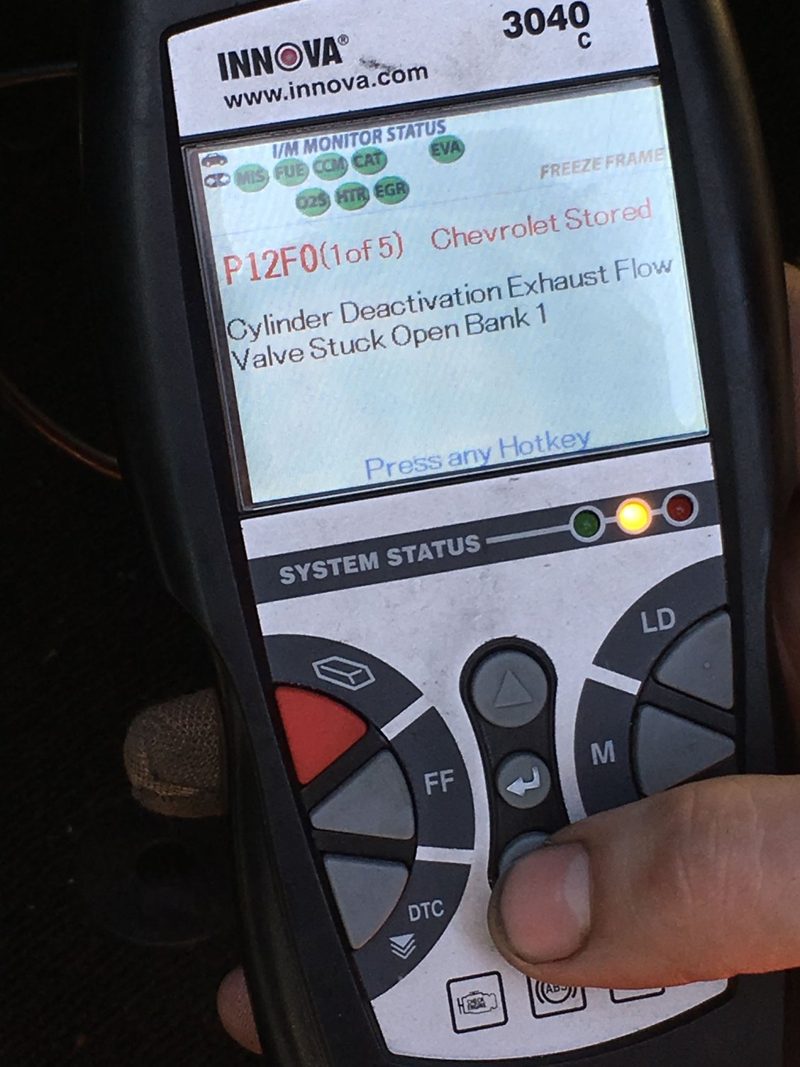

What was the exact code?

Default Here's a pic

That is not NPP related. That is related to the AFM valves (front most set of valves). The NPP valves to not supply a feedback signal to the CCM.
I developed plug in modules that will allow you to ditch the AFM valves altogether if you wish to do so. No CELs and AFM will still operate.
https://www.corvetteforum.com/forums...te-module.html
Contact Edgyvette if you would like to purchase a set. Revision 01 is the version you would need.
Tim

I'll look into that. Yes it was motor for the AFM driver valve. Now the other is acting up a tiny bit. I'm asking if there's a known issue with the AFM valves?

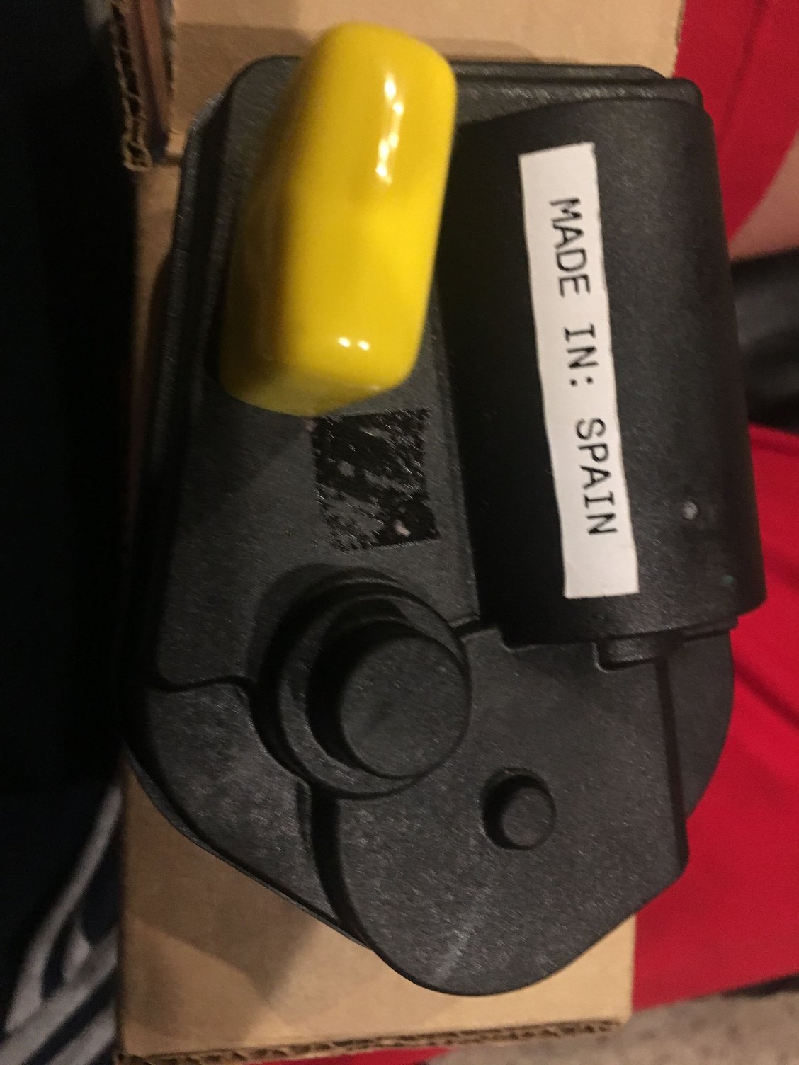

Default Factory valves
No, I don't do any racing. I've taken the car to 110-120 a few times but usually less than 30 seconds. In the old motor, it was obvious that the gear stripped as you can freely turn the piece that fits into the valve. I applaud Borla for attempting this, but my thought was in their design the valve was sloppy in the pipe compared to the factory. The replacement valve looks slightly different and the supplier seems to have changed by the tag on it, so maybe they have had issues from a previous supplier?
