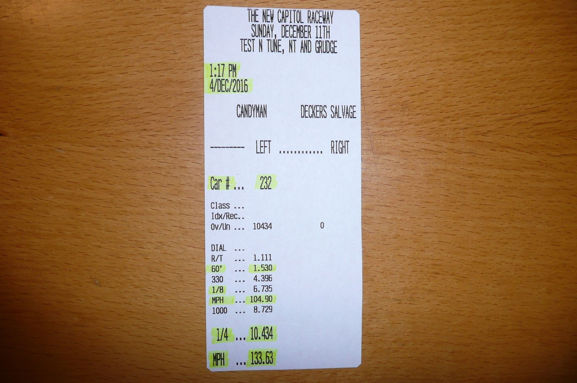

Here's how my AFE-1 (w/low flow gray dry filter) runs with the stock tune, maybe some more to be found? I 'think' there are more modified C7/Z06 AFE's in the 9's than Halltech on this forum.

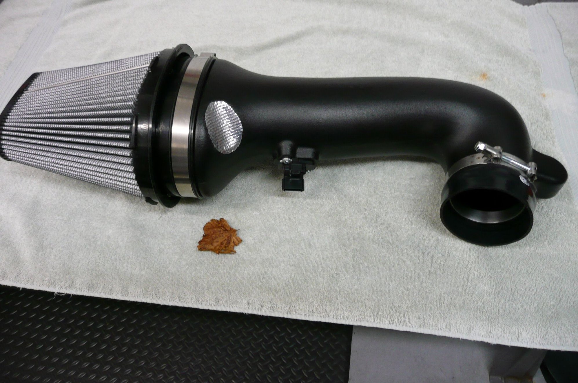

In the AFE-1 pic below you can see where I added a home cut out stick-on 'egg shaped' heat reflector to the bottom side which is out of sight where the radiator hose goes by (but does not touch) the air tube.

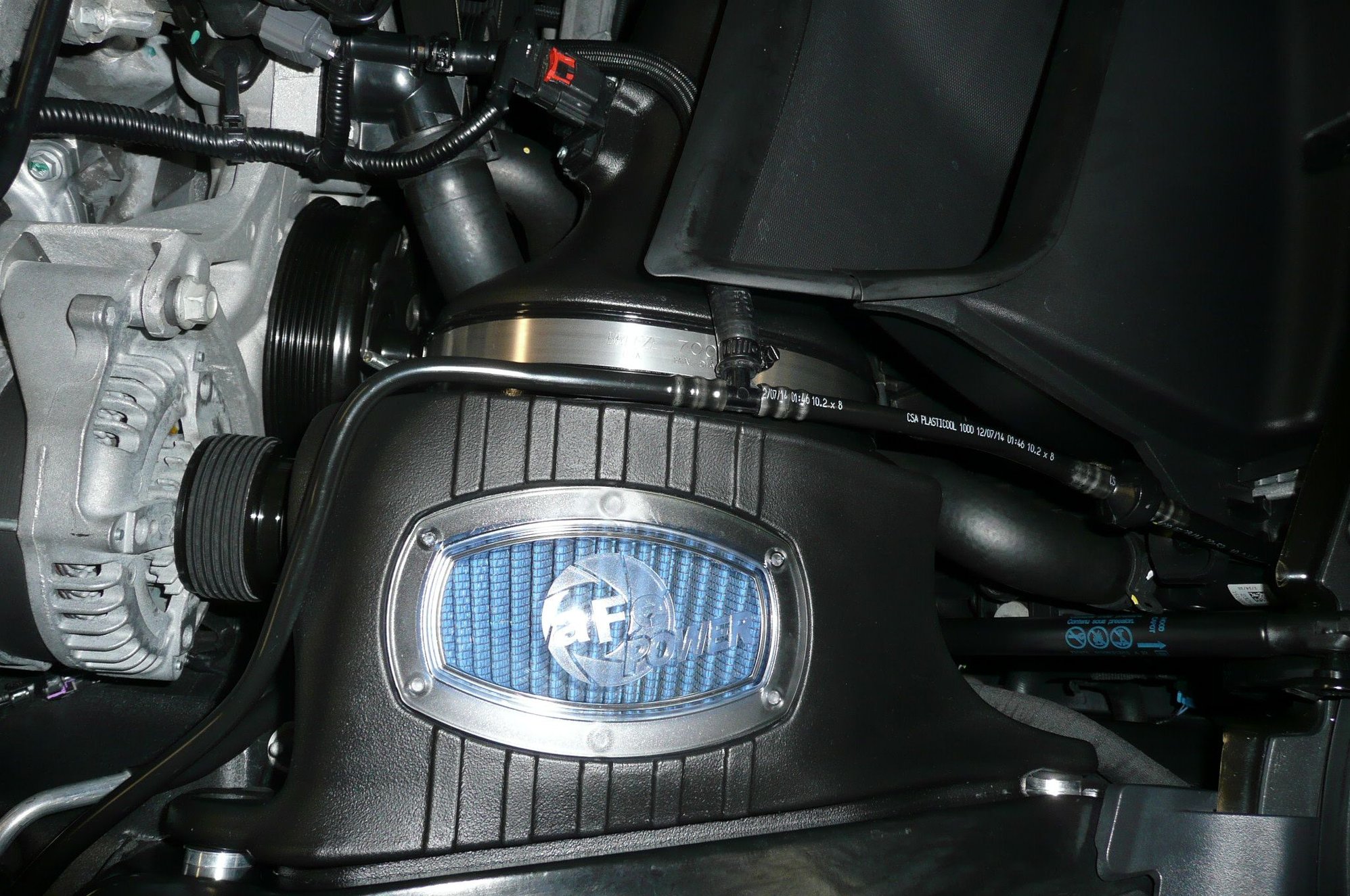

Then you just stick what you see above into the AFE air box that is already bolted on the pass. side fender. There is a rubber seal that is part of the air filter that seals to the air box surface opening on the newer AFE-1 and then just clamp the other end to the throttle body with a second clamp that is not in the pic above. Oh, and you do not need to mess with that small coolant hose at all, it went over the top just like on the stock air box just fine for me. See below.
Note: I took that small non-stock 'screw clamp' back off the small rubber hose above and replaced it with the 'original' stock spring clamp one later on. If you need or want to go back to stock with no hose mods, etc. this is it.
