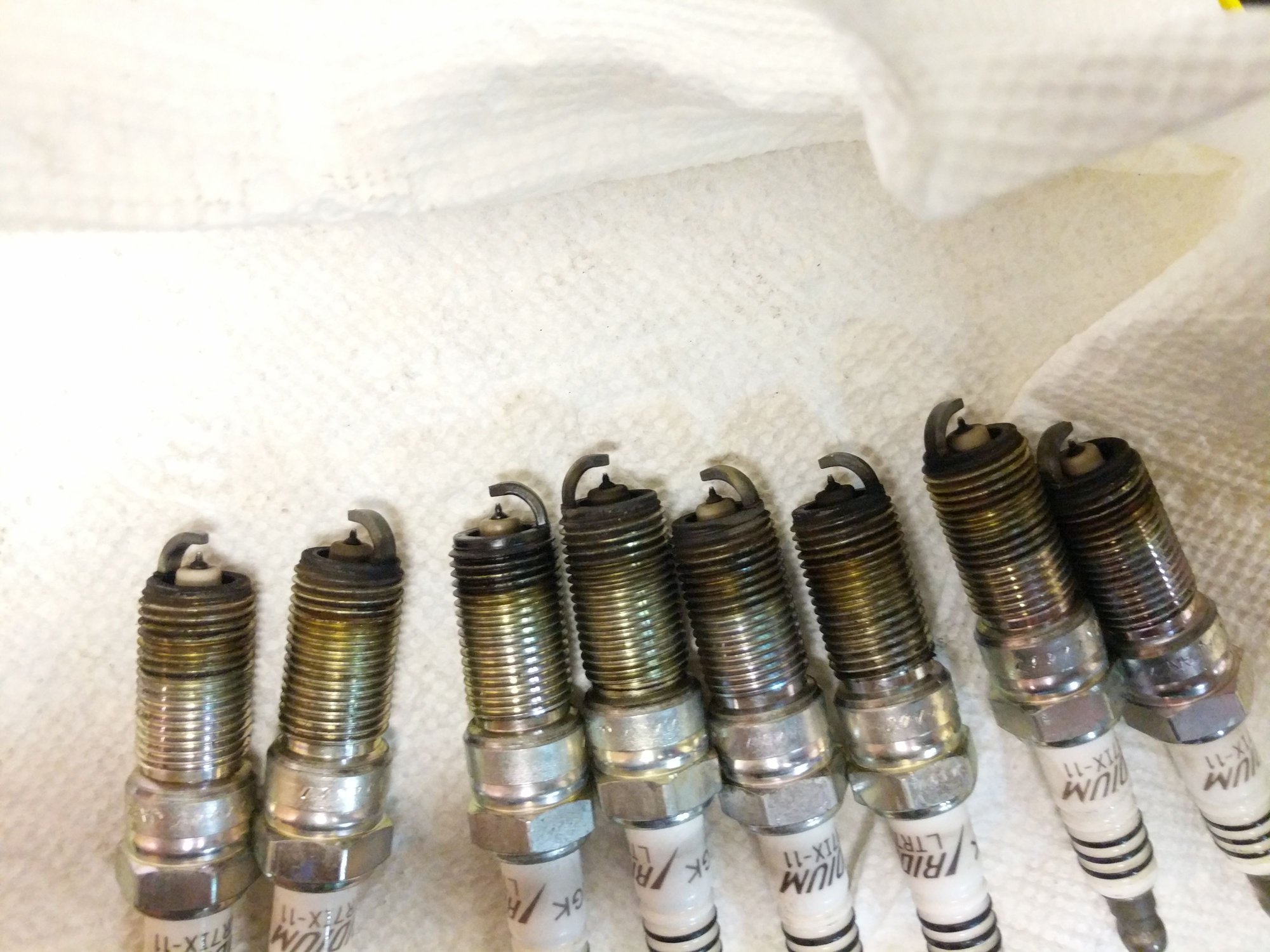

Always keep them in order! Do you have a picture of all of them (the tips) so we can see how its running?

Unfortunately, not sure which one is from where
Third one from the right looks pretty rich. They don't look as bad as I was expecting though. You sure your getting white smoke out the exhaust and not black? White smoke coming from the BOV is weird. Perhaps you have more oil somehwere that is burning off. I had a similar problem with the car running a bit weird. Pulled the plugs, cleaned and replaced, same issue but not as bad, repeat, etc. eventually it was back to normal just had to clean out the leftover csrbon buildup from running rich.
# 2 3 5 7 8 Looks good the one as what Ant has said looks rich, But # 1 looks like it is doing nothing in the hole.
