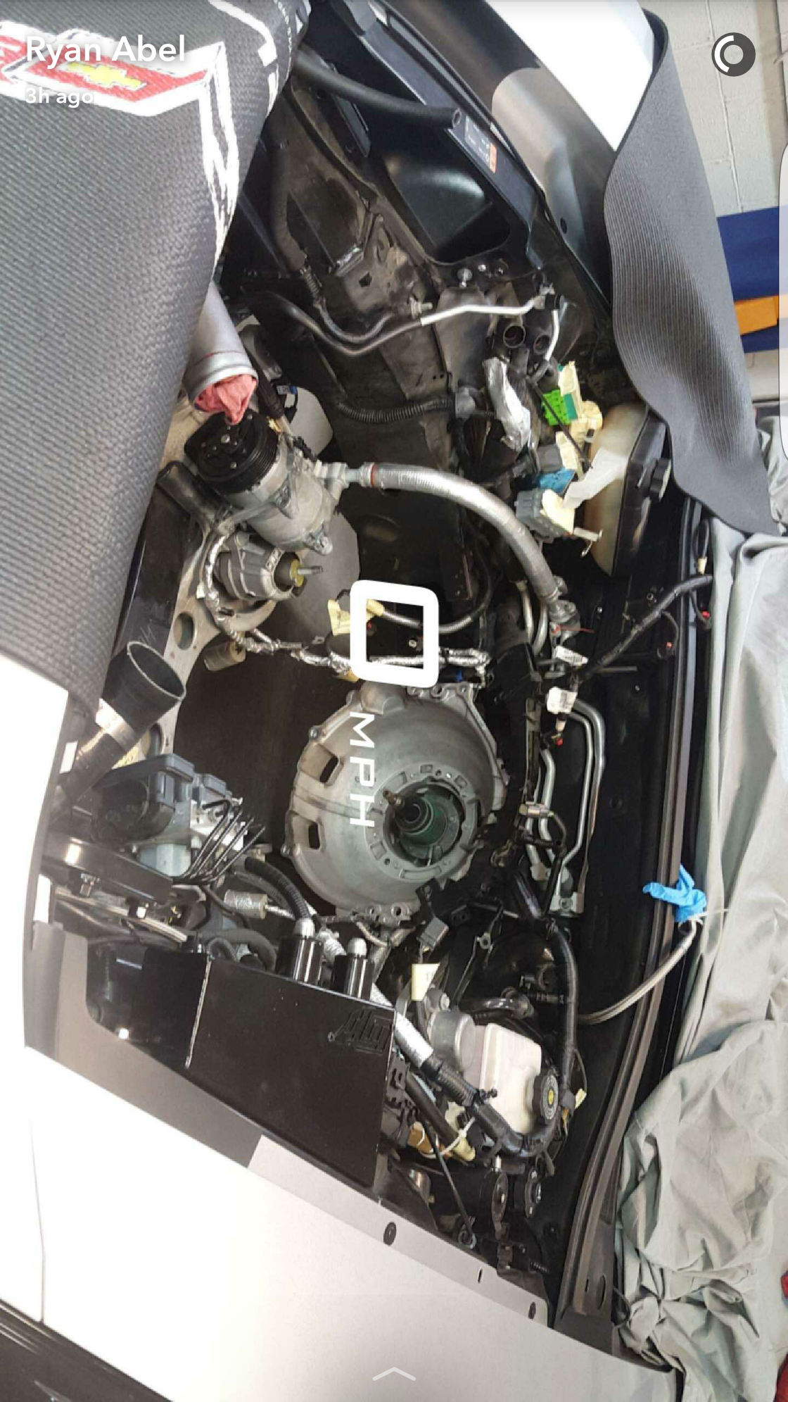

Unfortunately the GM Factory Service Manual (at least the 2014 version on AllDataDIY.com) seems to neglect including any information on the Oil Temp Sensor for wet-sump engines. I suspect it is co-located with the Oil Level Sensor, which is mounted in the oil pan, and the wires exit the side wall of the oil pan, on the passenger side.
The Dry Sump engine has the oil temp sensor screwed into the side of the oil tank, behind the passenger side fender.

that picture looks familiar lol
I checked the 2014 helms manual and confirmed the dry sump sensor location and as you mentioned, they neglect to mention where the sensor is on the wet sump motor..
Ant
I have a similar photo to share. The sensor worked fine when the engine was reinstalled. But has since stopped working. I've reached the conclusion that it must be integrated into the oil level sensor. Although my trusty GM parts guy wants to sell me a sensor that looks exactly like the coolant temp sensor. And this is per my vin.
