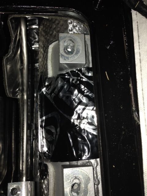

Old Apr 7, 2018 | 05:55 PM
John Micheal Henry's Avatar
John Micheal Henry
Joined: Jan 2005
Posts: 1,556
Likes: 276
From: Marshall Texas

Kind of a highjack but here it goes. What is the reason for all of the extra heat installation when installing the MGW?
The only thing which makes any sense to me is the more solid bushings in the shifter box could bind when too hot where the factory ones can tolerate the heat.
Old Apr 11, 2018 | 10:07 AM
DomLS3's Avatar
DomLS3
Joined: Aug 2012
Posts: 657
Likes: 192
From: Memphis Tennessee
Well, there's two different types going in. One is heat shield material, the other is sound dampening material. It's not a required step to install either, but does help with noise and heat coming through the shifter area. It's more of an "if you're there, might as well just do it" kind of thing, but not a necessity. Just helps a little with heat and road/shifter noise.

Old Apr 11, 2018 | 10:16 AM
brettmess24's Avatar
brettmess24
Joined: May 2016
Posts: 310
Likes: 45
Originally Posted by djpelosi
Well, there's two different types going in. One is heat shield material, the other is sound dampening material. It's not a required step to install either, but does help with noise and heat coming through the shifter area. It's more of a "if you're there, might as well just do it" kind of thing, but not a necessity. Just helps a little with heat and road/shifter noise.
This was my take away as well, more so for sound and comfort and replacing that second rubber shield with sound deadening at the source. They know how picky we are
