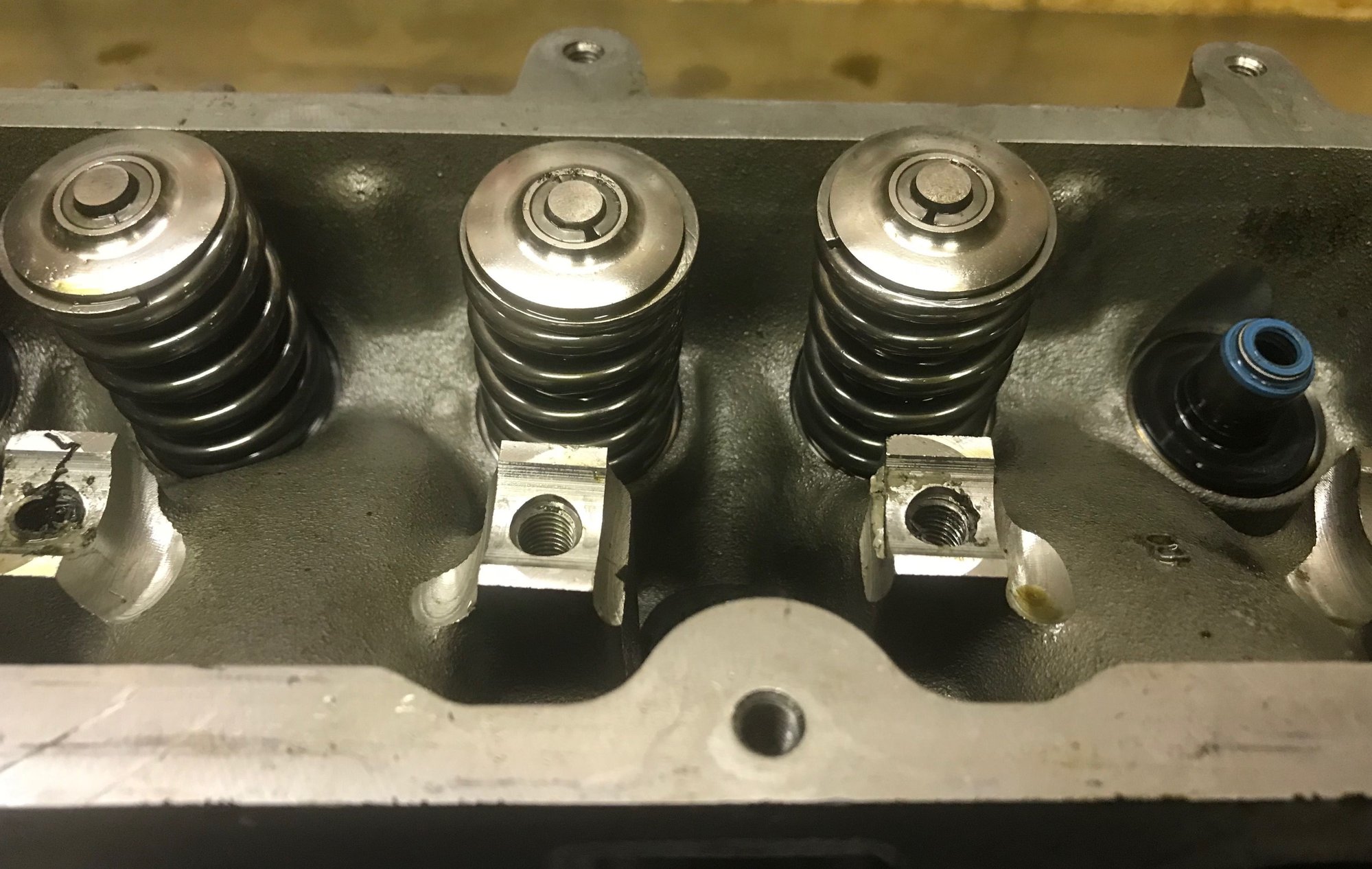

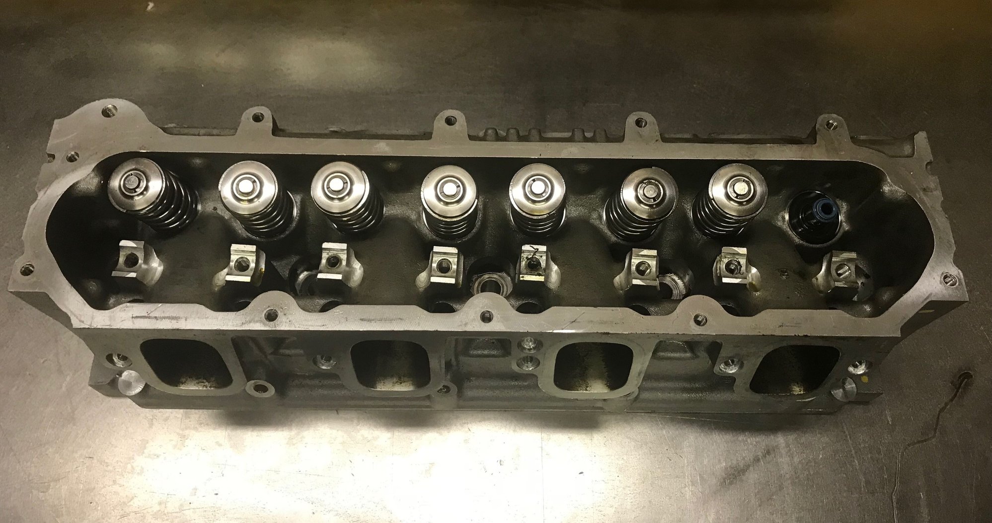

The Corvette is a 2015, here's a couple pictures of the top of the head...

Wow, I've never seen rocker arm bosses beat like that. Valve spring bind? What was the lift on the cam?

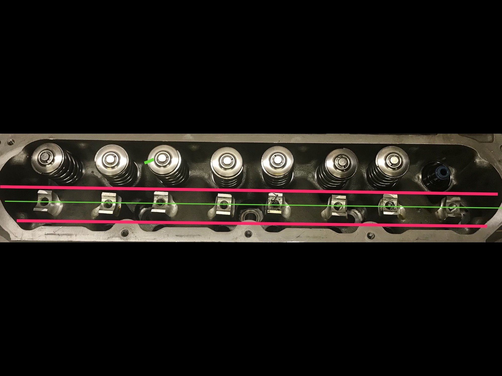

Is it just me or do these just not look right ?
Those look fine. They are offset because one is for exhaust and one is for intake for each cylinder and they are not the same size.
A lot of smart people in this thread already so you have the attention of the right crowd. Lets get down to a few details first -
- Did you do the cam and heads and re-use stock valve springs and retainers and pushrods?
- Did the shop measure installed height of the pushrods?
- Who tuned the car, and what experience do they have?
Shops that say “yea we’ve been tuning LS motors for years!” Blow up a lot of LT motors because the DI LT motors are wayyyy different on tuning then the LS motors were.

^^^ I agree it is like Ant is telling you those are off set due the head design to get more out of on air flow. One for the intake & one for the exhaust port .Some I still say is wrong or set up not correct on that #8 hole in the head. Also more than not in the tune also.Robert

I would like to see the valve spring retainer and valve locks for that valve.
Trust me , I'll be looking for them ...
That’s going to tell you if it was bad luck/components or if it was an ******* with a ratchet. And I’m being nice. Sucks you’re dealing with this..

That's def a dropped valve. I'd suspect mechanical malfunction rather than a tuning issue. Could have been an issue with the head work or you could have broken a valve spring. One is the machine shops fault, the other could have been a bad spring/retainer assembly.
