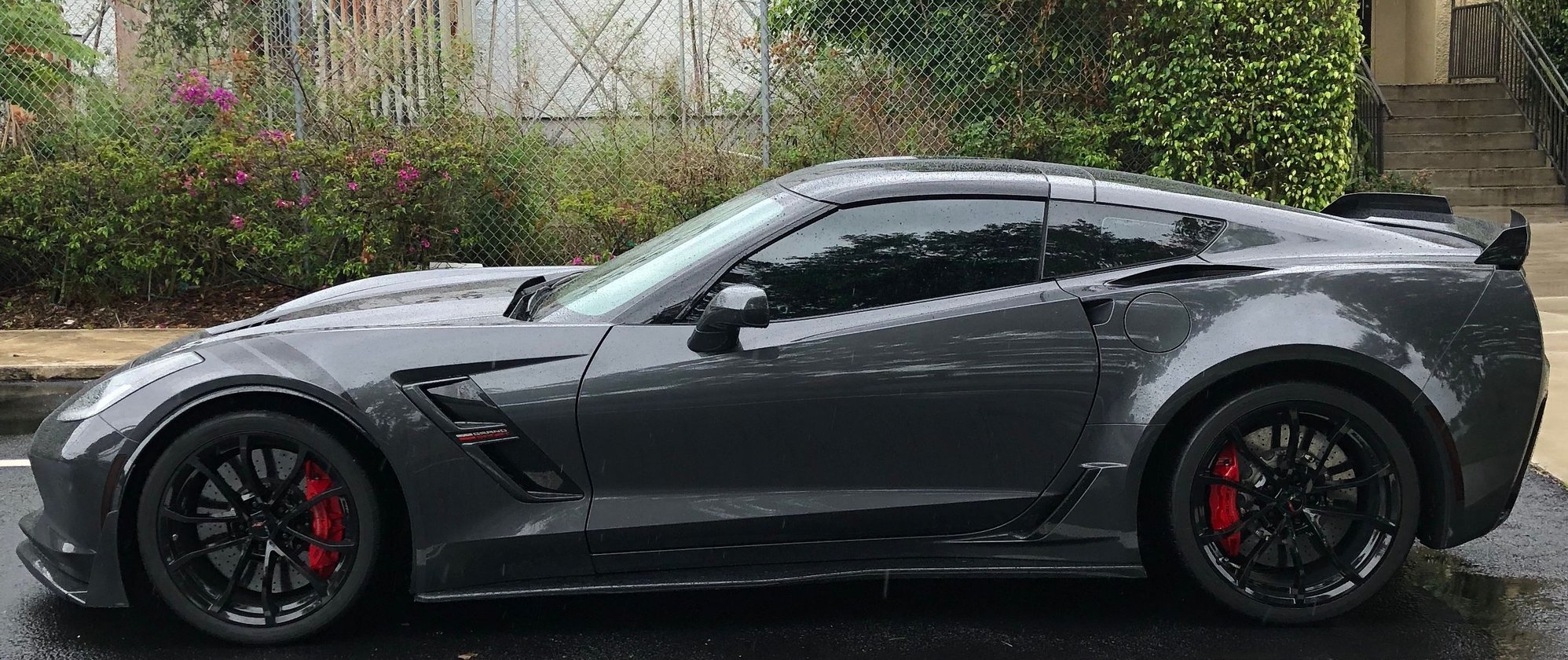

I’m all the way down on the rear bolts, thanks. I still don’t care for the 4x4 look. Taller tires could help(and help with ride), but I don’t see anything that fits well and comes close to the performance of our stock tires.
A couple pics, comparing my car to GM's advertising. Notice the rear wheel gap...
My GS, rear bolts all the way down
GS on Chevy's website

The blue GM picture definitely does not look stock, unless the Z07 package includes some serious lowering. I know the owner manual has a section about track prep that might discuss lowering, but not that much.
Everyone has their own taste, and it's your car not mine, but the words that come to my mind when looking at the GM photo are "rice" and "ugly".
The curve of the tires and curve of the wheel well "should" be concentric, or I wonder "how did his springs get broken?"

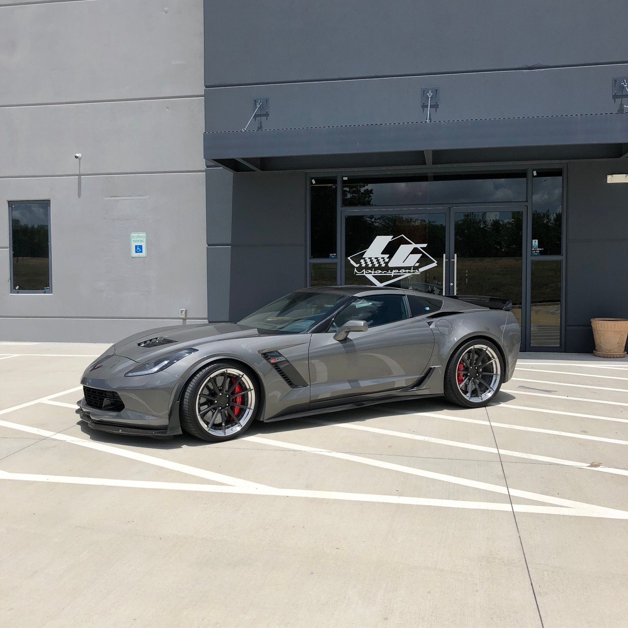

Drop Spindles alone shouldn’t cause issue for you, the Nurburgring car is dropped 1” with the spindles and roughly another 1.25” with coilovers. Here’s a pic with drops only

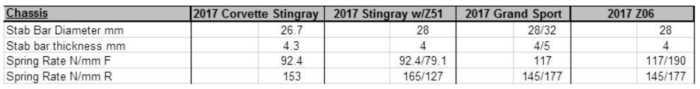

So I've done a lot of reading on spring rates, and suspension setup theories. Looks like there are a few choices for rear spring rates:
Where did you find the spring rates? Any chance you have C7 ZR1 too?
No, I got this table from a thread in 2017
To Change rear leaf spring
