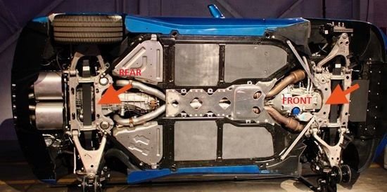

Possibly. The problem isn't that the jack doesn't fit under. It does. You just can't pump the lever. Too far under. It hits the exhaust. Did you see my post #24 that shows a pic of the bottom of a C7? The jacking point is the cross member that's more forward so makes the jack go pretty far under. I didn't have much time when I got home tonight because the weather was really nice and I wanted to go for a drive before it got dark. If you want I can take some pics for you tomorrow.
Thanks for taking the time to post up your thoughts and pics. Interesting as there is good info here. Just wondering one last thing about jacking in the back. In the back of the car there is another cross member that is further back and is adjacent to the exhaust mufflers. JerryU on the forum posted a pic circulating on the forum that shows you can lift from that cross member also. Did you try lifting from that cross member? It would seem it would give your jack much more clearance to be able to operate the jack handle lifting at that pont. Still trying to wrap my head around finding the best procedure and tool combination to lift the vehicle up on all fours to do an oil change safely. What combination of jack(s), jack stands, pucks, other would make for the least amount of effort to get the car lifted? I was looking at race ramps and they sell 10 inch support blocks that cost $100 for a set of 2 and would not require any jackstands and seems very safe as the vehicle would be supported by the tires sitting on these blocks. Just unsure how I would lift the vehicle incrementally to get all 4 wheels up 10 inches off the ground. Can I lift one side of the vehicle up a full 10 inch in one try?...or do I need to do it in steps? Decisions, decisions.

Race ramps are a good option. If you’re just doing an oil change on YouTube. I can tell you how I did it. I actually did it just like a Youtbe video showed. The guy is a member here who did it. Just look up C7 corvette dry sump oil change on YouTube. You use a puck and lift on the driver front. Put a jack stand under it. Drain the oil on both locations and remove filter. Then remove jack stand and lower car. Let the remaining oil drain. Lift the car again and finish the oil change. Easy.
The rear cross member looks like it could be jacked there but the manual doesn't not point to that location so I'm reluctant to use it.
