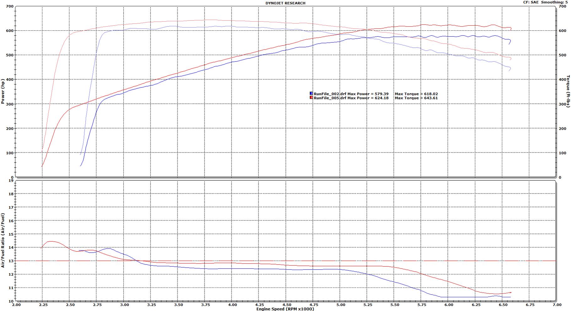

LT and ST fuel trims WILL compensate during closed loop operation. They WILL NOT compensate during open loop (WOT).

It is on an LT4 when it goes into COT, not before that. I can't say about the LT1 tune. Still, making a blanket statement that the LT and ST will compensate may make some folks think they will make up all problems.

As you can see, my factory ALL STOCK tune commanded a 12.4 AFR until COT kicks in at about 5,000 rpm, the blue line. But with a CAI it ran a bit leaner and didn't go into COT until higher in rpm, the red line.

While I agree with you that IN THIS CASE, with a properly designed CAI, the OP will MAYBE OK, but a blanket statement that the long term fuel trims based on the narrow band O2's will fix any improper fueling inputs is VERY scary and might cause a blown motor. Consider this: In closed loop the ECM will add up to 25% more fuel than programmed to keep the A/F in safe limits. BUT that means that if you just slap on a part changing the A/F you might be running as lean as 16.5 A/F when at WOT. BOOM! That's why I always check the results on a dyno with wideband O2. As you can see, the dyno results of just a CAI resulted in a leaner A/F but I ran that way for over 3 years because I felt it was still safe. The point is I checked it.
To the OP: Get your car on a dyno stock. Then when you change something, dyno again. That will ensure you are still safe (or not ) and will show that the part actually made more power.
I have taken my car from 580 SAE to 730 SAE with my mods. I checked it (on the same dyno, because they will all read differently) after every mod, now I run a wideband continuously for safety.
