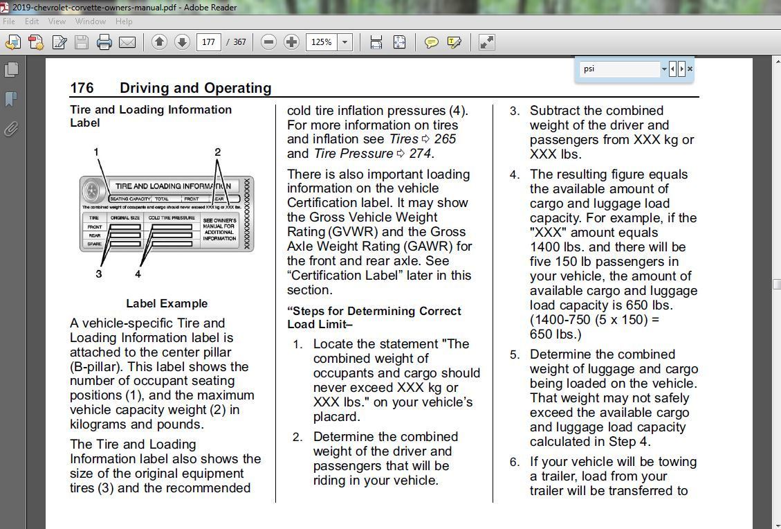

Ummmm the cold PSI is what you set and the cold PSI is 30 PSI.
