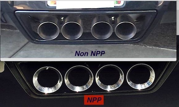

There are two sets of valves, one set is the afm and it is hard to see but it is in front of the axles. The npp valves are at the muffler and can be seen just behind the exhaust tips. The npp tips are flaired the non npp are not.

no need to remove , you can see the NPP valves from the back just by bending down and looking at the outboard pipes, the actuators are mounted right on the pipe just behind the trumpets
Plus as the post above states , the NPP trumpets are much bigger than the non NPP

I have the NPP...mine looks like the bottom pic from 2000FRCZ19....thanks to the both of you for your help! Dave once again...you have legit point! I'll try this...I have mine set to track for the exhaust setting and I do hear it go in and out frequently regardless of my setting...be back in touch after I try this! Won't be today...its raining here in Gainesville...was wondering about the mild to wild thing too...now I understand what it does...may just opt for it.
