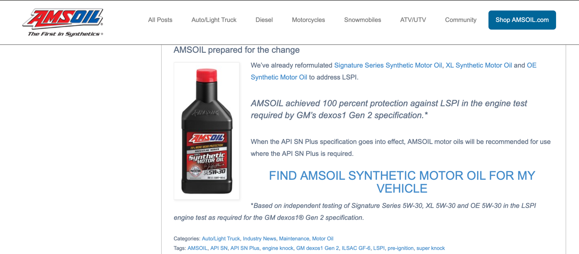

Originally Posted by rjacobs
The signature 0w40 is not listed as even a Dexos1 compatible oil, let alone a dexos2 compatible oil.
I'm not saying it wouldn't work, but I wouldn't run it. I would run the signature 5w30 before that since its at least listed as a dexos1 gen 2 compatible oil.
Dexos2 is low saps oil i.e. low ash. It also has to meet a spec for lspi(low speed pre ignition). I'm guessing the signature 0w40 either hasn't been tested for these or didn't pass them. Call the amsoil tech line, they are pretty open with discussing those things...
The only Amsoil I personally will run in my 19 z06 will be the 5w40 euro spec improved oil... It's basically a low saps signature series that meets the dexos 2 standard.

Originally Posted by HotRodWebb
If you are going to attempt to dispute what I say, at least reference the proper product...
The other poster asked about Signature Series 0w40... You post a screen shot talking about 5w30... which meets the Dexos 1 Gen 2 spec(as I already referenced in my post you quoted)... the 0w40 is not listed as even meeting that spec, let alone Dexos 2.
AND
Dexos 1 Gen 2 is NOT Dexos 2... They are different.
