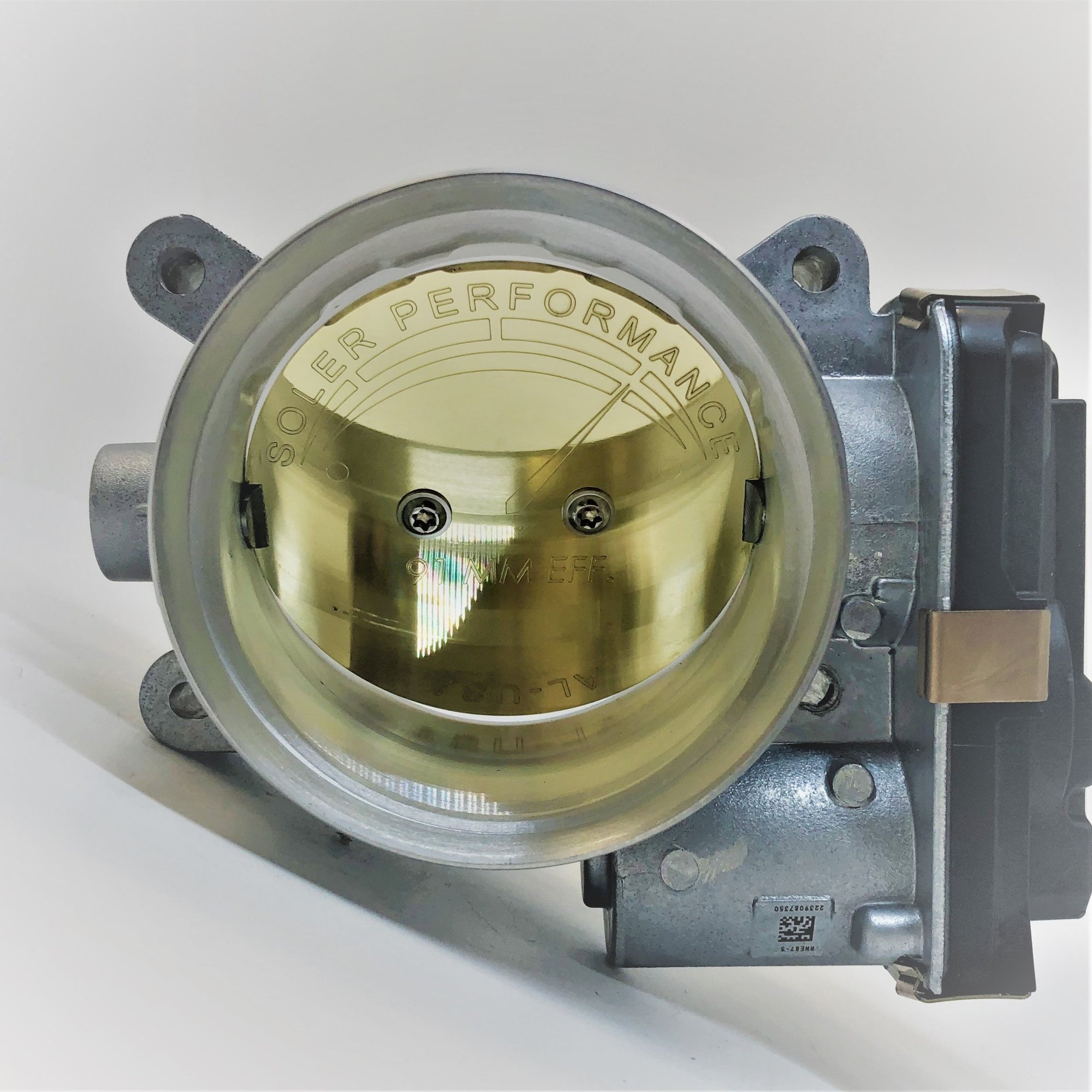

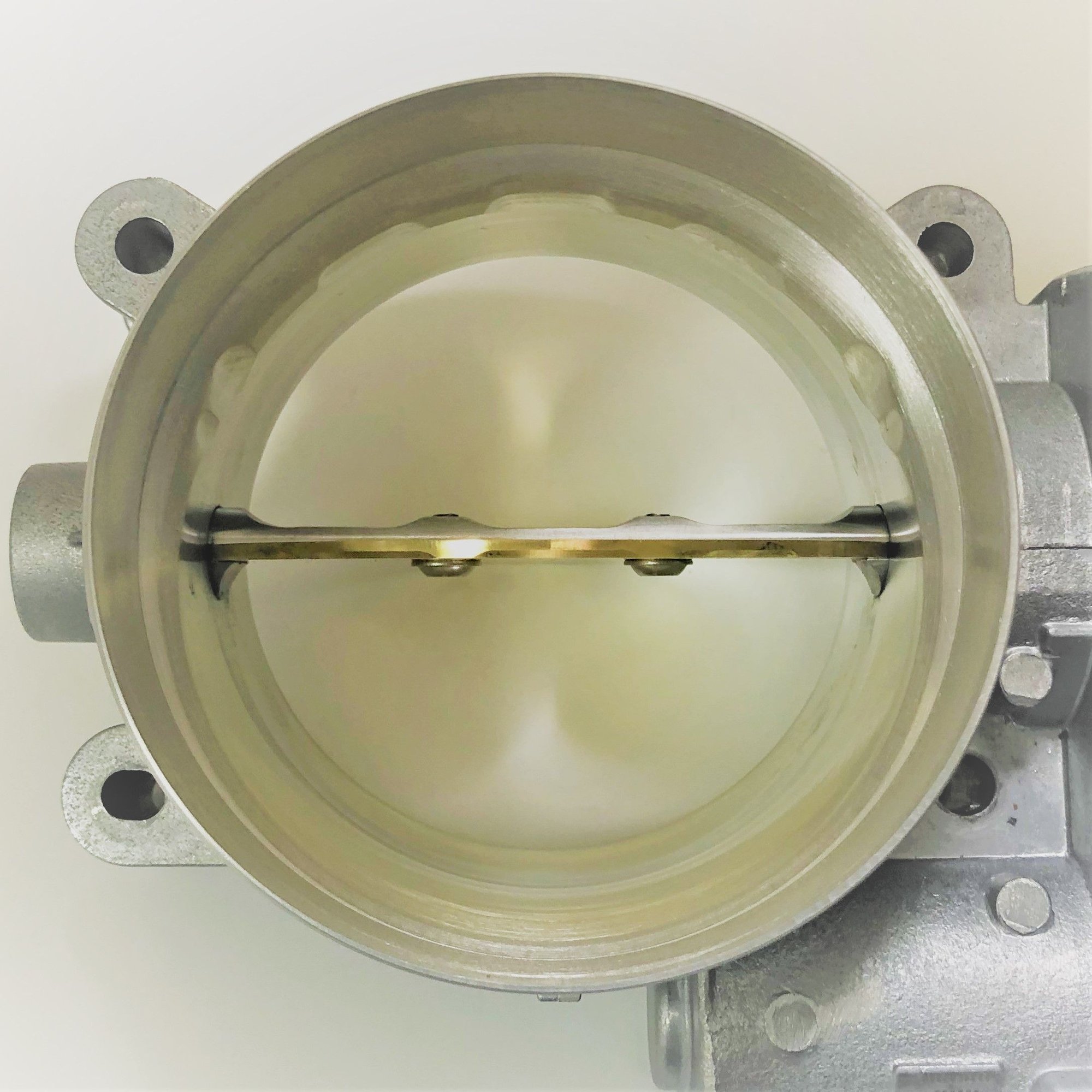

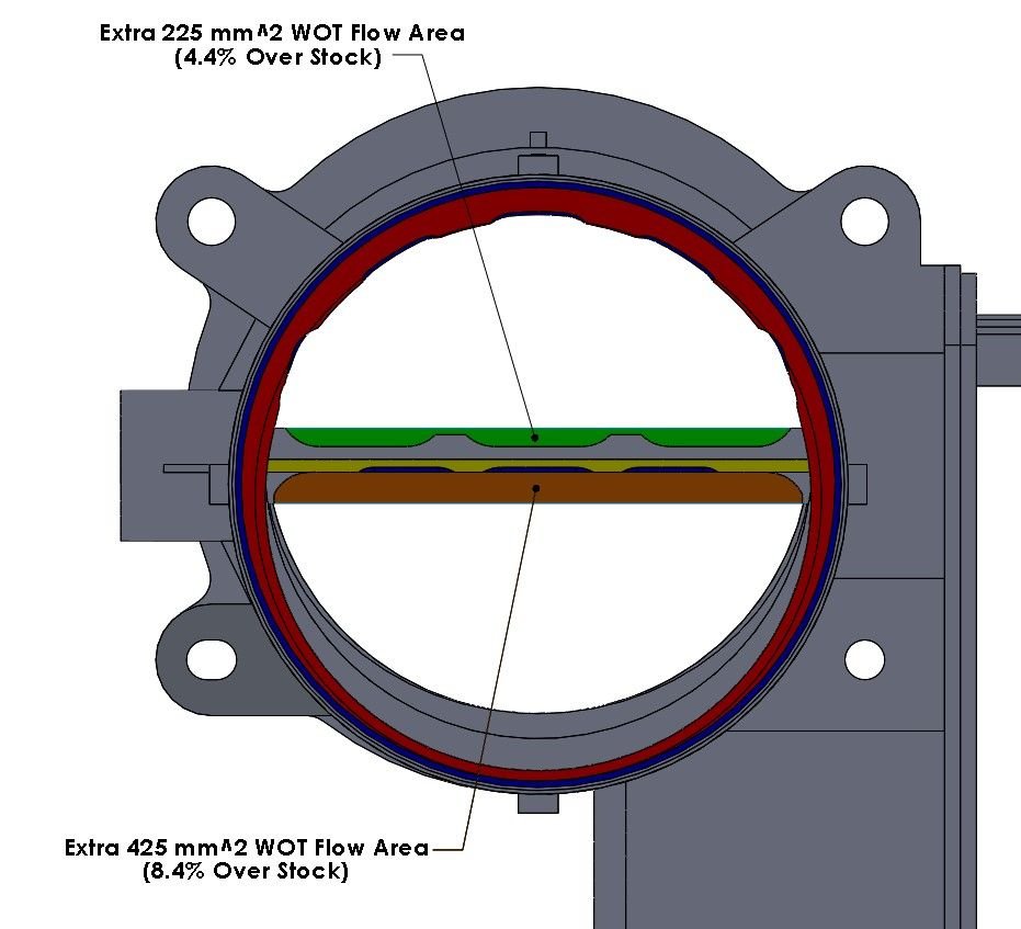

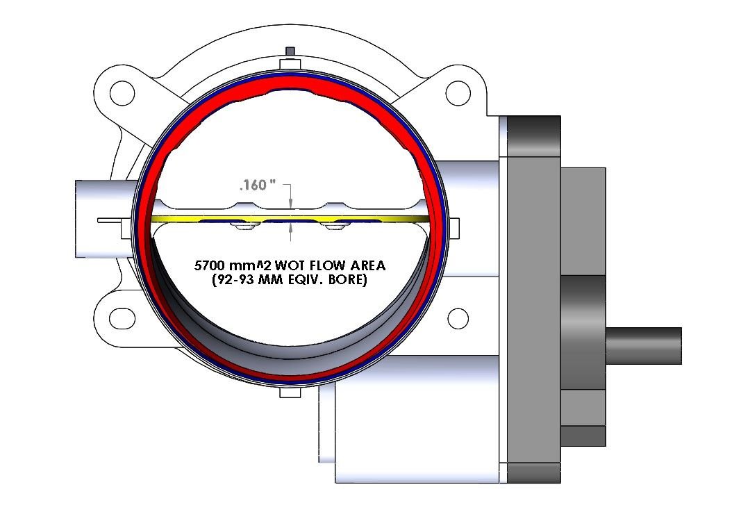

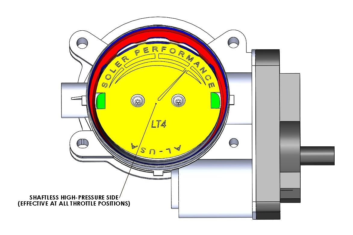

Or to be exact, latest improvements. We do not change versions or part numbers as long as they are interchangeable and meet the minimum performance requirements we advertise, neither increase price for additional features that are fairly simple to manufacture.
But, some of you have been asking us lately about how our latest parts compare to the competition in some aspects. The most common question is about flow area at WOT. Here is the answer. Please note that we advertise a bare minimum of 91mm of effective flow area (5500 mm^2) for a WOT flow of at least 1100 CFM @ 20.4" H2O pressure differential. The parts we provide always exceed those numbers and they are actually closer to the numbers below and that goes well with one of our mottoes over here, underpromise and overdeliver.
In summary, throttle control is all we do and our TB's are like no other, when you buy from us you are getting the most original and best-performing throttle bodies in the market, as measured by popular vote, area, flow, thickness, response, etc. Buy with confidence, we are always ahead of the curve, improving our products, competing with ourselves, and you always get the latest and greatest at the moment. Add to that, better prices, a full range of choices, a complete package/solution, money-back and long term warranties, and we top it all off with the very best customer service you'll find.

What is the significant difference from your prior model and the new version?? Purchase mine in Jan but due to the weather in the north have not installed it?

Thanks, Fred. See area in green below, that is it, and it only works/shows at WOT. If you are into racing, it will give you that last drop you can squeeze out of this TB. Otherwise, you are fine. We can retrofit if you'd like to have it. You have the orange area (shaftless high-pressure side) unique of our parts and effective at all throttle positions, you also have everything else you see.
