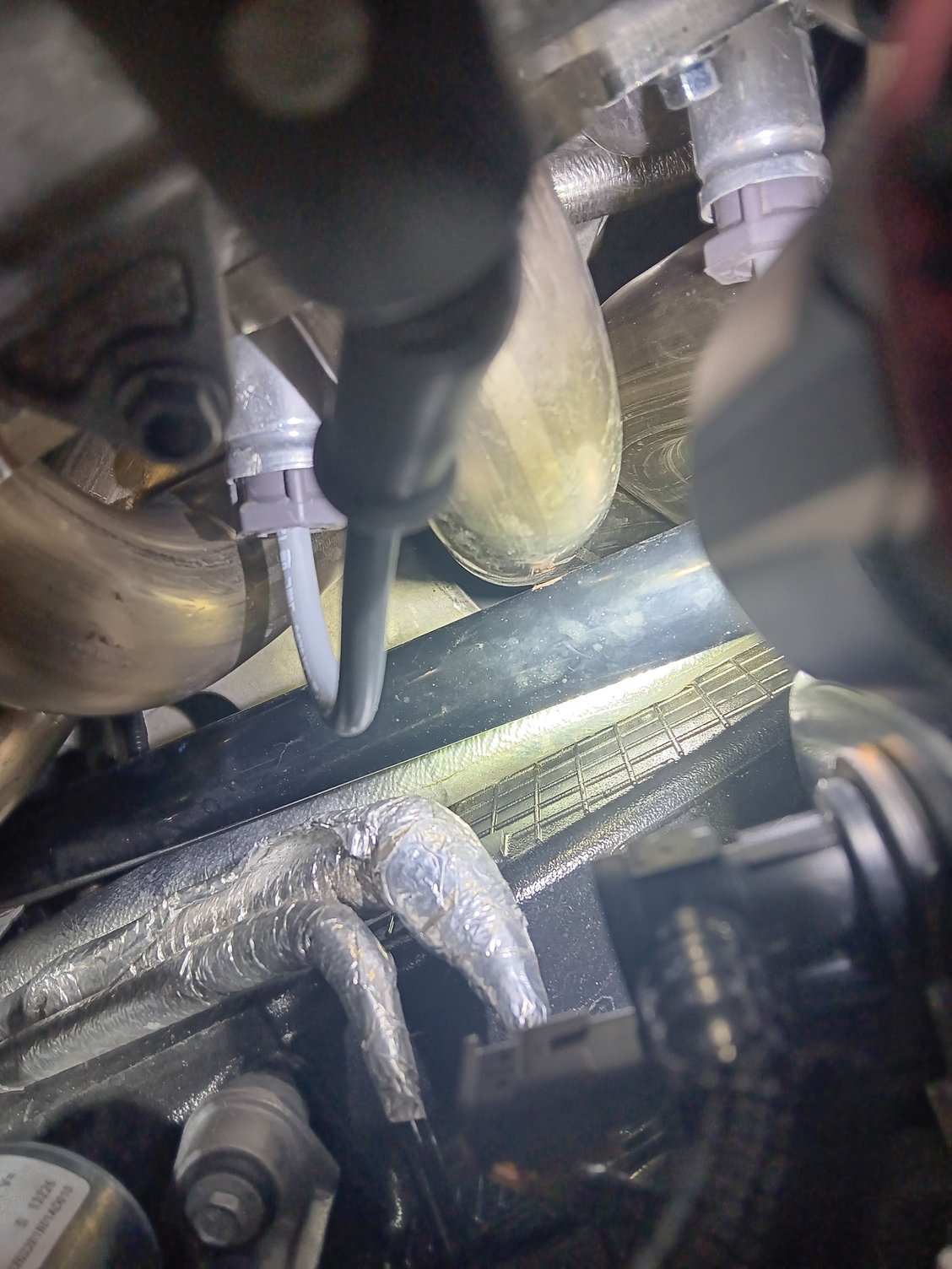

OK I got everything installed the car sounds amazing, I didnt have to use a pry bar everything fell in place, but I have a small rattle in the rear, how do I adjust the pipes, with the hanger?? Also I did not get a service light on. I am running no cats but have both front and rear O2's on.
And I also noticed that a small rub on the steering shaft driver side?

Posts: 8,673
Likes: 2,728
From: Atlanta GA
Sometimes with 2 inch headers you might need to mark the header and hit it with a persuader ( a big *** hammer) . One reasons why I did not go with that size . I know you have done a lot of work already but ... no way would I leave that rubbing the steering shaft
Dave

From: Port St Lucie Florida
Dave
No, I am still glad I got the 2inch header, Im thinkin of a way
to slightly bend it, its just a slight rub.
