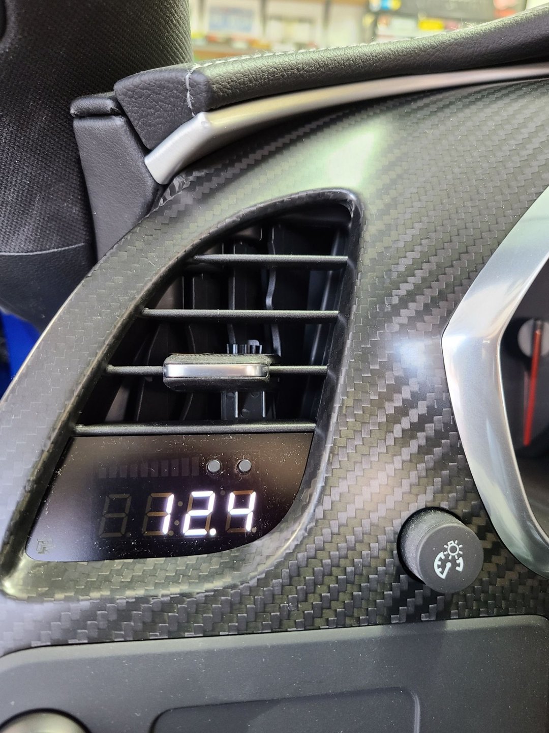

I use a P3 gauge in the Z06 and a Banks iDash in my ZL1.

i like how the p3 mounts in the air vent, i was looking at this for ease of install

The P3 is nice. You do have to wire in a converter to convert the frequency output by the flex sensor to a 0-5V signal that the P3 can understand. It's pretty easy to do.

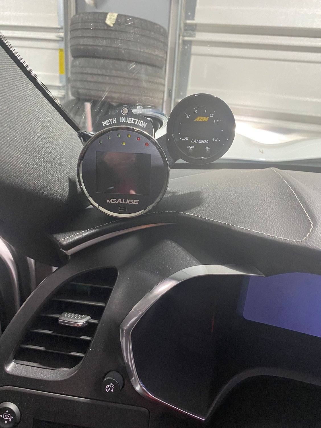

I’m kinda **** though so I always like to see where I’m at with my E. I use an Ngauge to monitor my engine stats along with my E content. And of course in my Meth is always hitting pressure. Gauges getting harder to come by though but out there.

Gary those gauges look good.

Thx veteran!

I really liked the vent one, didn't want to pull dash apart though

It's actually not that bad of a job. You don't have to take the whole cluster bezel out. You can just pop the left side loose.
