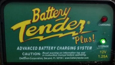

Get a Deltran Battery Tender !!! I have been using them since my first 1987 C4 and have had batteries last 10 years !!
I agree and have had BT+ for 17 years that has been used on numerous cars, motorcycles, and lawn tractors I've owned in that time frame. It has survived many indignities, including being run over by my Harley more than once, and still serves as the full-time maintainer for my truck. I also had a BT Jr., which I stupidly let go with my last motorcycle, and a solar BT that I use on my ZTR mower in a shed that has no AC power. OTOH, if you already have a CTek, which in my case was part of my GS package, you can fix the quirky lighter setup with the easy mod mentioned earlier. If I didn't have a maintainer and wanted to buy one I'd probably go with the BT Jr., which is economical and quite up to the task.
