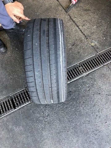

16,000 miles and this is what I got from the factory alignment. What is the correct camber for a street alignment? Thanks in advance.

There is huge range of adjustment for alignment measurements on these cars.
Best option would be to take to a shop that does alignments on performance cars and request "Best Tire Wear" alignment settings.
I always consult with my Corvette customers about how they would like their alignment done before making adjustments.
That tire wear looks like normal negative camber on top of some negative toe scrub.

Absolute maximum tire mileage will come from zero camber and close to zero toe. I do zero camber on our street cars and more camber on sporty cars. Zero camber will give less than maximum cornering power but I feel that, especially a normally driven street car has plenty of cornering power for it's intended use. I include your Corvette in there because of how you drive it....normally. We have a Honda Pilot which I haven't done anything too yet as it is only 6 months old. But it will get zero when I do it. My wife has a 15 Mustang GT and it is close to zero camber. My 19 Stingray is my autocross car so it has -3 front and -2 rear camber.

Your car has negative camber. When camber is adjusted it will change rear caster. Alignment Machines Can not measure or display rear caster. So find a shop that has the rear caster tool.

There is not enough adjustment in the stock rear toe rods to get your camber down to zero and still have zero toe. I replaced the rods on my 2019 GS with Granatelli adjustable rods and got the camber down from -1.0 to - .05 with zero toe. I am getting much better wear out of the second set of PSS's and still don't notice any handling difference in street driving or spirited twisty driving. It's a convertible, so no racing.

Did you have excessive toe in? If the rear caster wasn't measured and then set to 0.0 that might happen since you moved the camber to an extreme position. When I was setting the DSC track alignment that called for rear camber of -1.7 degrees and rear caster of plus 0.7 degrees I found the rear toe links didn't have sufficient adjustment to reach 0 toe as well. The least I could get was about -.5 mm of toe out. When the rear caster was changed to the GM 0.0 recommendation the toe links had a sufficient adjustment to reach 0 toe and a little toe in.
