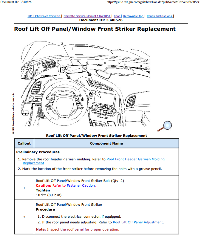

Originally Posted by Travlee
i found it one day, will see if i can find it again. off the top of my head, mirror removal, sun visors, that little strip of headliner. @96GS#007 has been really helpful at posting info from alldata
i got lazy and took mine to corvette world to have them do it
Takes more time to remove the trim than anything. After you install the new strikers, be sure you have the roof adjusted before you reinstall all the trim.
The mirror twists off. There are two or three screws that secure each sun visor. The actual piece of trim just snaps in place. Using a trim tool and carefully selecting where to pry will help you avoid breaking clips. Search YouTube for C7 Windshield Replacement and the longer videos ones will show the trim being removed which I think you'll find helpful.
