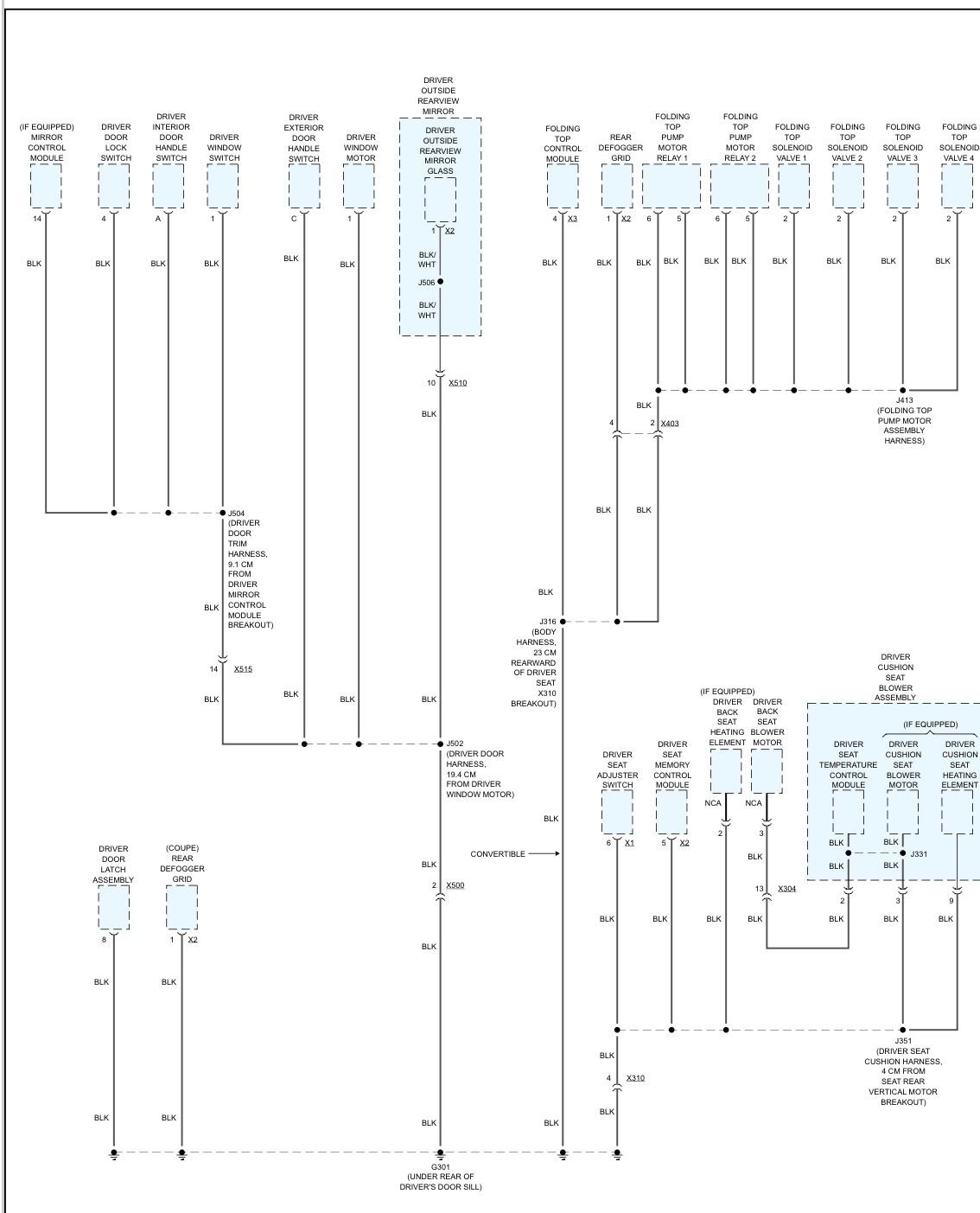

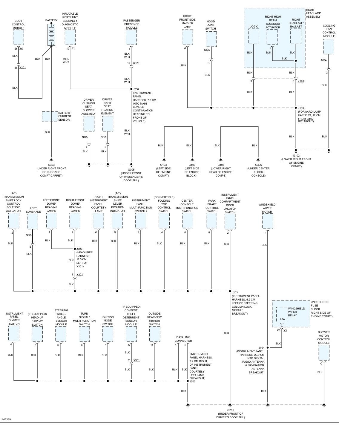

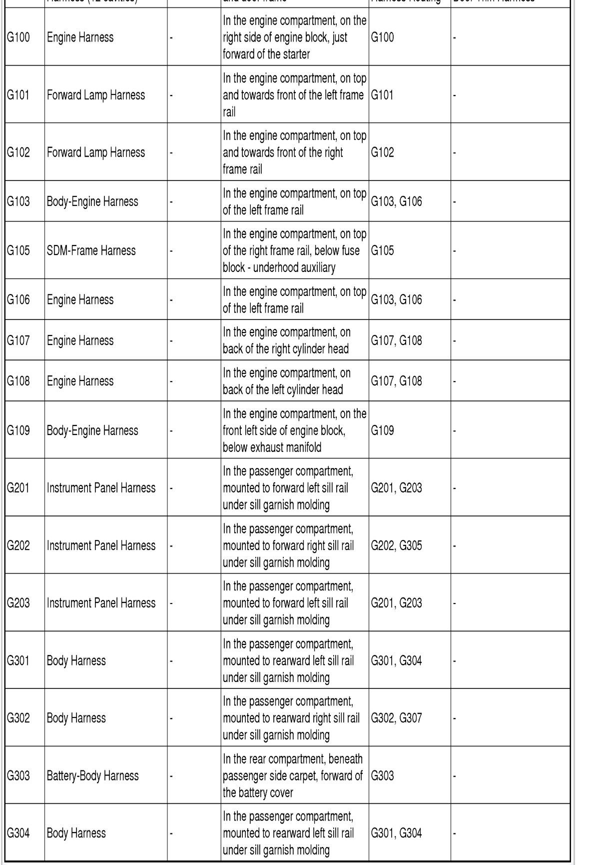

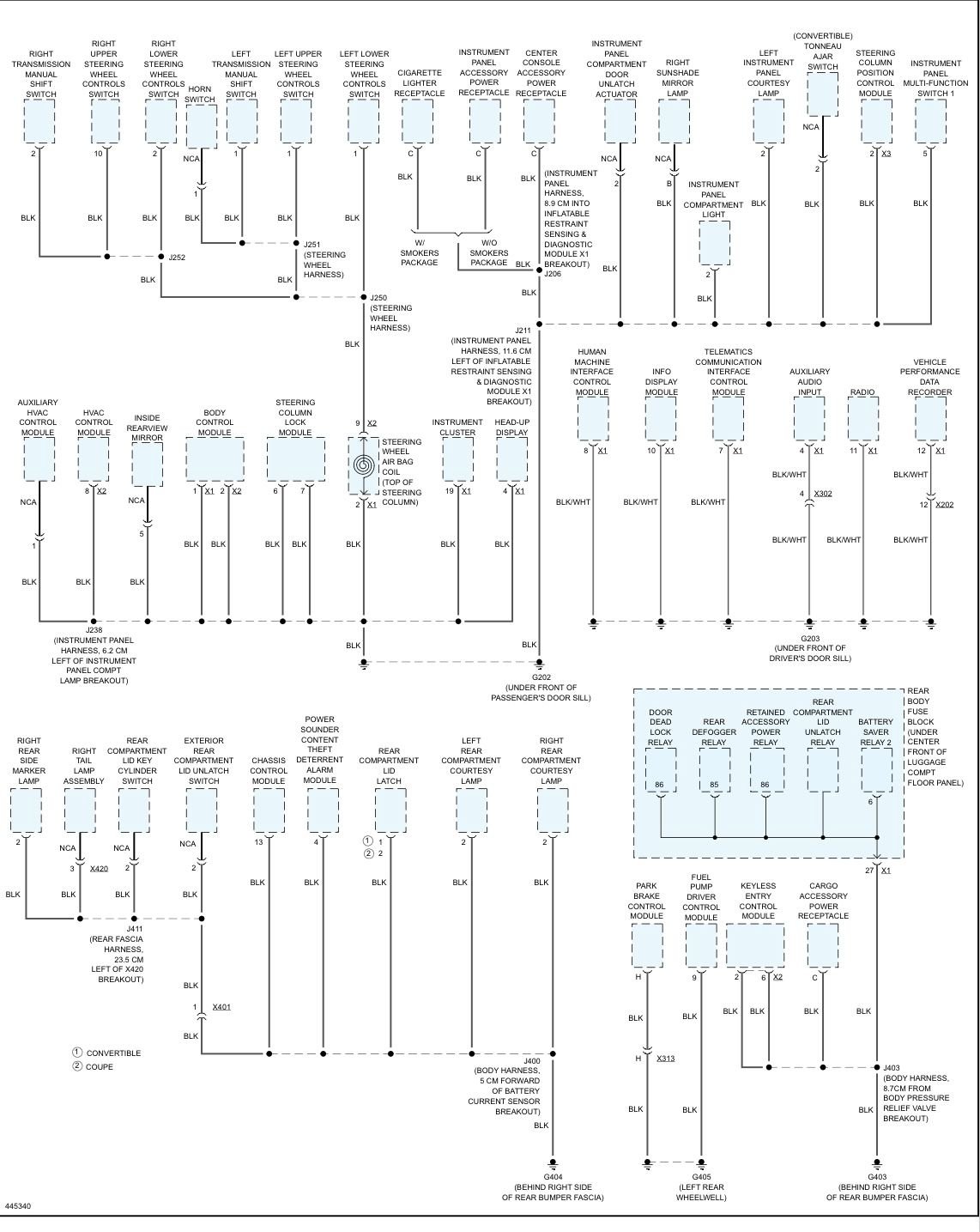

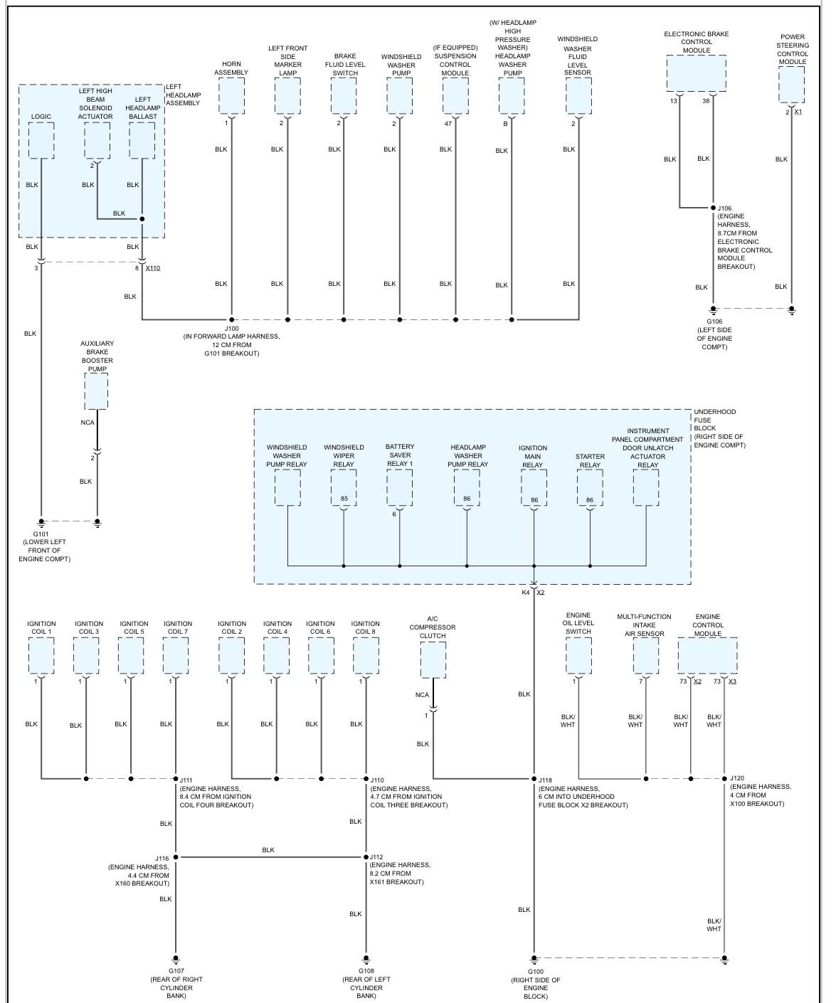

Originally Posted by C5 Diag
Being that you saw O2 sensors “low” or a lean condition fuel trims will go positive…when O2 voltages “high” fuel trims will go negative…seeing both of these may be that stuck purge valve…a rich condition then a lean condition…disconnecting the battery will erase those DTC’s.

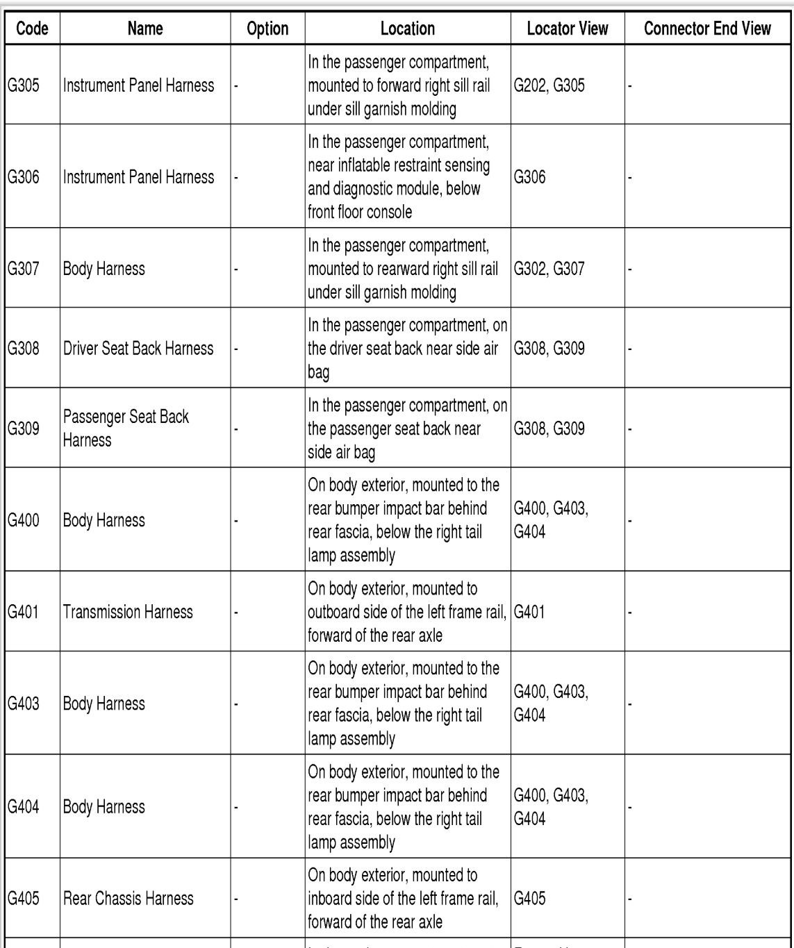

UPDATE: I haven't been able to get with my friend for a while other than by phone, but he's still working on the problem. Got the purge valve changed out, which seemed to work for a while, but the symptoms came back. So I'm leaning towards an electrical problem, and I always lean towards dirty/bad grounds first. Problem is, I can't find a diagram showing the ground locations for a C7. C6 and C5 out my ears, but no C7. Does anyone have a diagram of the ground locations for a 2016 C7 coupe?
Thanks for all the help, and have a good one,
Mike
Old Jun 7, 2023 | 03:45 PM
C5 Diag's Avatar
C5 Diag
Moderator, Tech Contributor
Posts: 15,621
Likes: 4,069
From: Cape Coral, Florida
What do your upstream O2 sensors look like on a scan tool ??…if they are high the fuel trims will be negative and will pull fuel…doubtful BOTH O2 sensors are bad…did you look at the MAP and MAF sensor data Pids ??…if MAP sensor is skewed you will have fuel scheduling issues !!…DON’T think it’s a ground issue…grounds don’t mess with the fuel scheduling but this is from a 14 if you want them.
To Need help figuring out a friend's 2016 engine problem
Old Jun 7, 2023 | 03:48 PM
VetteDrmr's Avatar
VetteDrmr
Joined: Dec 2000
Posts: 9,913
Likes: 1,868
From: Hot Springs AR
We live about an hour apart; so I'll get my baby scan tool out there this weekend to get the data, and let you know. In the mean time (just for prosperity), do you know of a diagram showing the ground locations for the C7? IDK that there's a problem there, but my C5 experience with ground locations and corrosion always makes me check those out.
Thanks for the help, and have a good one,
Mike
Old Jun 7, 2023 | 03:55 PM
C5 Diag's Avatar
C5 Diag
Posts: 15,621
Likes: 4,069
Old Jun 7, 2023 | 04:25 PM
VetteDrmr's Avatar
VetteDrmr
Joined: Dec 2000
Posts: 9,913
Likes: 1,868
Fantastic, THANKS!
