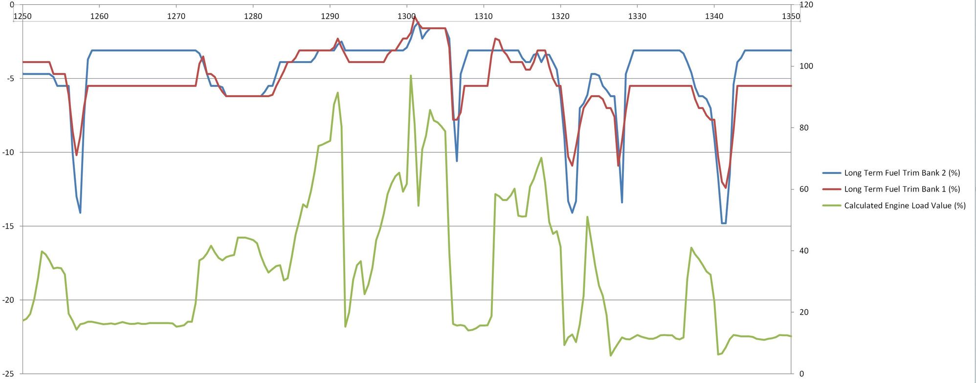

I replaced the battery with a new one my friend had on the shelf for around 6 months (just never got around to installing it). Battery was totally discharged, so it took about 12 hours on my 8 amp charger and 36 hours on my battery tender. This morning the BT said it was fully charged, so I took it for another test drive. Checked the codes after startup, the O2 codes (sensor and heater) were gone. The only one left was a permanent code for the fuel pump controller, which I believe can only be reset by the PCM itself.
I tried to find every driving scenario I could, from normal city/neighborhood driving, highway, low power starts up an incline, hard accels, lugging up a slight incline in 8th gear at 50 mph, etc. No problems, and at the end of the drive cycle the fuel pump controller code had reset itself. Success!!!
The long term fuel trims are still always running negative, but closer to 0 than before.
