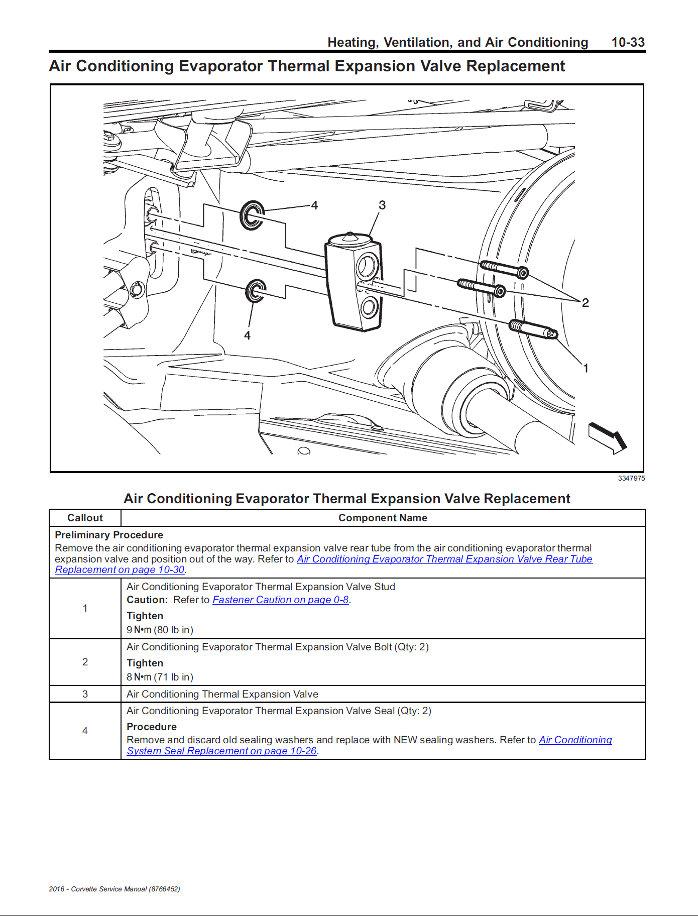

Drier is a desiccant bag located inside the condenser can be unscrewed and replaced. Just looking at a line drawing but expansion valve appears to be located on firewall behind engine and looks like it might be quite involved to replace.

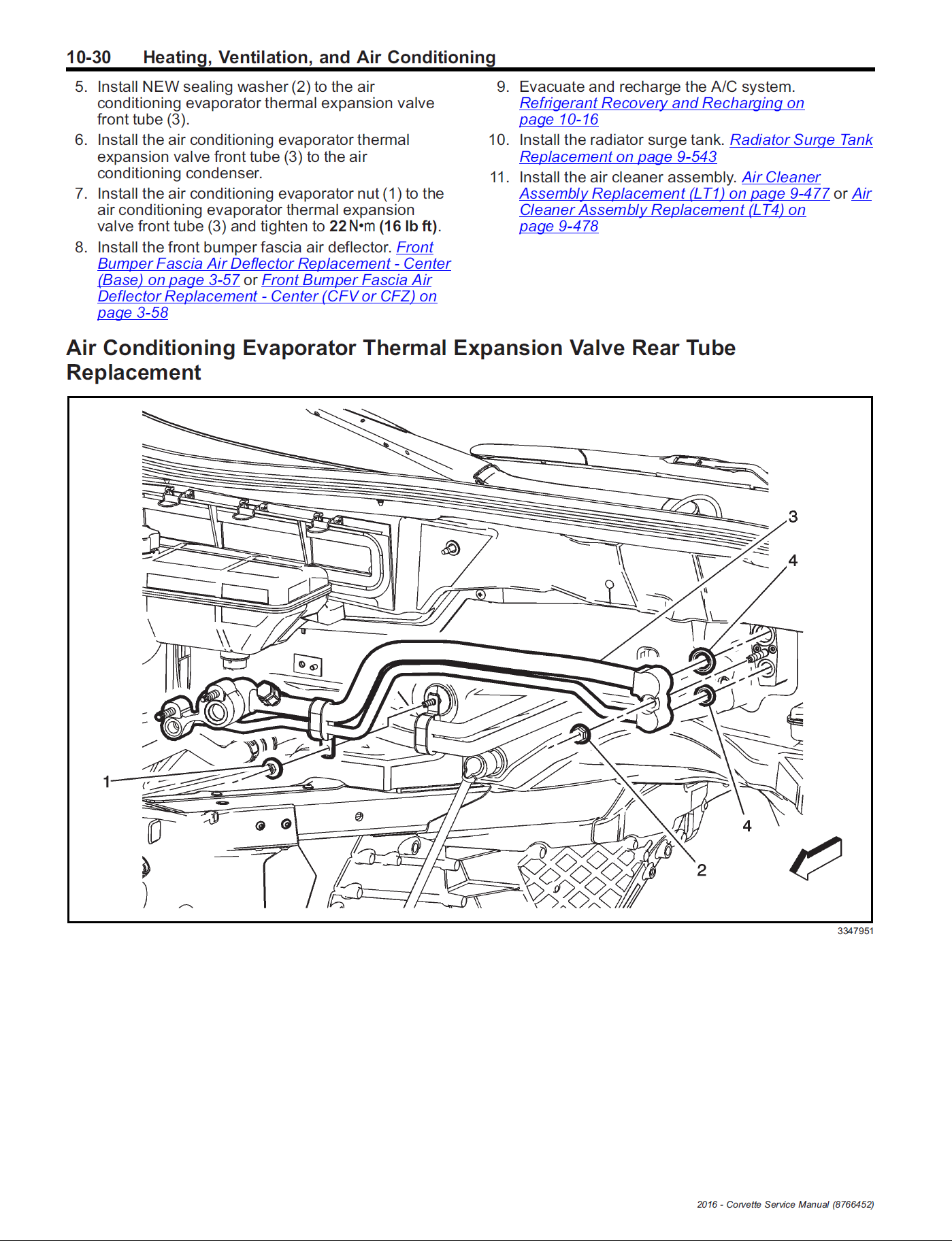

Hope these pages from the Service Manual help:
Bill
