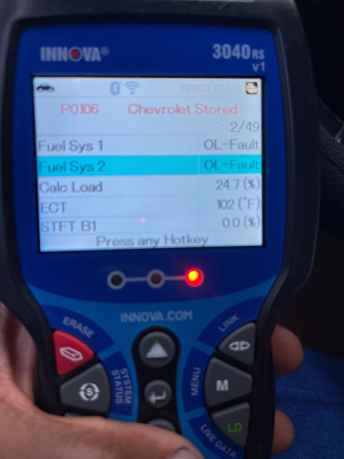

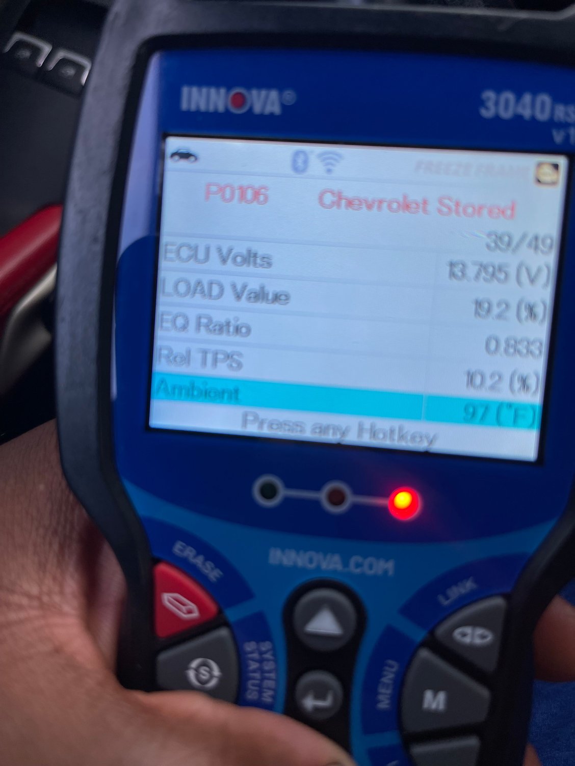

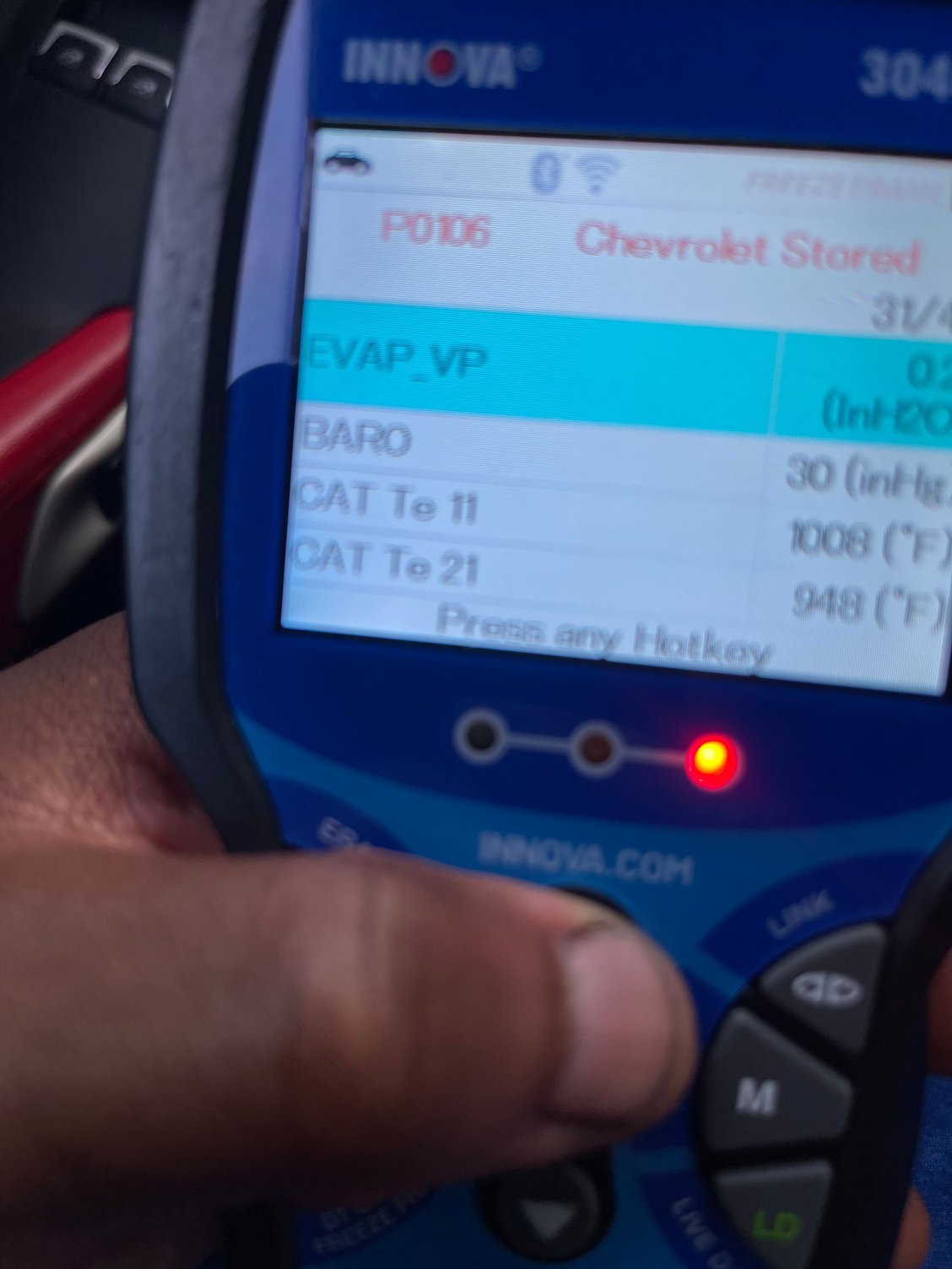

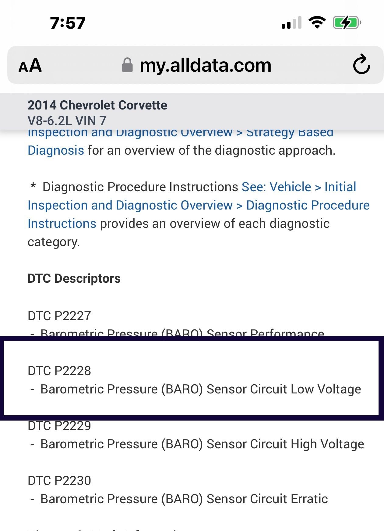

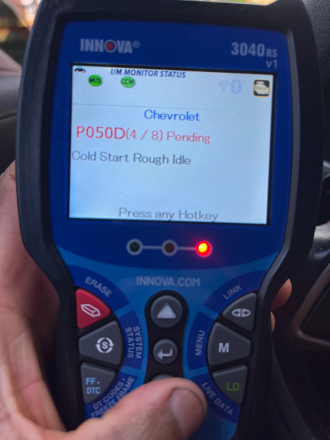

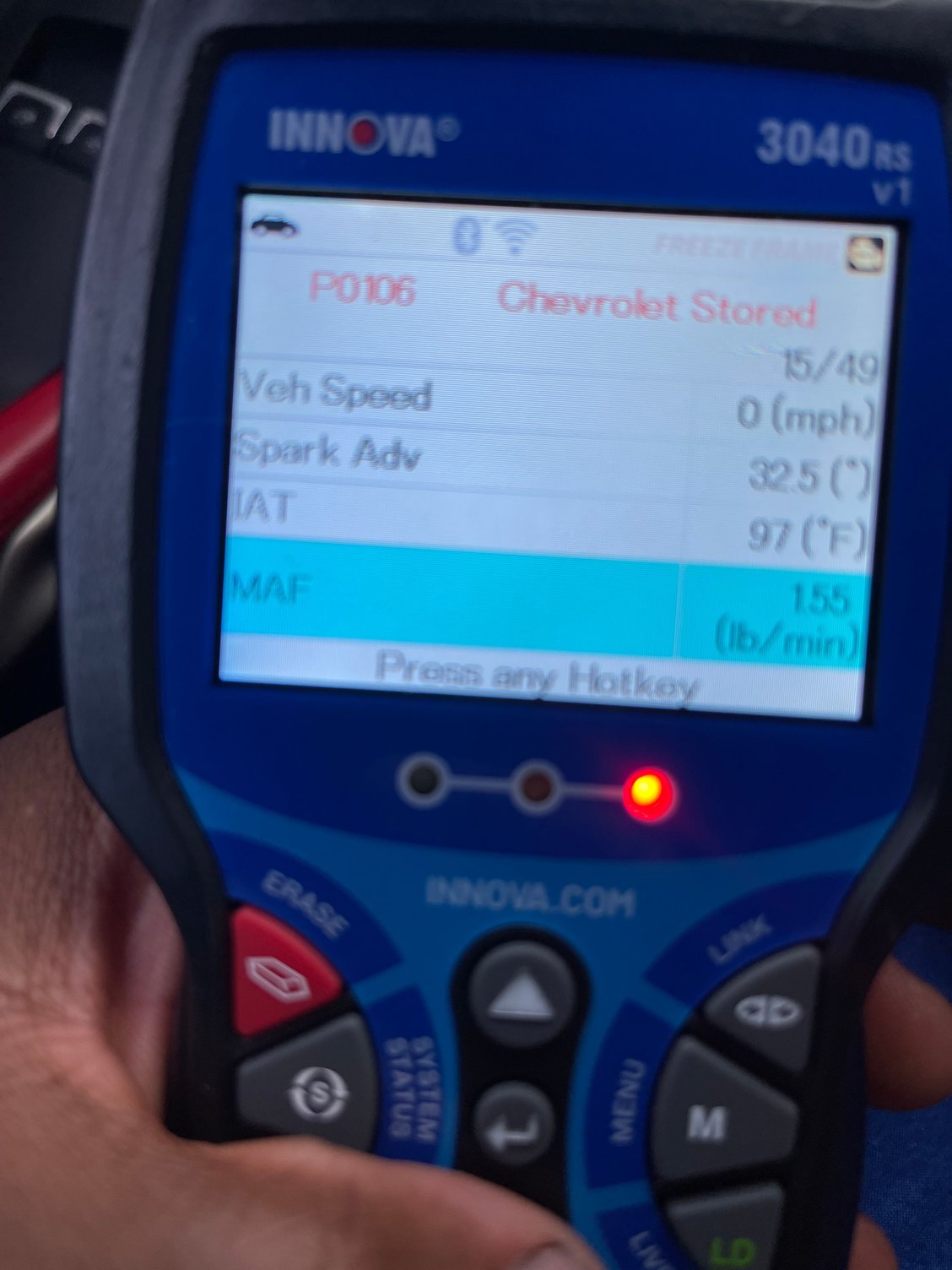

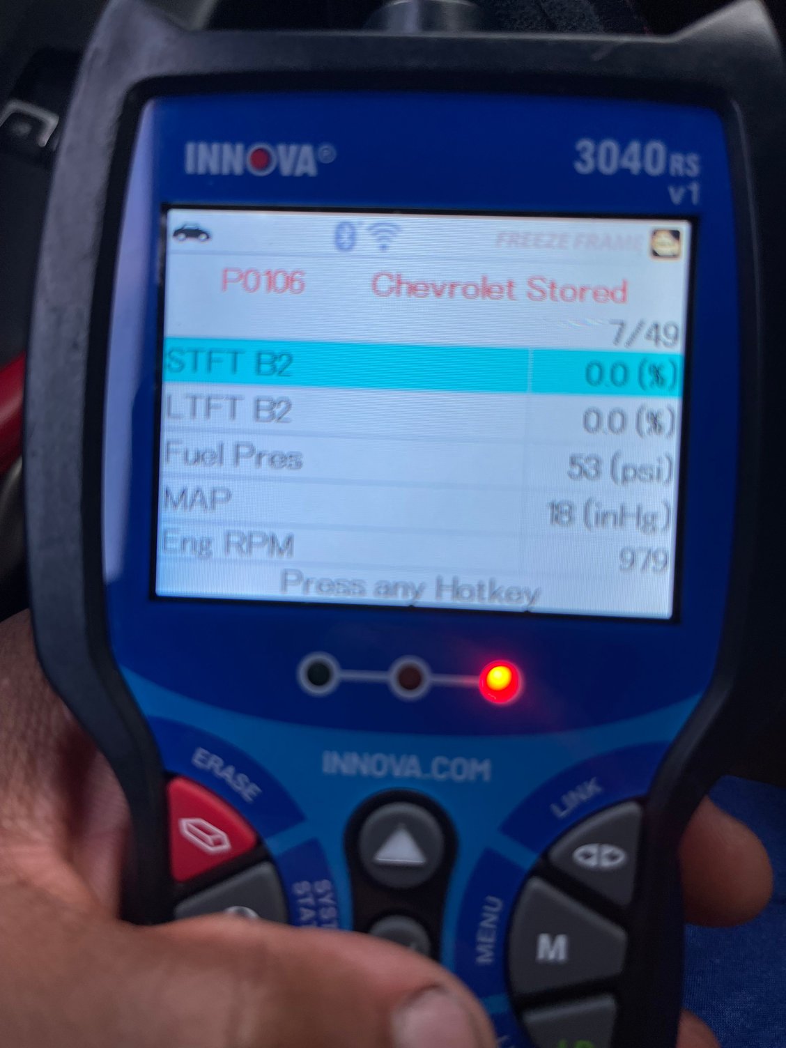

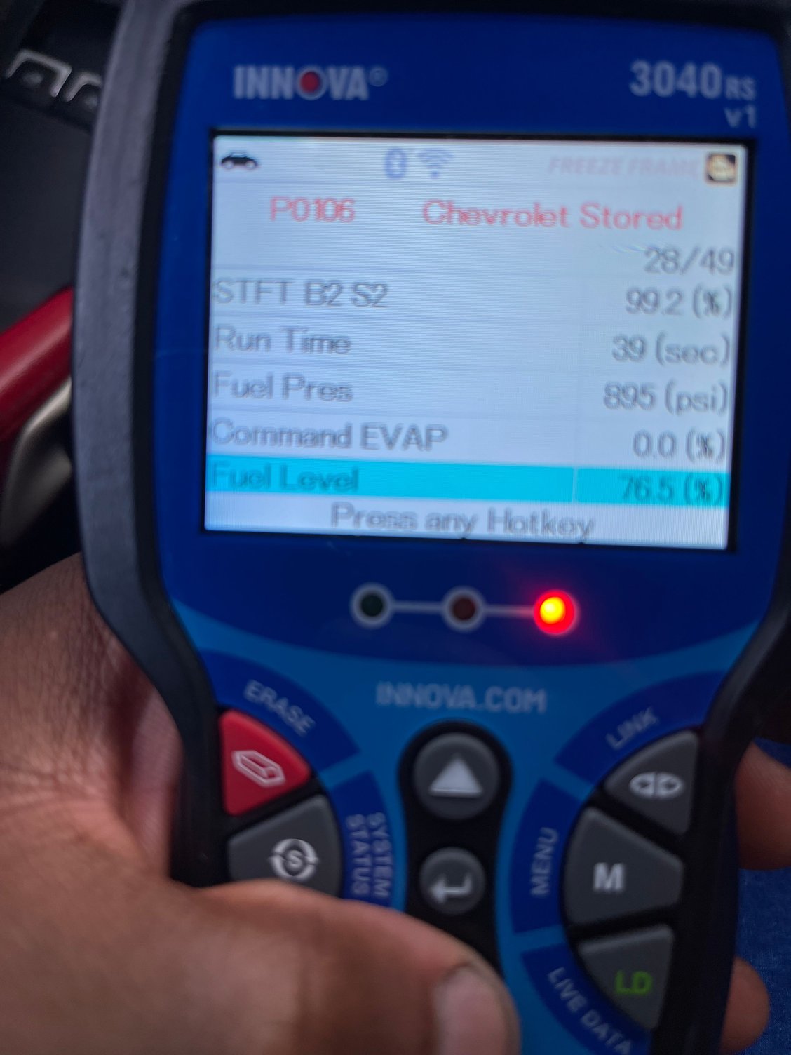

I do believe the sensor was aftermarket. However I was able to get hold of a better reader and I took some pictures of the codes and engine readings. with the same usual p0106/107, and 228. I was concerned if the ECU voltage was too low. could that be a problem?
I’d drive over to your local Chevy dealer and get yourself an OEM sensor and go from there.
