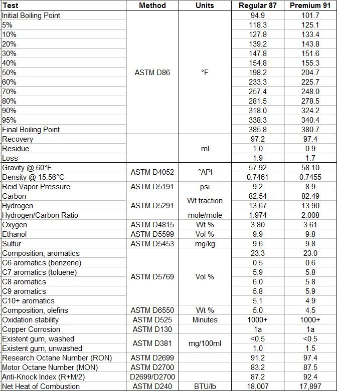

Originally Posted by kodpkd
yep.
NOPE!
The BTU/lb of energy of 91-93 premium is the same as regular 87. (within the margin of error) The heavy aromatic content is slightly different (same concentration) to get the higher octane value. Distillation, flame speed, burn rate, vaporization, etc... all practically the same.
