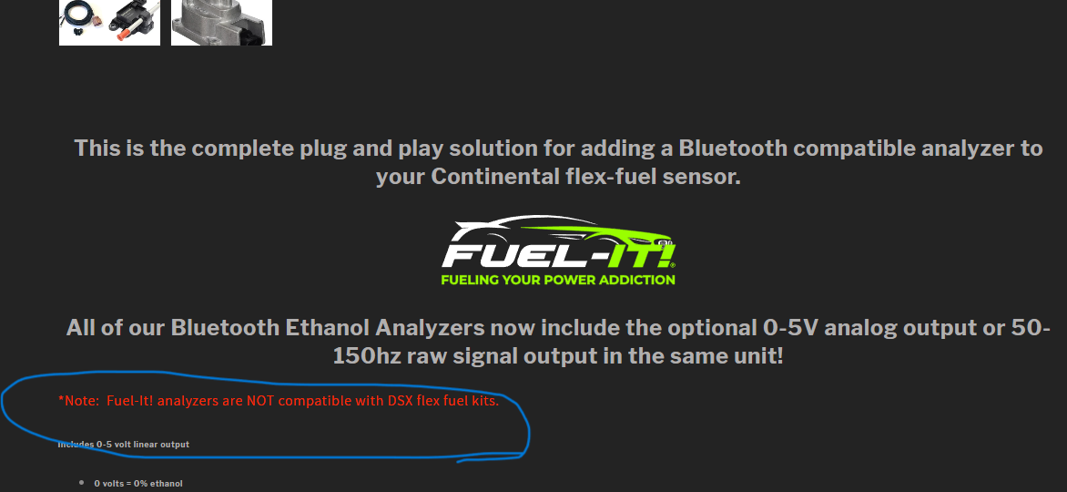

I came back to advise that the latest Fuel-It Blue Tooth module DOES NOT work with the DSX flex fuel sensor. Very weird.
An easy fix is probably to just create a tap somehow off of the flex fuel sensor and pass it around the blue tooth module to the ECU wire. This makes me think that Fuel-It, now owned by Burger Motorsports, did this on purpose. I wonder if they did that so you would buy your flex sensor from Burger instead. I thought DSX just used an OEM GM sensor. Burger now sells OEM GM Flex Fuel sensors with their kit. We might have to change our setup because the blue tooth module is very convenient.

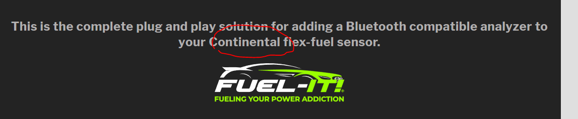

crewchief... go look at your dsx unit. i saw on the pic that you posted, it says it works with continental units.. i zoomed in on the pic of mine, and it appears to say continental

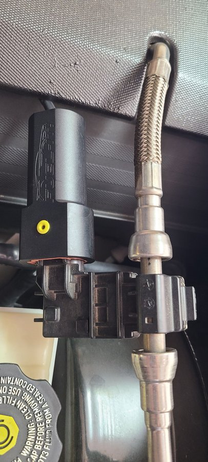

Mine is a continental sensor from DSX
To Fuel-It Blue Tooth module

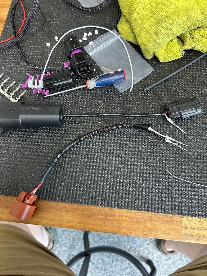

This is what I threw together a few minutes ago. Ninja's idea...Simply unpinned the white ECU wire from the Fuel-it plug and bypassed the analyzer. Haven't tested it yet, needed to get back to work for a few hours.

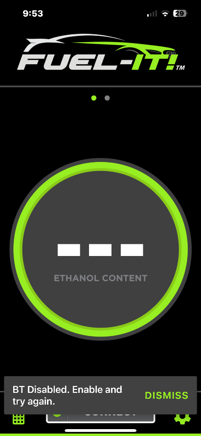

Well, that didnt work. I do have signal to the ECM. Still can not connect Bluetooth.
Old Aug 16, 2024 | 11:48 AM
  #40
Travlee's Avatar
Travlee
Posts: 16,092
Likes: 2,758
From: Frisco, TX
is bluetooth on the phone on?
