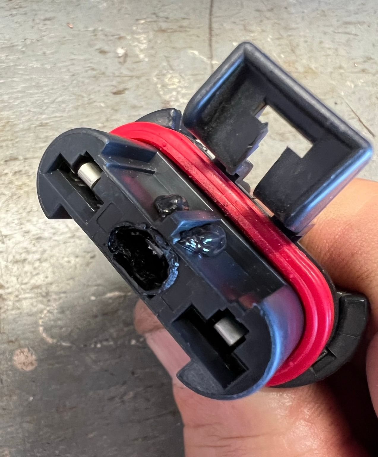

I would check the wiring first…this was found on a 2010 I worked on last year.
