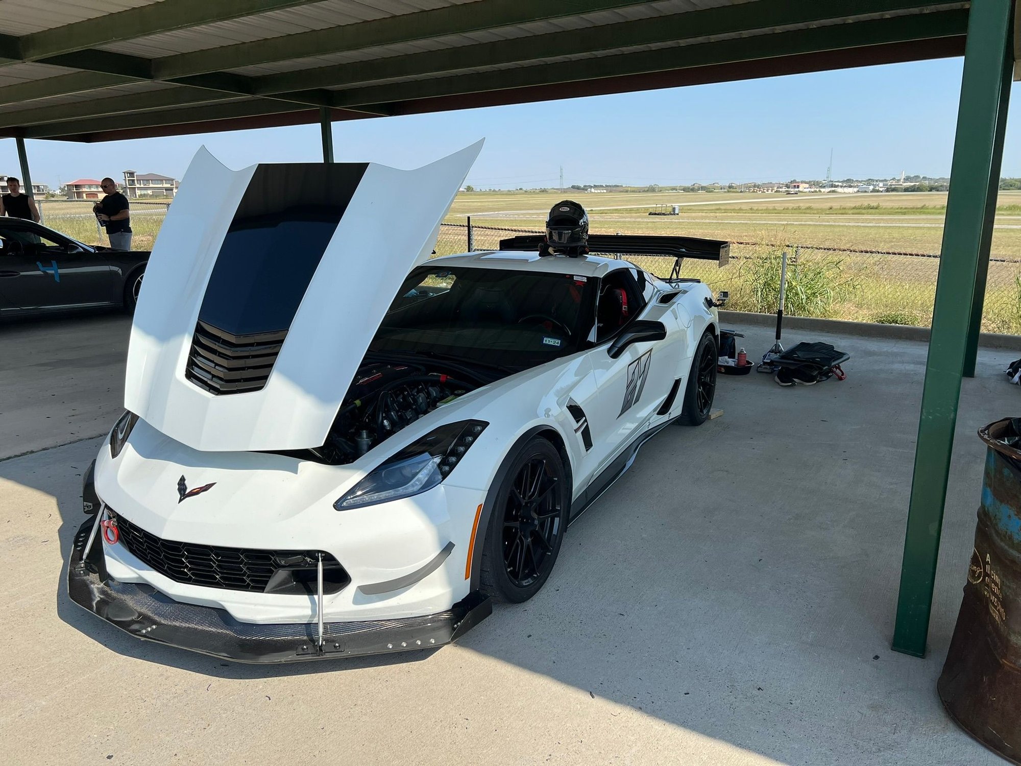

I have a 2017 grand sport with the 8sp auto. Bone stock powertrain just stage 3 aero upgraded wheels tires and brake pads and fluids. It’s a weekend toy and a track car. I do 5-10 track days a year. But I’m having some annoying issues:
while at the glen in 75 degree weather and while it never overheated it got very hot. Both oil and coolant were one line off red. This is in the setting of manually shifting because the a8 shift logic sucks on track. Oh, and for those that ask about skill level at the glen I run high 2 teens. Not exceptionally fast but I’m not a noob either.
issue two was at thunderbolt this past weekend (where I Was running 133s) and started to get engine protection, upshift when possible warnings. They would disappear when in auto after 10-15 seconds or in manual would start upshifting me directly. It happened every session, mostly around the condos and octopus. From reading this seems to be a potential oil starvation issue on wet sump base cars but my gs is a dry sump so why would that be happening? More importantly how do I fix it??
thank you all in advance for any thoughts and advice. Oh, and pic included just for fun
