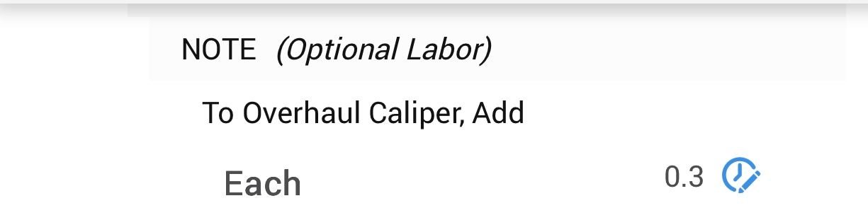

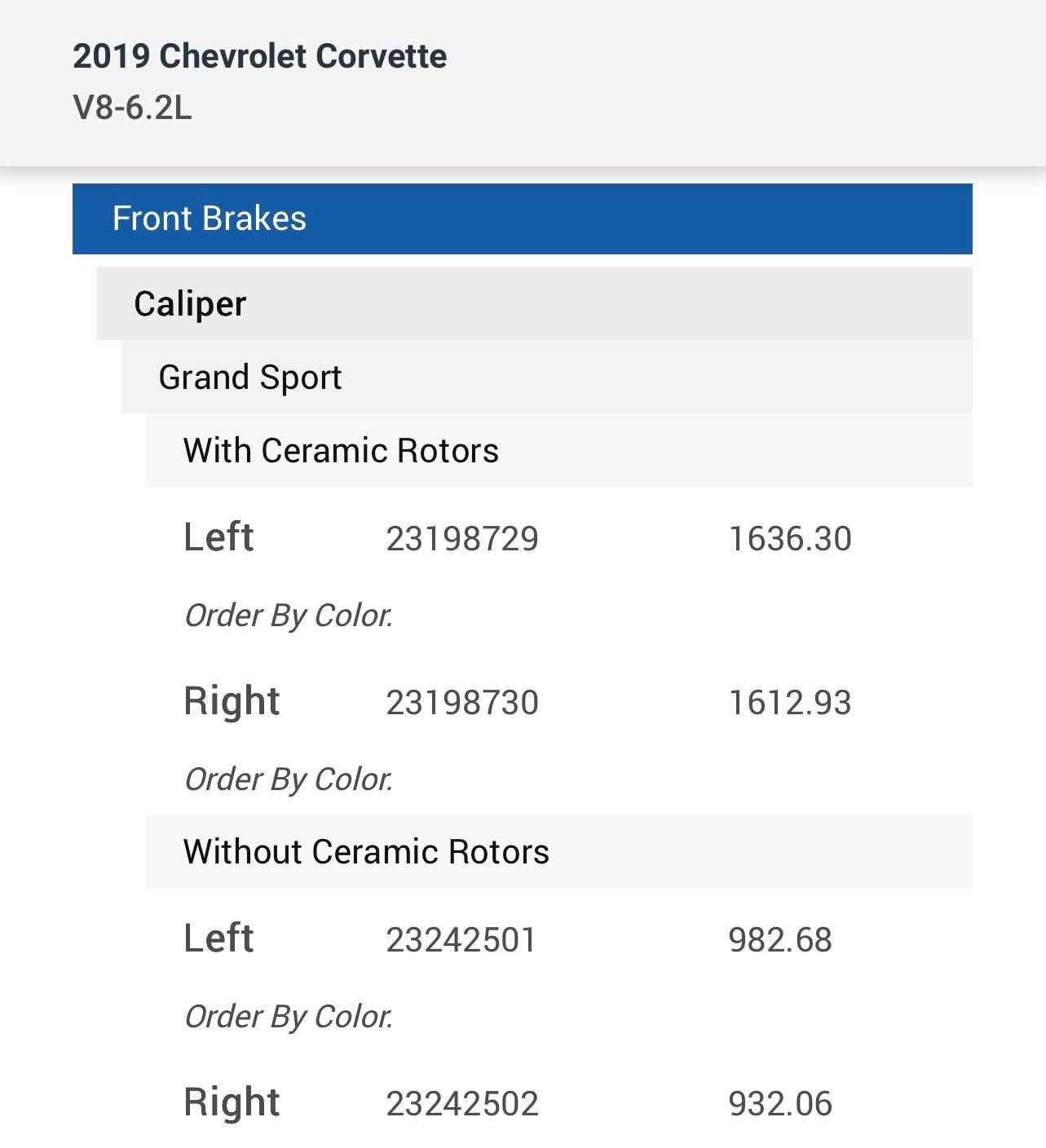

Did you ask the dealership why it needs to be replaced ??…repair is .3 hours of labor and the caliper cost is listed below whether you have ceramic rotors or not…at that price you can see why they want to replace.
