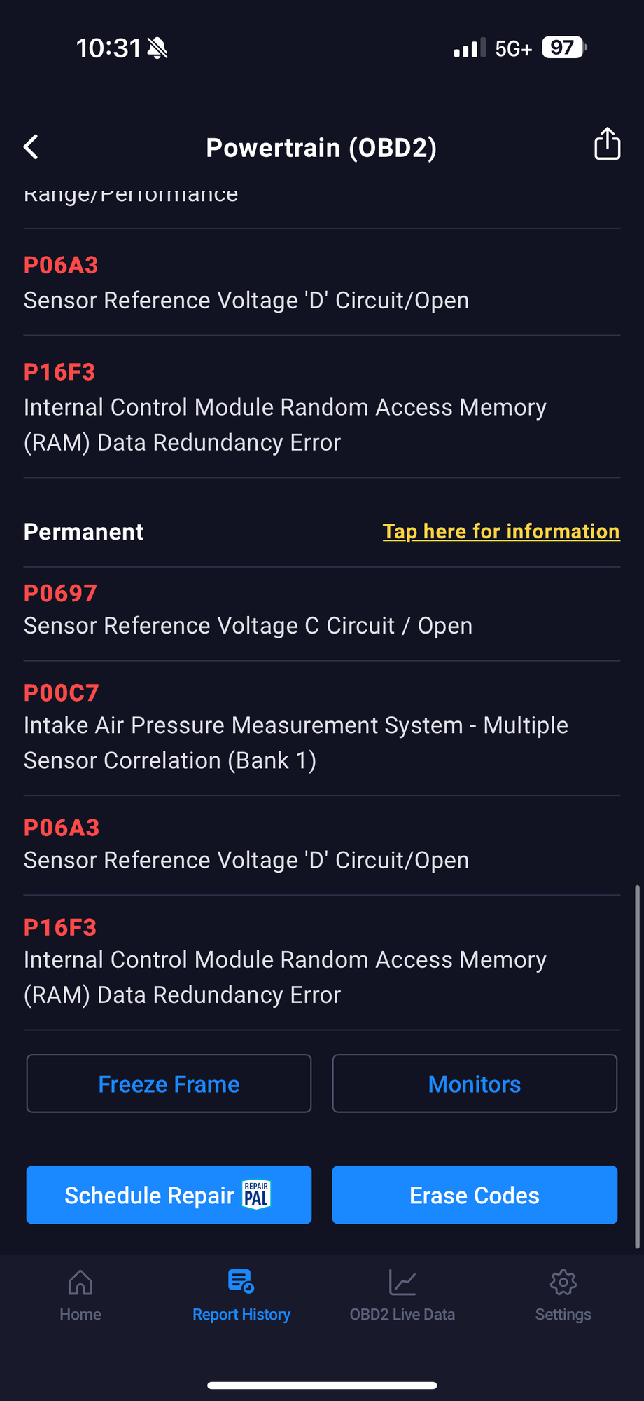

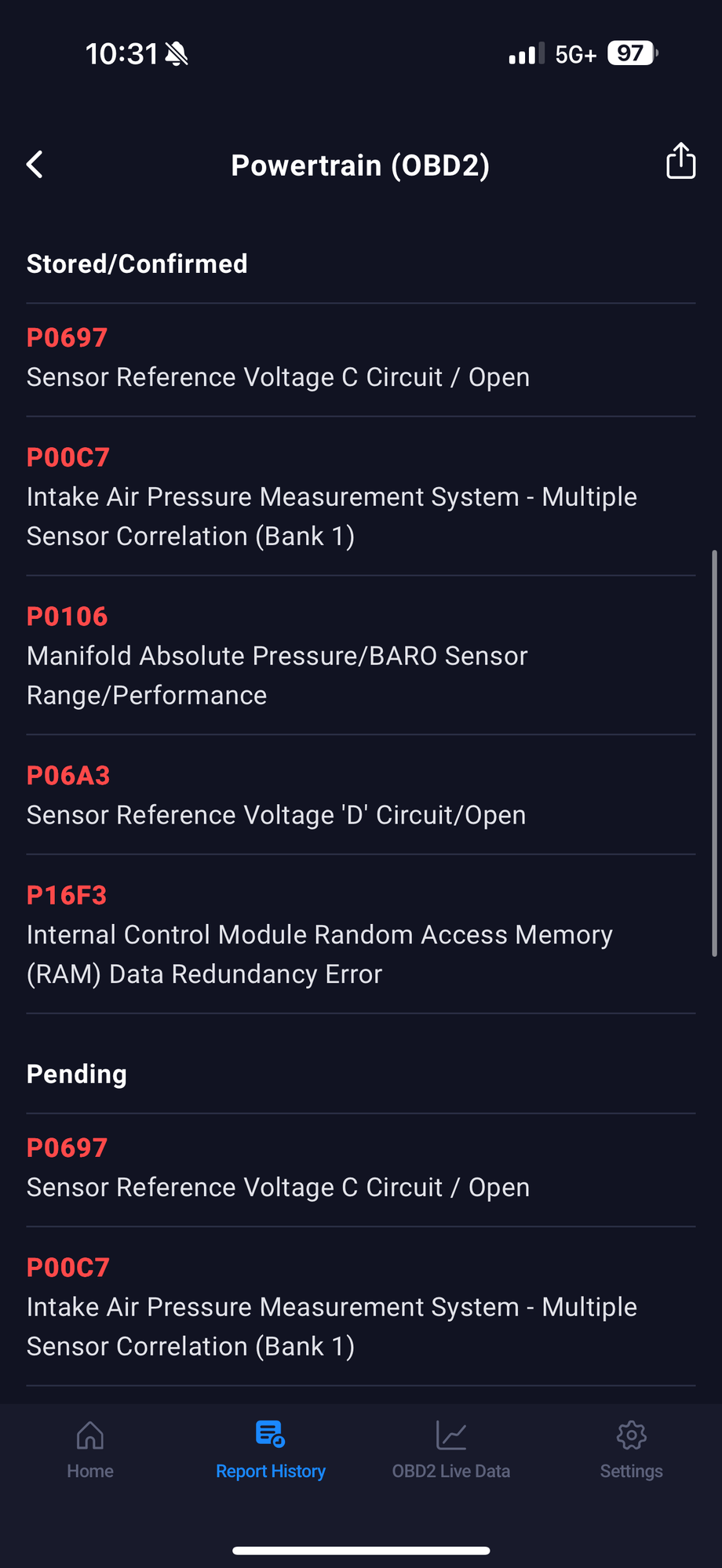

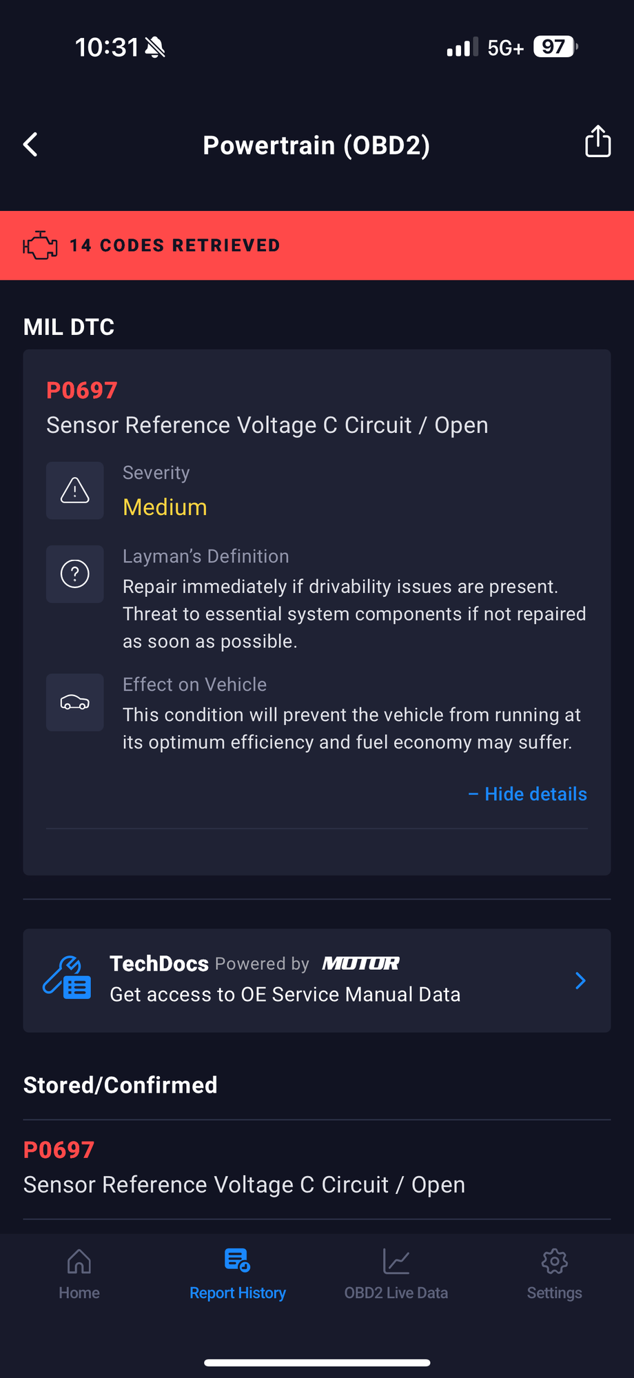

I've got a 2016 Stingray M7. Headers, intake manifold, CAI, and a tune. It was driving just fine to the grocery store and when I came back to my car to leave, it would try to start, but wont start. Says engine power reduced. I scanned it and it gave me 14 error codes. This hasnt happened to me before. I've had it for about over 3 years now. Anyone have any ideas about what it could be?

The codes indicate that 5V Reference 3 and 5V Reference 4 are either shorted to ground or shorted to voltage. 5V Reference 3 connects to the accelerator pedal position sensor 2 and the manifold absolute pressure sensor. 5V Reference 4 connects to the accelerator pedal position sensor 1 and the throttle position sensor. I would start by checking the reference voltages at the accelerator pedal with the pedal connected and disconnected.
This is not likely to be a battery problem.
