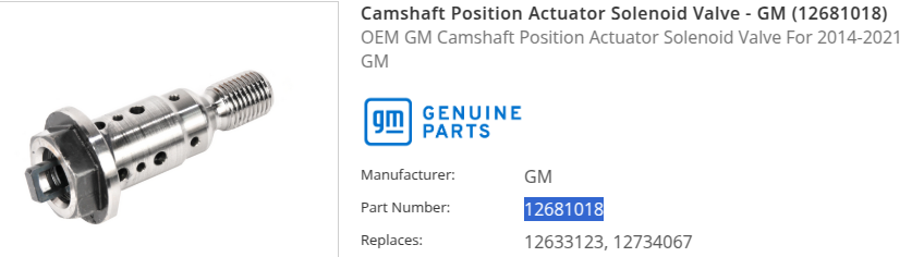

GM published a note about the camshaft bolt being reusable one time:
Due to parts availability and variance in applications, a replacement cam bolt is no longer included. GM has released a Torque spec for reusing this bolt 1 time. The Tq spec is 48 ft.lb plus an additional 50 degrees
There's no counter on my bolt tho and I can't find this bolt nor the part number at my supplier
edit: Is that the "bolt"? GM 12681018

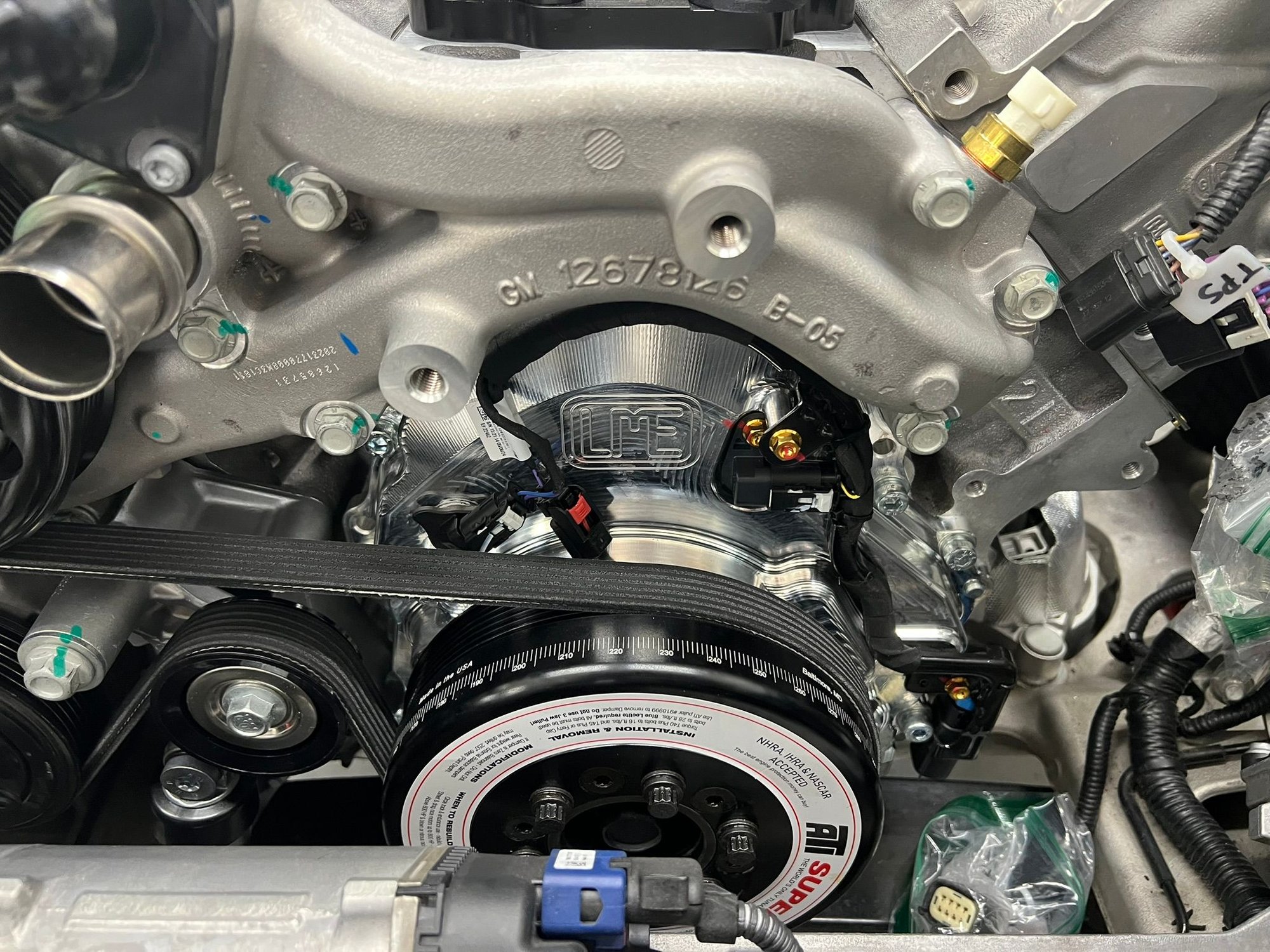

Originally Posted by 96GS#007
- You'll need a tool to locate the oil pump if you're planning to reuse the existing pump (lots of Google info on this)
Yes I'll reuse my oil pump as the computer will adapt the flow/pressure automatically (contrary to an LS engine). What do you mean by locate the oil pump?
Old Jun 1, 2025 | 04:10 PM
96GS#007's Avatar
96GS#007
Joined: Apr 2000
Posts: 15,344
Likes: 4,009
From: Texas
https://www.michiganmotorsports.com/...EaAuQ5EALw_wcB
Google is your friend. Plenty of info regarding "why". Success rate for those that don't align it runs 50/50.
Not my first rodeo
