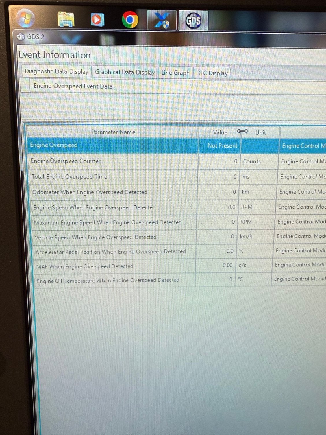

I'll be interested to see what this looks like since there's the "oh ****, missed a shift" and then there's "banged the rev limiter" trying to grab that last mph. In particular is there any differentiation between the two.

it doesn’t show banged the limiter, it shows oh **** I put a window in it.

It’s under [K20] Engine Control Module, Event Information, Engine Overspeed Event Data (right next to Oil Level Warning Data btw).
here’s what it reports.
