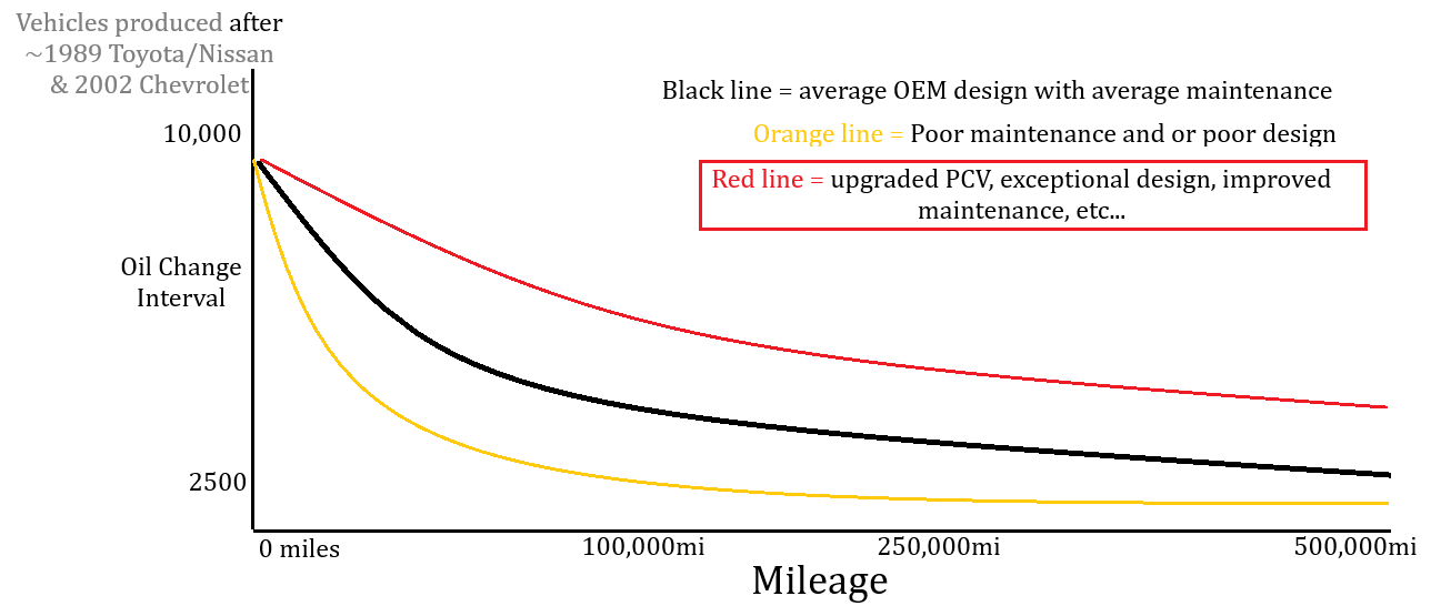

I think there is a misunderstanding somewhere. What I meant is when we buy a vehicle thats got an engine full of sludge, or if were previously following 10k or 5k mile oil changes with blind trust, and find it full of sludge at 100k or whatever, suddenly realizing the minute you pour oil inside its already filthy before it has any miles at all. Those kinds of engines are in a terrible place, quite unfortunate. And it happens when they reach 50k to 100k with 5k to 10k mile oil changes now, more frequently than ever it seems now.
For example I have a 5.3L With 240,000 miles, the oil coming out is pretty clean now that I've been changing it and caring for it from 180k, hand selected it out of about 12 engines I inspected specifically for cleanliness in the JY. Its a factory original with now 600rwhp dynojet turbocharged these last 7 years or so, and I change the oil once it starts to get fuel-smell and darker around 2,400 to 2,800 miles to keep it looking clean in and out. This engine will probably see 500,000 miles with minimal maintenance, its from the 2002-2007 Silverado era. There are many engines like this one - the sr20/2jz/RB25 from 92-02 for example. Same pistons and general design. Same mileage capable. Will discuss piston and oil temp below more. If I was doing 5k or 10k mile oil changes it would already have failed and full of sludge, even though the oil would come out with plenty of life left probably. That is the point.
That sounds like a lot of assumptions of their assumptions. Still, just because the engine (assuming you are right) can last millions of miles, do you want it to and at what expense of time and money? Will the drivetrain last that long and will the body and the rest of the electronics? Will parts be still available?
My world is built around 200k miles engines that need to see 400 to 600k miles with original parts. This is my daily routine, nothing strange or otherworldly. The right engine inside does not appreciably wear out when its being maintained properly. They need oil pump, valve related hardware, seals, that sort of thing over time, of course, but this does not require any rebuild or machine work. This was figured out sometime in the 80's for Toyota and Nissan and probably others but didn't become the norm for Chevrolet until around 2002 ish.
The gradual slight loss of compression is helpful in forced induction applications as well, makes them more tolerable to boost it seems. That has been my experience, with engines pushing 150psi to 180psi near service limit run perfect and dont leak or smoke thanks to proper PCV. The key is PCV, knowing how to measure it and support it, most people cannot do that I guess.
Are the parts for a 2007 L33 or 2002 LM7 Still available? Yes currently those 2002-2007 era LM7 and L33 are readily available, including the low mileage engines, their computers, aftermarket support, and so on, as well as 4l80e transmission and brand new six speed specimens which support the 600 to 900rwhp I desire from factory internals at this displacement with reasonable fuel economy. A $50 computer will run it in flex fuel with 200lb injectors for example. And if it does not, there is always haltech, aem, MS, pfc, etc... aftermarket ECU options to control engine/transmission as needed. As more advanced units become available , 6 speeds, 8 speed transmissions and so on, they can be retrofitted if desired. I have recently tuned a RB25 with a 8speed automatic for example, its a 25 year old engine with a 10 year old transmission or whatever. They are cheap now. The new parts become cheap and retrofit to the old engine as reliable drivetrain as needed.
If an engine doesn't fall into a specific criterion - easy to tune, easy to swap, easy to maintain, easy to work on, etc... then why force it? The question of reliability is tied to ease-of-use on some level. Technology that drives modern design of the last decade or so doesn't seem user friendly and doesn't add much to performance other than computer control related which can mostly be retro fitted to older example if truly desired. Due to the higher complexity of modern engines I fear that simply maintaining them isn't going to be enough to keep them in service. Keeping the oil clean and engine insides clean isn't going to solve all of the external milieu of controllers and computers that have been added to squeeze that last couple of percent of economy and emmissions out of some power plant which most owners could do without happily. In a big picture way, I believe comes down to spending and luxury - purchasing the latest and most desirable zero miles specimens which are closer to unmaintainable and unfixable than anything previously, and that is part of the price you pay and the expectation is now you have to damn near throw it away once its been used no matter how well its being maintained because the cost and knowledge and equipment to fix it and upkeep is so great for a traditional diy user. Which makes your point extremely valid - for the engines I work on, I would say yes there are many and parts galore still and quite easily to mod and come by. But for the vehicles and engines of recent years, probably no and even if they are , you wouldn't want or be able to anyways.

Originally Posted by aklim
When your infotainment screen fails, I don't see a cheap fix. If you want to bypass the C7 ECM and have a rigged unit, sure. Can you replace the rest of the systems if GM doesn't support it?
I see where our thinking ways differ here the most. In my mind, the goal first and foremost is reliability transportation. Items which matter are: engine, transmission, drivetrain, tires, and a chassis that doesn't vibrate or steer poorly at high speeds is nice. The basic fundamentals of transportation needs. From that point, power and economy is nice, but not absolutely necessary. The reason for my thought process stemming this way is an apocalyptic scenario where all you need is transportation. Not luxury or power. Maybe economy. I am a survivalist mindset with a hobbyist aim at getting the most from whatever I have to work with. This often means simplicity is king.
Lets Take a modern engine example. We can begin to remove 'unnecessary' equipment from the engine. Disable the internal injection systems, solenoids, remove the computers, lockout the valvetrain altering mechanisms. The engine at its heart will still run using a carb if needed even if I have to hold a 5gallon bucket of fuel over it to feed it. The oil pump will still work and there are many creative ways to fire the spark plugs but this will prove challenging without any drive mechanism for some distributor which means now I need a computer to interpret signals and fire a driver and it needs to be fine tuned to fire the plug after the driver is activated within a specific time delay which can be many degrees of rotation - it is a control theory problem now, not simply a mechanical one. Thus, those(any) systems in place which replace the most fundamental of transportation queue devices are purely luxury & extraneous until the modern design 'forgets' to include some basic feature that any mechanical operation (computerless) depends upon in any way. In this case, simplicity most likely means that a factory computer is more feasible than anything i could come up with on my own in short notice, so we are back to square one so to speak with how do I get a computer to function while still removing as much equipment as possible that was deemed unnecessary, which was your question I think. Another option is to turn rotation at the crank into some spark distribution system - now the question becomes application. In a hobby scenario the original controls of a factory ECU would be ideal. In an apocalyptic scenario I would not care about having timing profiles for spark so the crank driven solution with some capacitive discharge rudimentary coil for basic transportation would be ideal even if it means constant rpm like a generator. In between these ideas another option is to find a computer which can interpret signals easily for the timing profile application without having to invent and program one for myself - enter the stand-alone ECU, a technological marvel but limited of access for potentially apocalyptic scenarios. It really depends on the application when we start looking at future, specific uses for modern engine/drivetrain support in this way.
The question on computer vs luxury is a kind of 'can of worms' with many answers that depend heavily on why you need or want that specific vehicle or engine to run in the first place. If we wanted a seamless transition away from useless unwanted technology while still maintaining the most economical and power and cleanliness related features often the easiest method is to simply reprogram an OEM ecu and turning off those unwanted features inside it directly, such as with HPtuners, which does exist.
