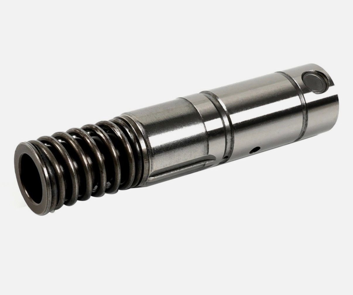

Old Nov 6, 2025 | 06:38 PM
Chip E.'s Avatar
Chip E.
Posts: 404
Likes: 99
From: Chicago IL
St. Jude Donor '16
Default AFM lifters have springs in them
Originally Posted by Tinkertech
Is it a bad lifter or broken spring?
I am not the OP, but to answer your question, it’s probably good to understand that C7‘s have half solid lifters and half lifters that are solid with springs, that’s how the AFM system works… or more correctly how the AFM system fails

Old Nov 7, 2025 | 06:18 PM
Chip E.'s Avatar
Chip E.
Posts: 404
Likes: 99
From: Chicago IL
St. Jude Donor '16
I was asking if the AFM lifter itself was defective or the valve spring (on top of the head) was broken.
This answer will determine what repair is needed.
You’re still not tracking. AFM lifters have a spring in them that collapses, that’s how AFM disables cylinders 1,4,6 and 7 to run in 4 cylinder mode.
Recap, Gen V LT 1 has:
Valves and Valve Springs
16 Lifters
8 of the lifters are solid, normal.
The other 8 are the AFM lifters, half solid and a the other half is a spring, hence a lifter spring. So unless OP was misinformed, he had a stuck lifter spring…either stuck open or stuck closed.
Old Nov 8, 2025 | 09:10 AM
Tinkertech's Avatar
Tinkertech
Joined: Feb 2018
Posts: 2,143
Likes: 1,026
From: North Texas
We are still not tracking.
Two different issues. One is the AFM lifter itself, and the other is the intake and exhaust valve springs that are on top of the head. The AFM lifter is on top of the cam.
Two different areas of the engine all together, AFM lifters are located inside the block and the intake and exhaust valve springs are located on the head.
You can replace a broken valve spring (intake and exhaust) without removing the head but you must remove the head to replace a defective AFM or regular lifter.
So, the original question remains, what failed? An AFM lifter or a intake or exhaust valve spring? The answer to this question would determines what repair is needed.
Old Nov 8, 2025 | 07:07 PM
Chip E.'s Avatar
Chip E.
Posts: 404
Likes: 99
From: Chicago IL
St. Jude Donor '16
OP clearly stated twice in the original post “lifter spring”. He didn’t say “valve spring”. So unless the shop got it wrong or the OP didn’t understand what they said, the only thing “lifter spring” could mean is an AFM lifter, not a valve lifter. Are we tracking now?
Old Nov 8, 2025 | 07:48 PM
user051728's Avatar
user051728
Joined: Oct 2005
Posts: 7,002
Likes: 2,679
Lifter spring isn't a thing, so we really don't know if he means valve spring or lifter. I mean an AFM lifter isn't a spring, per say (it has a spring component but its not removable).
This is why words are important.

Old Nov 8, 2025 | 08:00 PM
  #33
Chip E.'s Avatar
Chip E.
Posts: 404
Likes: 99
From: Chicago IL
St. Jude Donor '16
Originally Posted by LT1 Z51
Lifter spring isn't a thing, so we really don't know if he means valve spring or lifter. I mean an AFM lifter isn't a spring, per say.
This is a picture of an AFM lifter, which is half solid and half spring. What would you call the spring portion of the lifter?
Old Nov 8, 2025 | 08:05 PM
  #34
user051728's Avatar
user051728
Joined: Oct 2005
Posts: 7,002
Likes: 2,679
I edited my first post, since its not removable I wouldn't call it a spring. It's just part of the lifter. If something was a lifter spring, it to be would be serviceable separate of the lifter. This is not.
Again, this is why words are important. A valve spring, is separately serviceable from a valve.
Old Nov 8, 2025 | 08:10 PM
  #35
Chip E.'s Avatar
Chip E.
Posts: 404
Likes: 99
From: Chicago IL
St. Jude Donor '16
You’re telling me a device made of elastic material, typically metal, that can be compressed or stretched and then returns to its original shape on an AFM lifter isn’t a spring? It doesn’t matter if it’s independently serviceable, there are actual WORDS that can be used to describe it, and if it’s not the “lifter spring” what is it?
So what would YOU call it, seriously?
Old Nov 8, 2025 | 08:14 PM
  #36
user051728's Avatar
user051728
Joined: Oct 2005
Posts: 7,002
Likes: 2,679
I would say that the lifter has a spring as a component. But I wouldn't call an AFM lifter a "lifter spring" I would call it the spring from a AFM lifter.
Do people go around calling the springs in struts, "strut springs" instead of referring to it as a strut, or just calling it a spring?
You're missing my point, and that is just throwing the word spring around leads to confusion, so we should use the right terms. If someone mistakenly refers to the AFM lifter as a "lifter spring" they should be corrected. Language exists to communicate clearly, what good does it if you can't do that?
Old Nov 8, 2025 | 08:41 PM
  #37
Chip E.'s Avatar
Chip E.
Posts: 404
Likes: 99
From: Chicago IL
St. Jude Donor '16
I understand the preference for precise terminology. However, within the context of a GM AFM system, the term 'lifter spring' is universally recognized in the automotive community to mean the internal spring responsible for collapsing the lifter. While 'plunger spring' is the more technically accurate name, using 'lifter spring' efficiently identifies the failed component in question, and most English language speakers, in this context, will understand it’s not a reference to a valve spring, nor to a conventional solid lifter:
So, what would you call this component, and why do you oppose the colloquialism—and widely accepted terminology—of 'lifter spring'?

Old Nov 8, 2025 | 08:42 PM
  #38
jeffs64's Avatar
jeffs64
Joined: Jan 2018
Posts: 973
Likes: 268
From: Oro Valley Arizona
A valve spring is on the intake and exhaust valve. There’s 8 lifters that have a spring in the bottom of it as part of AFM system. 8 do not. As pictured in the previous post.
Old Nov 8, 2025 | 08:56 PM
  #39
Chip E.'s Avatar
Chip E.
Posts: 404
Likes: 99
From: Chicago IL
St. Jude Donor '16
Originally Posted by jeffs64
a valve spring is on the intake and exhaust valve. There’s 8 lifters that have a spring in the bottom of it as part of afm system. 8 do not. As pictured in the previous post.
exactly!
Old Nov 8, 2025 | 09:35 PM
  #40
Chip E.'s Avatar
Chip E.
Posts: 404
Likes: 99
From: Chicago IL
St. Jude Donor '16
Elgin Industries is a leading expert in GM valvetrains. Here’s a quote from them.
The lifter spring will stay compressed to prevent the pistons from contacting the valves. This lifter design is a huge improvement over the old/troublesome design of the active fuel management lifters!”
You can find the quote on this page.
https://northernautoparts.com/afm-li...-00Xe4K6erCW4W
Let me know how it goes when you tell them you know more than they do and they’re using the wrong words that matter.
