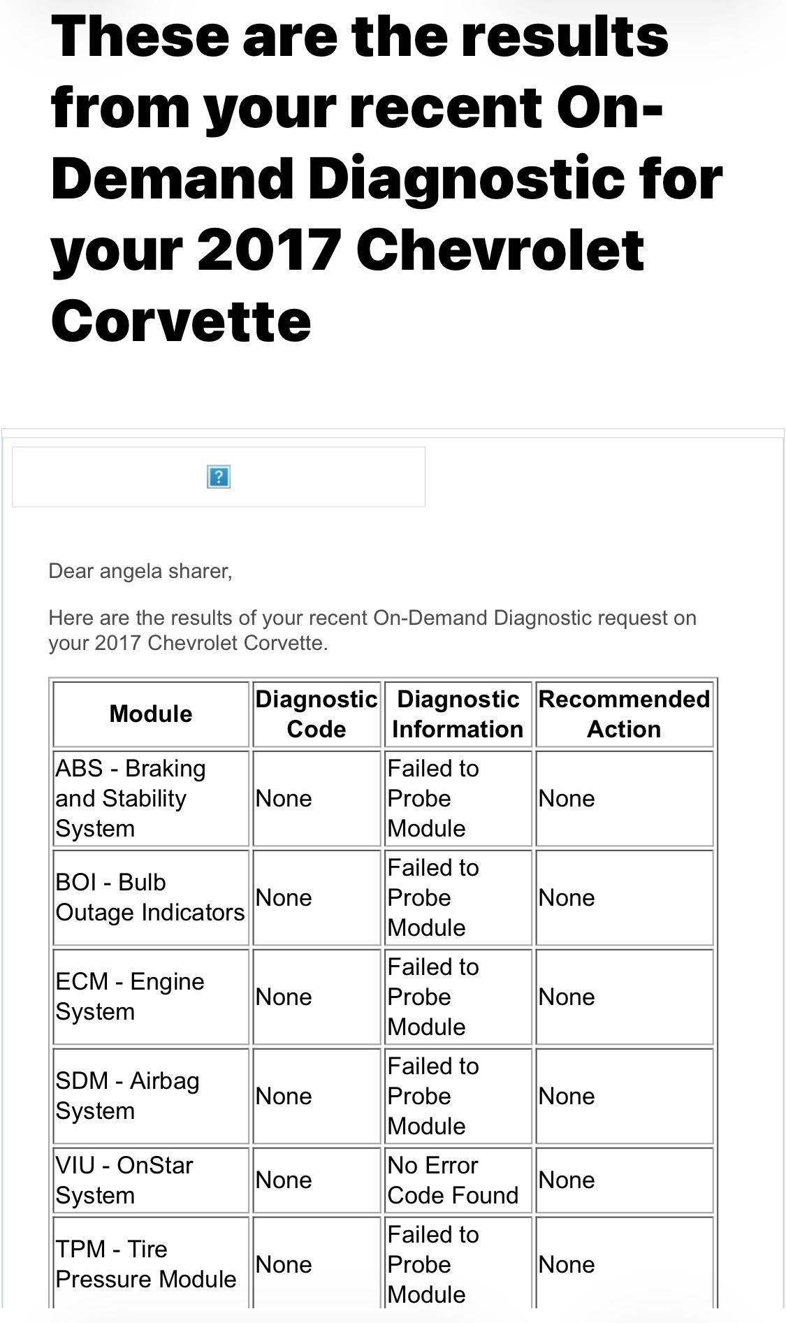

Old Dec 31, 2025 | 04:03 PM
MLEN1UM's Avatar
MLEN1UM
Joined: Apr 2002
Posts: 228
Likes: 11
From: Southern Maryland
Default still broke
Battery load tested good with Foxwell tester.
Attached is a scantool report - it shows battery voltage low but other tests have not shown the same.
Same Service messages every time - service airbag, service tire monitor system, service theft deterrent and service suspension system. None of the DIC gauges show any indications/readings. No welcome message, DIC displays take several seconds longer to come on than normal. I've found 2 owner reported accounts of the SDGM being involved in instrument cluster not displaying on 2017 Grand Sports. We're still working it but it's been slow over the holidays.
Happy New Year!!

Originally Posted by MLEN1UM
Attached is a scantool report - it shows battery voltage low.
More importantly, the instrument cluster is missing from the report. It is not communicating with the scan tool or the other modules. Your diagnosis should start here.
exactly. But to close the battery question I got a new AC Delco at Autozone today. Had them test it before I left the store. Installed it just now and exact same symptoms.
yes I’m worried about possible rodent damage but hoping to put together enough info with symptoms to have an educated guess where to look without taking the whole dang car apart.
I forgot I also had OnStar run a scan in early November. No codes they said! 😂☹️
Old Jan 2, 2026 | 02:11 PM
C5 Diag's Avatar
C5 Diag
Moderator, Tech Contributor
Posts: 15,595
Likes: 4,057
From: Cape Coral, Florida
You need to do a code scan with a factory level scan tool to see what modules you can or can't communicate with.
