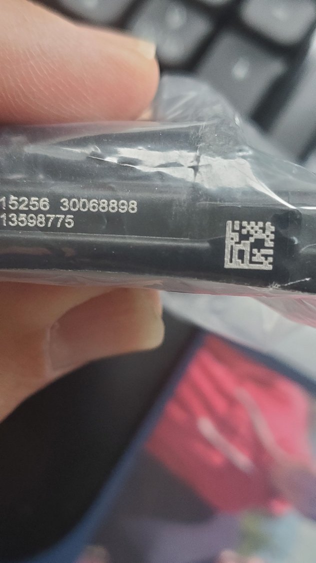

Indeed the plot thickens haha. Yes there is no doubt corvette garage is selling Temu versions.
Like you said the bag from corvette garage was just blank, a plain plastic bag with no markings. And this is what made me suspicious.
The top bag in the pic is the sensor bag and the bottom bag is the valve stem nut. They are 2 different part numbers and bought these from Summit Racing. Also the GM ones from Summit said Schrader on the back of them. The ones from Corvette garage do not.
The corvette garage advertised part number “13598775” sensors are absolutely 100% not GM genuine Schrader sensors.

So, after figuring out how to find a date-code on the TPMS sensor, I looked back at photos I took of the sensors I bought from Corvette Garage (May 2025), and they are GM sensors made by Schrader, but the date code is 2015......so stupid me installed four 11 year old sensors with my new tires and wheels....
The Date code is printed on the black plastic side edge of the sensor, white ink, formated:
GM sensor:
xxyyy CCCCCCCC
13598775
Schrader replacement sensor:
xxyyy CCCCCCCC
20223/3033
the "xx" is the year ("26" = 2026)
"yyy" is the day of the year (1 to 365)
"CCCCCCCC" is the unique ID number of that sensor, that gets learned to the TPMS system
"13598775" is the GM part number on a GM labeled sensor.
"20223/3033" is the Schrader part number for the replacement sensor
So, lesson learned, don't try to save money, just buy the sensors from a GM dealer, and check the date-code before installing them.
