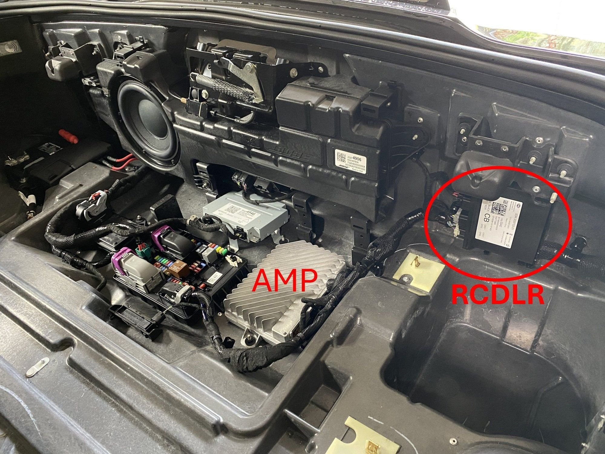

So, I have the same problem, with my 2017 GS. The TPMS system often loses the ability to pick-up the signal from the front passenger tire sensor.
This all started when I got new tires, new TPMS sensors, and new wheels.
I relearned the new sensors, but noticed that the front passenger sensor relearn was stubborn, had to try it many times till it was successful. The new sensors are made by Schrader, part number marked as "13588775", bought from Corvette Garage, clear plastic bags with NO GM labels. So, these are not genuine GM parts, but OEM replacement parts (Schrader is the OEM supplier of this part to GM).
Drove the car after the relearn, and all sensors were reporting the correct tire pressure. After about 20 minutes of driving, the TPMS system could not read the front passenger tire, and --- was displayed, and the TPMS warning light came on.
I reset the BCM DTC (TPMS is done by the BCM), and then a short while later, during another drive, the front passenger sensor did report tire pressure, but then some time later it lost it again, with the TPMS warning light coming back on.
I verified that the problem is not the sensor in the front passenger tire, as I swapped the left and right front wheels, and the problem remains with the front passenger wheel location. This verifies that the problem is NOT the sensors, but the ability of the TPMS system to properly receive the signal from the passenger front wheel location.
I bought a TPMS Diagnostic tool to troubleshoot, and the battery level of all the new sensors is good, and the tool can read the tire pressure fine, so I don't think the new sensors are the problem.
Amazon.com: XTOOL TP150 TPMS Programming Tool, Universal TPMS Relearn/Reset/Activate Tool(315/433MHz), Tire Sensor Programmer for XTOOL TS100 Only, Tire Pressure Monitoring System Diagnostic Tool : Automotive Amazon.com: XTOOL TP150 TPMS Programming Tool, Universal TPMS Relearn/Reset/Activate Tool(315/433MHz), Tire Sensor Programmer for XTOOL TS100 Only, Tire Pressure Monitoring System Diagnostic Tool : Automotive
From reading the GM Service Manual, the RCDLR (Remote Control Door Lock Receiver module has 6 antennas (around the car) that pick up the 433 Mhz radio signals from the 4 TPMS sensors (and also the key-fob remote for unlocking/locking and starting authorization)
The RCDLR is located on the back-wall of the rear cargo compartment, on the interior, covered by the rear trim panel. The RCDLR talks to the BCM (thru a CAN bus), sending it the sensor ID#, the tire pressure, and the sensor battery status. The BCM then determines if the TPMS system is operating correctly (The BCM checks if each sensor transmits to the RCDLR ever-so-often if it detects that the wheels are turning), and sends the tire pressure info to the Instrument Cluster for display.
The RCDLR uses the 6 antennas so it can locate where the key-fob is (outside the car, or inside the car), and the 6 antennas are also used to pick-up the TPMS signals, perhaps aiding the TPMS system to identifying which wheel is transmitting from what location.
The bottom line, is that I believe loss-of-signal strength from the front passenger wheel sensor is the most likely root-cause of the problem, because it is the furthest away wheel from any antenna. I think the different shape of my new wheels block just enough RF signal from the wheel sensor to cause my problem.
My plan of attack is to check the 6 antennas, and perhaps try to move one of them closer to the front passenger tire.
And no, I do not have aftermarket side marker LEDs, or anything like that which can cause RF noise interference to the TPMS.
This problem is extra frustrating, because when a TPMS fault is set, the Active Handling / Traction Control system activation threshold is set to a much lower fail-safe value (in case you really do have low tire pressure), so any slightly spirited driving is curtailed, cutting throttle and perhaps applying some braking.

More info:
The signal from the Tire Pressure sensors (in the tires) is received by the RCDLR (Remote Control Door Lock Receiver), and then the digital data from each sensor is sent to the BCM module, over a CAN bus.
I think the problem is either a bad antenna, or a poor connection to an antenna, OR the RCDLR itself has an internal problem. My plan is to first check the connectors at the RCDLR, to see if there is any corrosion / oxidation of the connectors which go to the antennas. But, my car is now in storage, this will have to wait till springtime 2026.
