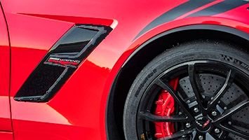

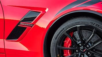

Anyone change out side vents yet on a Grand Sport? I would guess it is about the same as the Z06 since it has the dry sump system.
I may need to change vents to get rid of the body color accents that look stuck on for all black..
