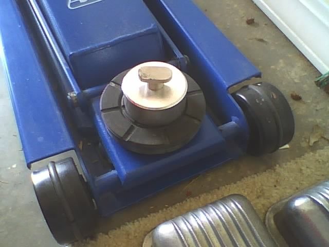

I use the long Katech pucks and they work great. I wouldn't consider leaving anything in all the time. It only takes one time to hit something and really make a mess. It doesn't take that long to put them in or remove them. I use an AC jack and it works great. If you use the AC rubberpad it won't hurt the pucks. I also bought some cross beam adapters so that I could lift the whole front, or rear, end at one time. I found the guy that makes them on ebay and gave him my measurements. He has photo's of my yellow z06 on his discription.
