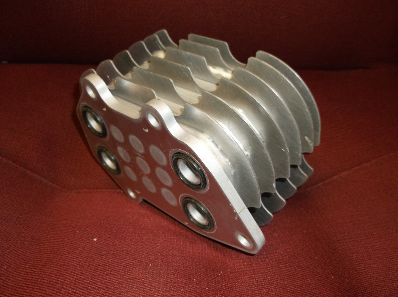

Originally Posted by ronsc1985
It's been a long time since I did any heat transfer stuff but one thing I do remember is adding anything in the path to the end heat sink, in this case air, detracts from the heat transfer rate. The only thing that really helps is increasing surface area of the last thing before the external heat sink, in this case air. That is why you see heat sinks in electronics with a lot of surface area provided by multiple fins.even though the mass of the intermediate heat sink is less then a solid piece of equivalent external volume.
As to the paper it would seem this is an engineering student paper/experiment probably done as an undergraduate senior design/ analysis course. Such courses used to be a requirement in most all engineering schools (this paper is from 44 years ago) to demonstrate some actual familiarity with an actual design of something relevant to the degree being sought. My observation is based on not seeing any degrees/experience citations behind he authors names as is/was always the case for such papers.
If you want to spray something on the fins that really cools, maybe to a fault, NOX is an good choice. The bad news is you may crack the core due to rapid thermal contraction and in an actual race possibly trigger the safety crew from the vapor trail down track.
I actually used this method screwing around during a test day. It was effective however not really practical for actual racing where in later rounds you may have to run back to back with no time to refill the NOX bottle.
BTW it did cause the safety crew to roll from the vapor trail. It did however take the intercooler water temperature into the mid 50's F vs 100+ F with just air flow. I was using a 10 oz nitrous bottle marketed in those days as Sneaky Pete for people running in restricted classes trying to hide the nitrous from the tech inspectors. There were some fine explosions from people trying to use these bottles hidden in oil pans.
Ronsc interesting read and exactly why we designed our cooling fins for the factory oil - coolant brick. Its a simple heat sink just as you described! We've been using it on our Z06 for 3 years now and never a limp mode or even high range oil or coolant temps. While some shun this because we have no high tech data and no plans or time to, its just not that complicated just like the spray. It works for me and I assume for others around the country that use them. All I can say it surly cant hurt. The water spray on to the radiators is a simple cheap help too and I was shocked Porsche uses it to. I am amused when reading of all the overheat complaints to our Z's and then find out the much more expensive and not any faster hot rods have the same issues.
