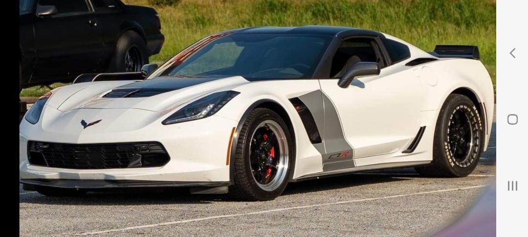

If you hook it up, yes you will start breaking things. I've had 5 drivetrain failures in my 16 Z06. You can really look at your 60' time. Once you go below 1.40's it happens pretty quick. My last failure was the flex plate and it's been replaced 3 times. I've gone to a RPM Wavetrac diff and GForce axles. Right now I'm taking the summer off of drag racing. It's just too hot for my health. When it gets cooler I'll go back. My last 3 times at the track the car had to be towed home or straight to a shop.
