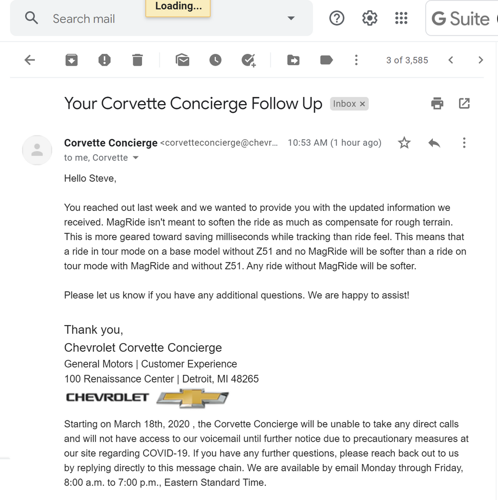

I saw this on the forum at one time!
Old Feb 13, 2021 | 02:44 PM
Fast Dawg's Avatar
Fast Dawg
Joined: Sep 2017
Posts: 5,767
Likes: 2,966
From: Rural NW Georgia. GO DAWGS!
Well that made it confusing. ☝️☝️☝️
I’m going to order soon and I’m wondering the same thing the OP is asking about on this thread. I don’t plan to track the car but did want something to make it handle better when I take rides in the N. GA mountains, so I thought I would go with the MSRC and not put the Z51 package on it. That also gets the all season Michelin’s from the factory vs the summer only run flats, which in my experience has given my last two Corvettes a better ride.
Thoughts?
I'd take this with a grain of salt. The concierge has been known to provide incorrect data.
I know for sure that the statement "Any ride without MSRC will be softer" is incorrect. The Z51 without MSRC is not "softer" than a Z51 with MSRC.
To Msrc
