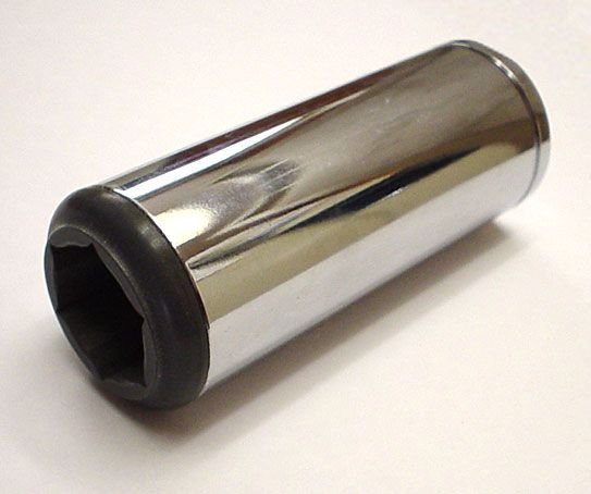

That is what I use. BUT see many that only have the outer plastic protection. Helps the wheel BUT not the lug.
I had used the one in pic below for ~10 years on my C6 and C7 Vettes. It has a hard plastc inner part that touches a lug. But now over $35 if you can find and none for 22 mm lugs. Frankly dout it would hold up well with 140 ft-lbs.
Note the 22mm Titan has rounded corners that prevent the steel inner from contacting the lug nut corners. Has worked fine.
I also use a short extension (called 1 1/2" but it fits flush) and only ends enough length so my torque wrench just clears my fenders. Closer the better as easy to get 140 lbs using two hands and legs! No strain on lower back!

Yep! In fact, for the ~10 years I posted my plastic inside lug socket a few commented about it not having a plastic outside! As I would NOT use a powered wrench on my wheels NO NEED. Also, IF that was a concern would wrap with electrical tape. The issue is the lug nut not the wheel. That is controlled by the use of the proper wrench!
No-Mar socket I used for ~10 years on my Vettes. BUT not available in 22mm and wonder how it would hold up with 140 ft-lbs. Have found the Titan works fine with my breaker bar, 1/2-inch drive ratchet and torque wrench.
