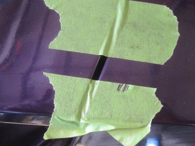

Side note: To avoid 'energizing' the chassis on the above FE Vettes: After the car is corner weighted and weights and ride heights are noted, the back of the car must jacked to unload the rear tires. Note front corner weights. Then unload the front tires and note rear corner weights. If they measured the same as all four, that's cool. If the back is different, bring the corner weights at the back to the same as when the front was jacked up. You have just eliminated the stored energy in the chassis. You may want to put some tape on the door gaps and observe flex.
