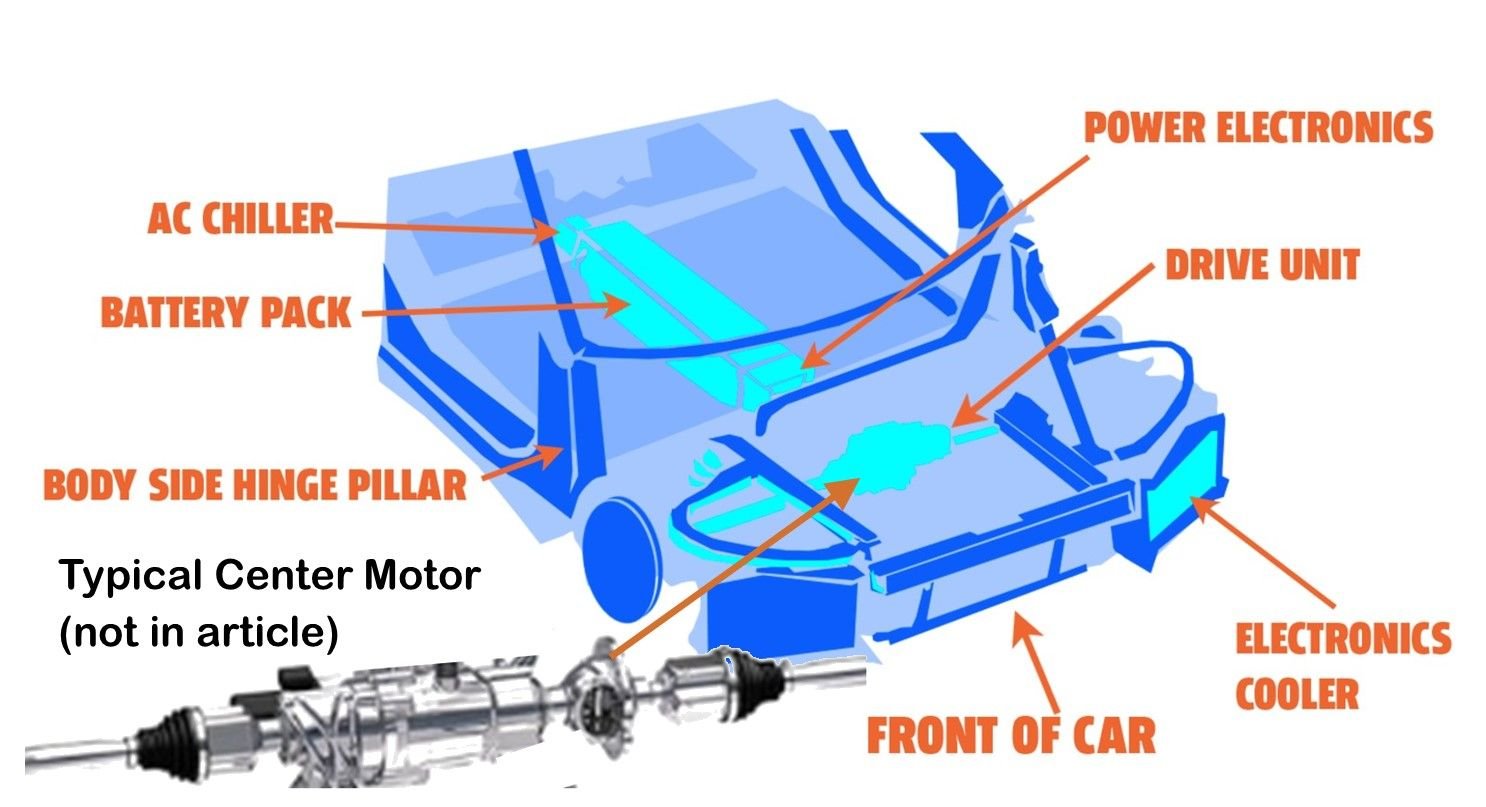

Originally Posted by teghogh
saw the C8 up close in person and looks great. i know every one has issues with the rear end which is understandable. However my problem is with the interior design ( not the quality which is great). previous generation vettes felt claustrophobic due to the torque tube running in the middle of the car. given the ME architecture of c8 there should not be any mechanical constraints preventing the center console to go all the way to the floor. Maclarens feel much roomier on the inside because of that. does anyone know what resides below the center console that requires it to be at this specific height?
As some others have said, the large center support is a main structure member, allowed lower side frame rails than the C7. BUT the main reason became clear with the leaked Hybrid c8 info in the November 2019 article. Pic below is from that article that is in this Thread: https://www.corvetteforum.com/forums...-drive-c8.html
You can read through the Thread and see my posts as it was my first realization of the "real reason," IMO for no standard shift. Made it clear the foolish sounding "no pedal room, can't cut into the center support," were just Marketing Speak. When the C8 was to be released some C8 Hybrids would soon be needed to meet the then planned Law requiring about ~23 mpg at a 2020 launch and ~40 mpg in 2025!
NOTE: The Article Defined the Battery as a Relatively Small 1.92 kWh Capacity. Probably <75lbs.
