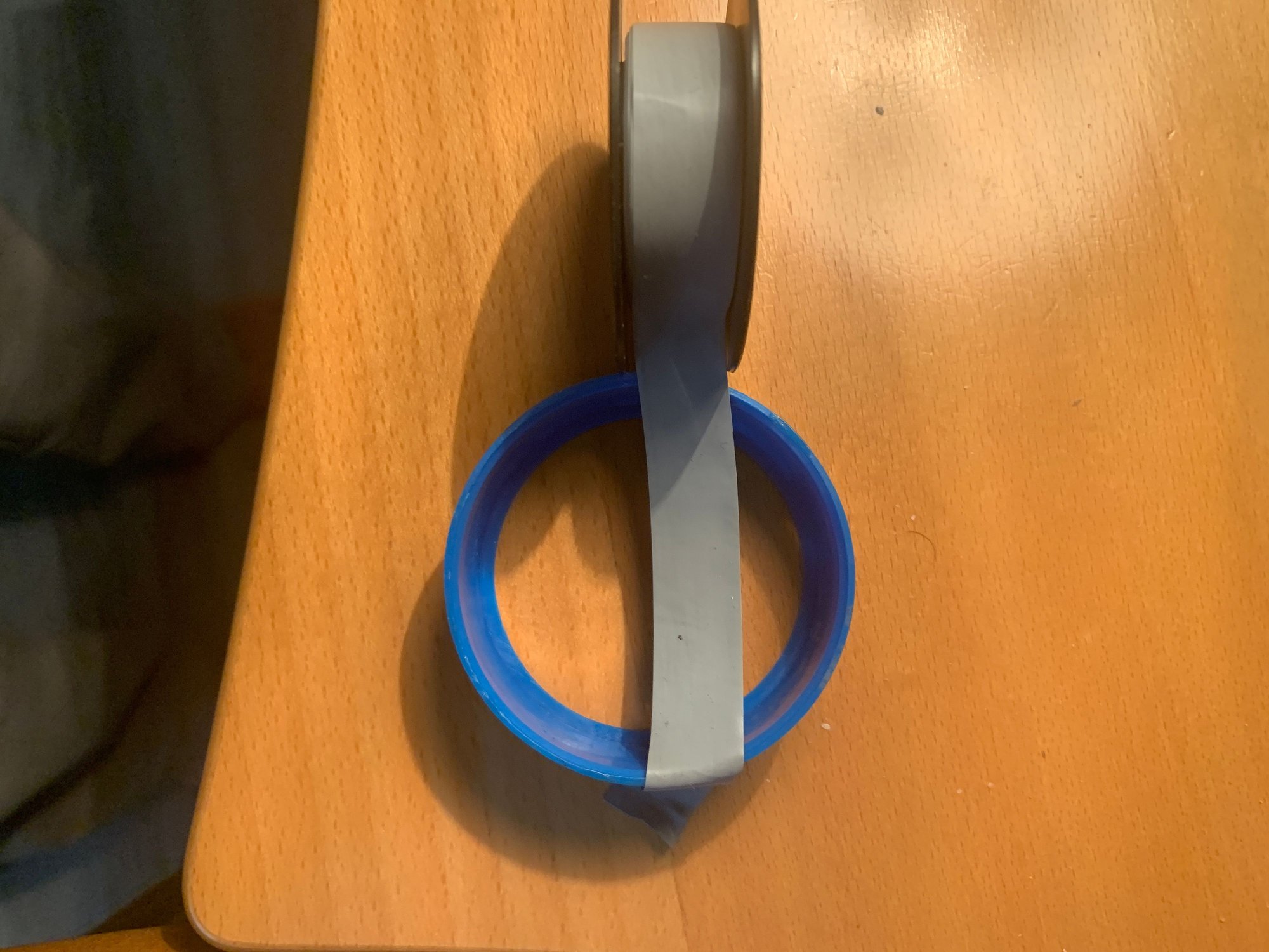

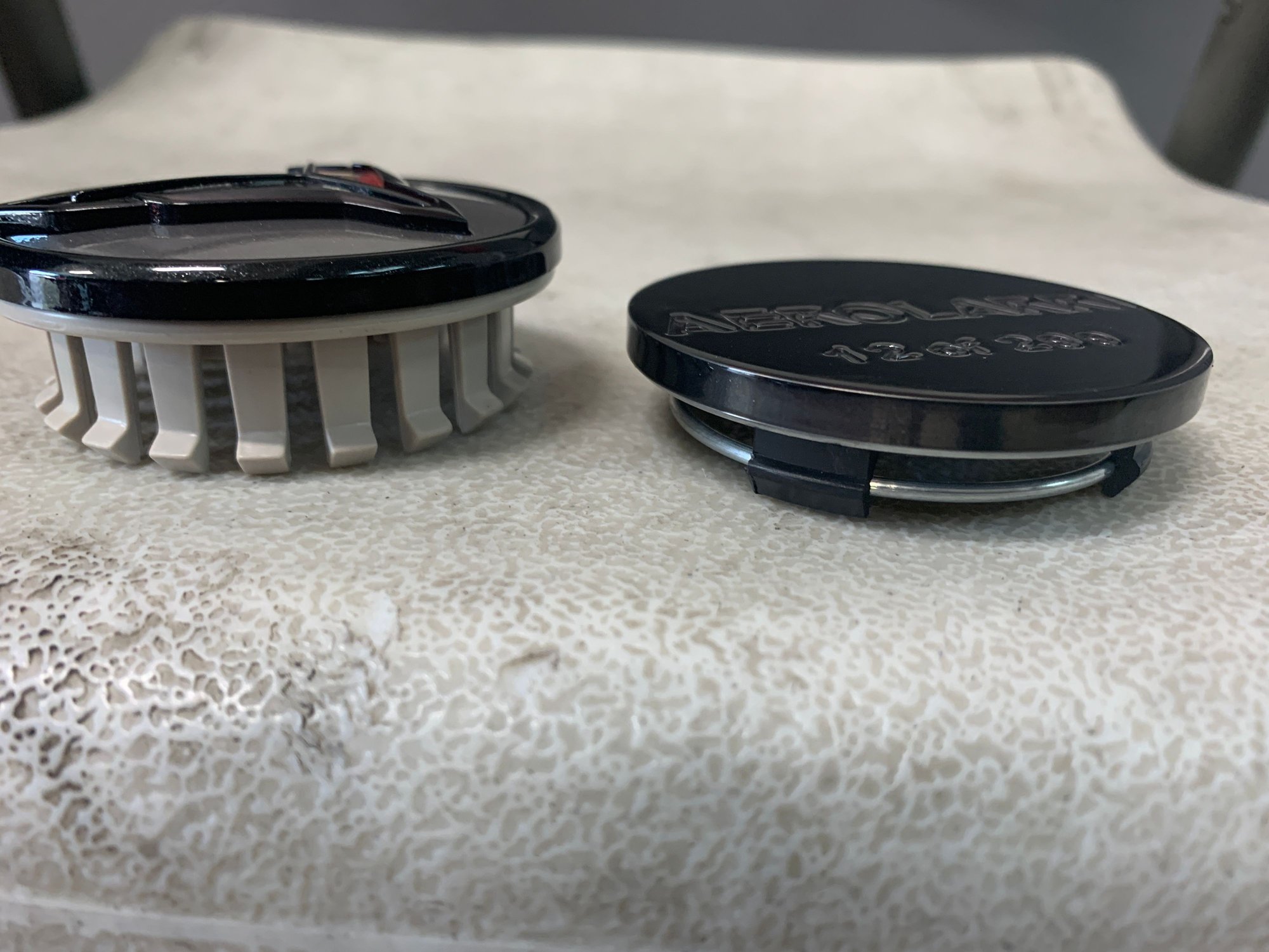

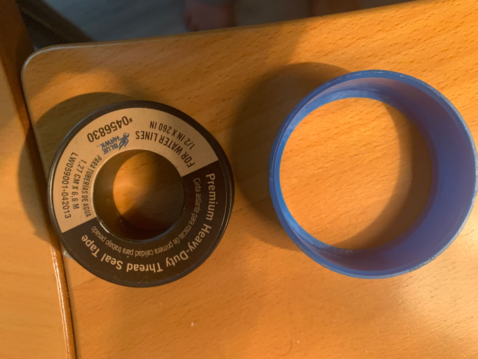

Couple people ask so here is info on how we got the GM center caps to work. Here you can see how long the GM locking lugs are compared to the Aerolarri caps. The GM caps will clip in but move in & out due to length. Used 2 ways to make them stay tight. 1) Wrapped the outside diameter of the GM lugs with pipe thread tape. It's thin and made to compress into pipe thread. Each cap was a little different so it was wrap one layer then try until it stayed tight. 2) The Corvette logo clips onto the cap so we removed the logo ring . Put a small bead of black RTV around the diameter of the cap , snapped them in and let dry Clip logo rings on when dry. RTV can easily be removed by removing the logo ring and peeling it off or cutting with razor. It helps if you bend the GM locking lugs out to increase their diameter. Did one side one way and 2nd the other. My preference for future is using RTV.Did some "high speed runs and have not had an issue with any of the caps staying tight and in place.

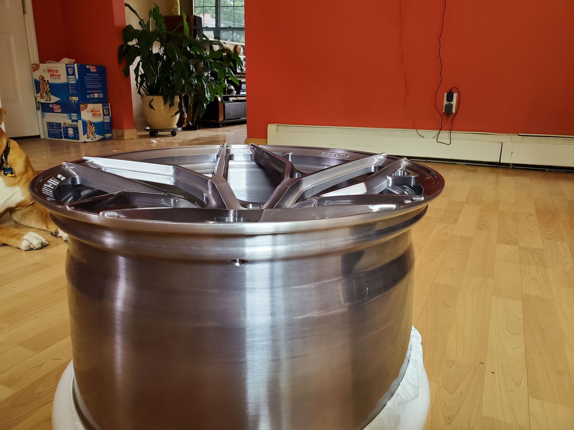

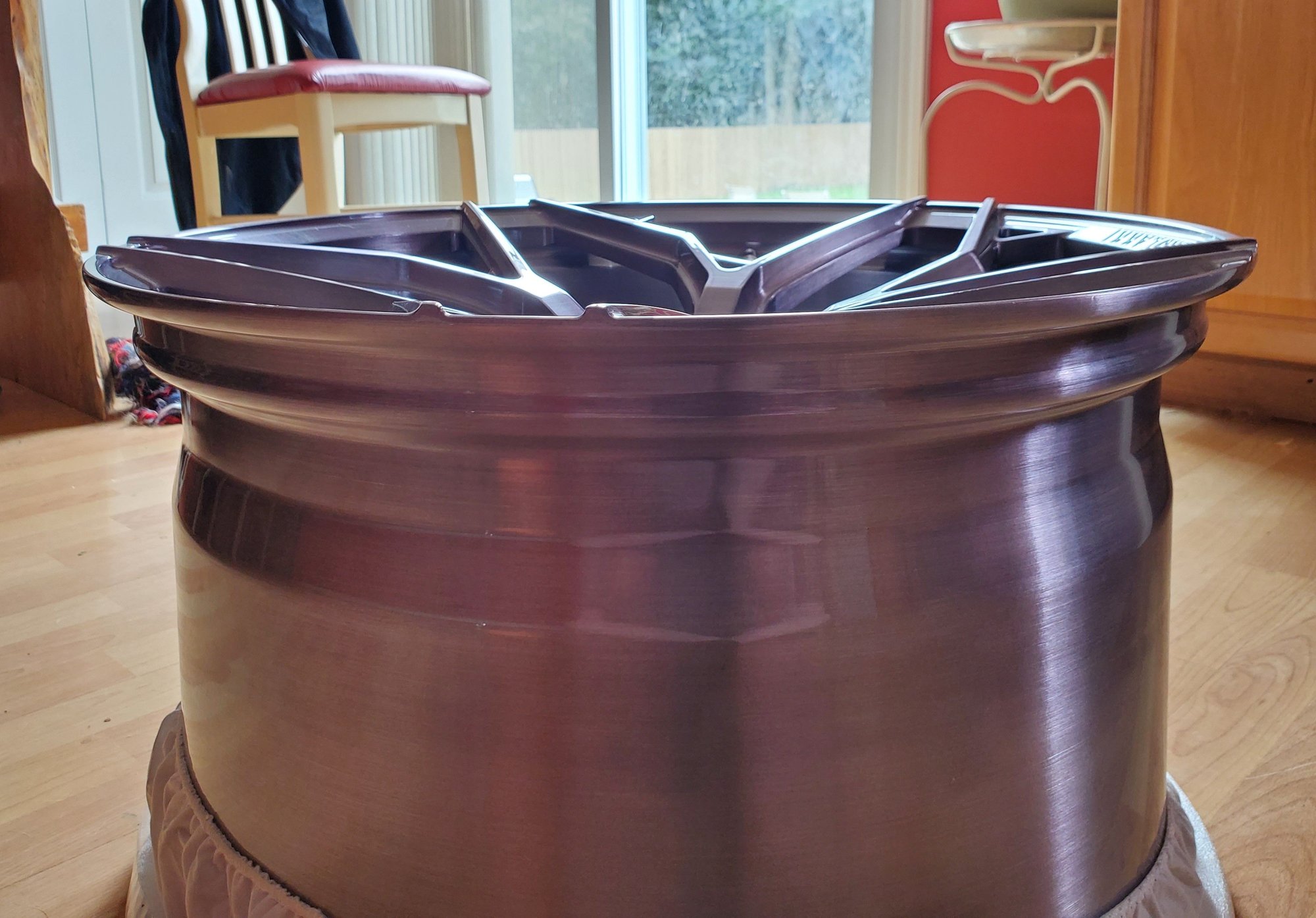

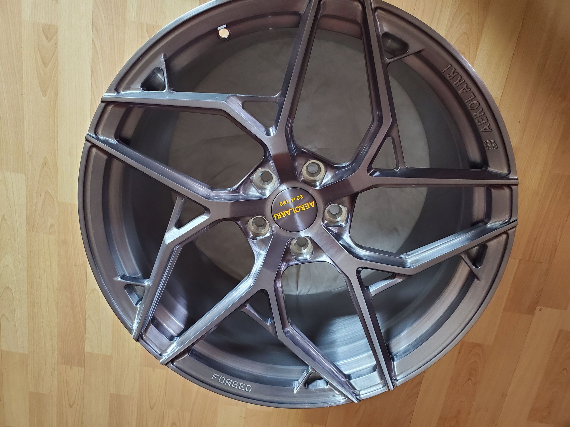

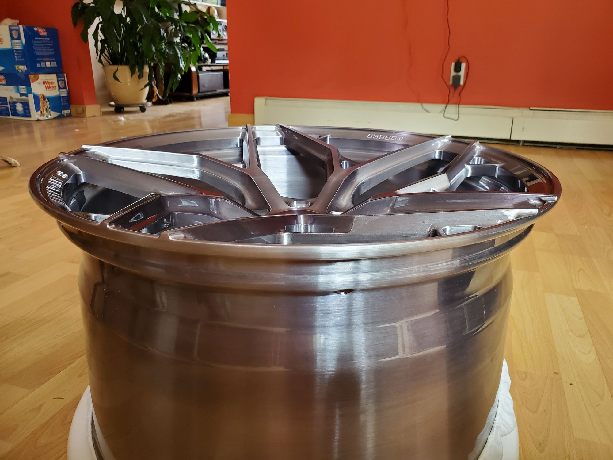

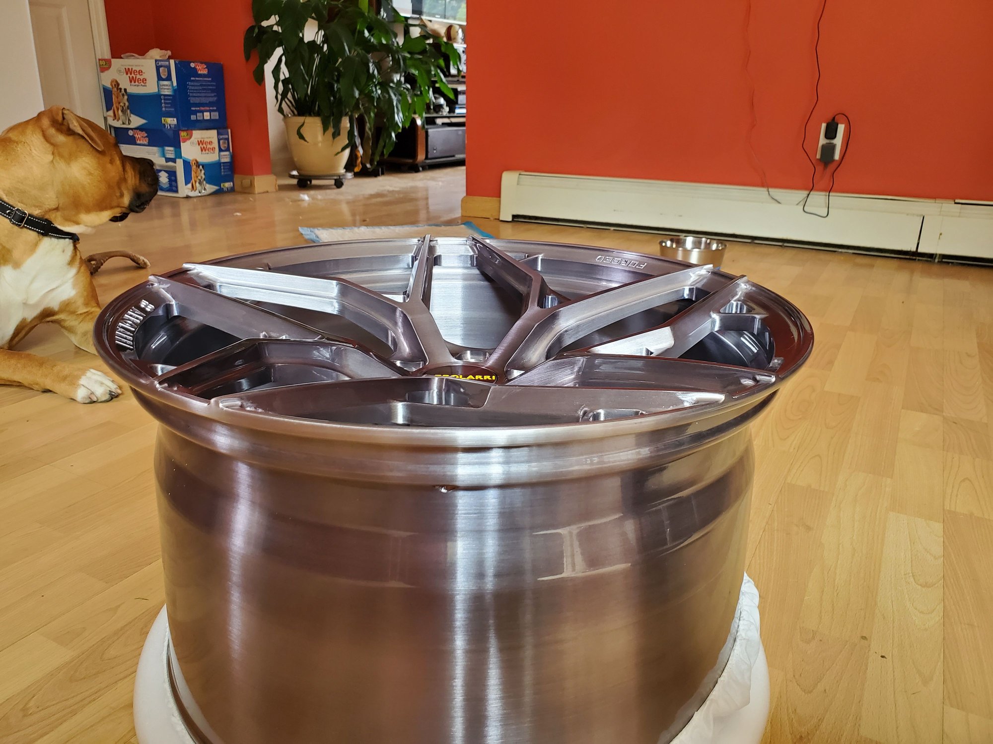

In person, I love this finish, its beautiful, and the rear wheels have a really nice amount of concavity too. Very happy with them. They are 20x12's and 20x9's in UFO Glaze brushed finish.
Also, I don't think anyone has posted weights on these wheels, so I weighed the rears and they are 26.2 lbs ea, which again is a 20x12. So that is 5.9lbs lighter than the OEM rear wheel, and these wheels are 1 inch wider! Big difference!

Appreciate the info will be doing the tape once my wheels come in

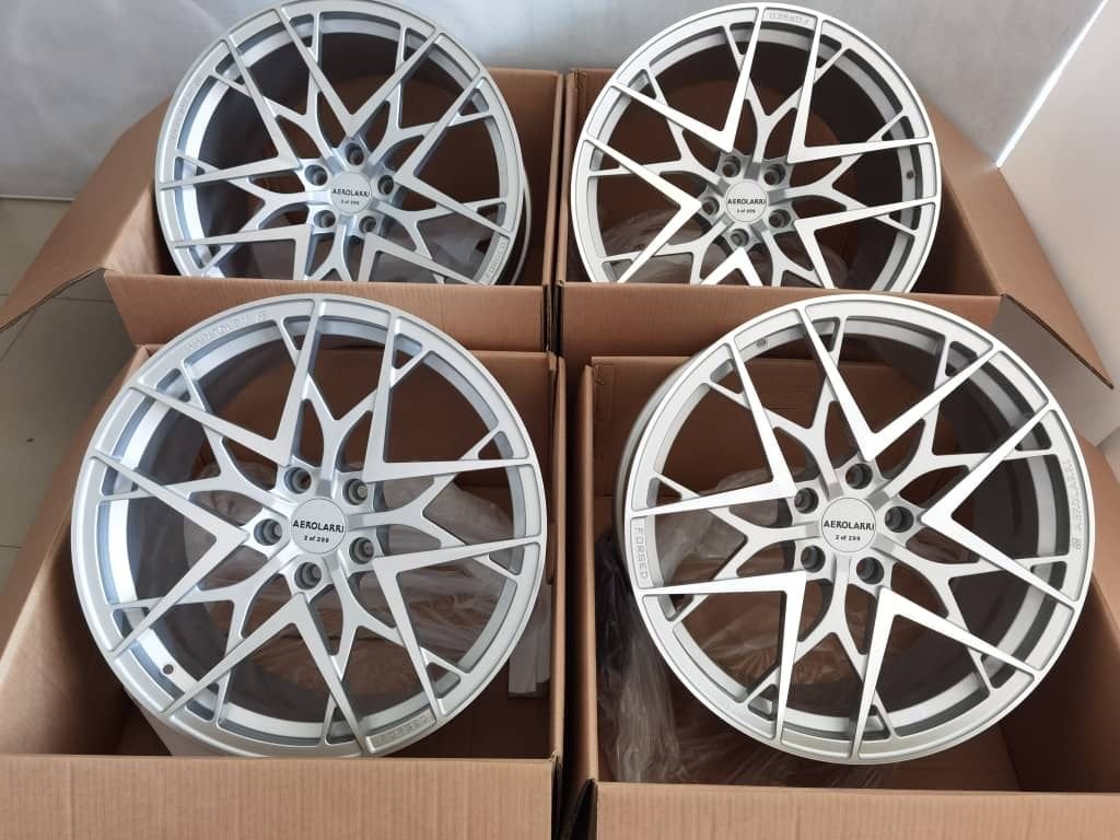

Here is another set on there way this week! HyperNova 20/21s done in silver and machine face. Very subtle contrast that pops in the sunlight!
