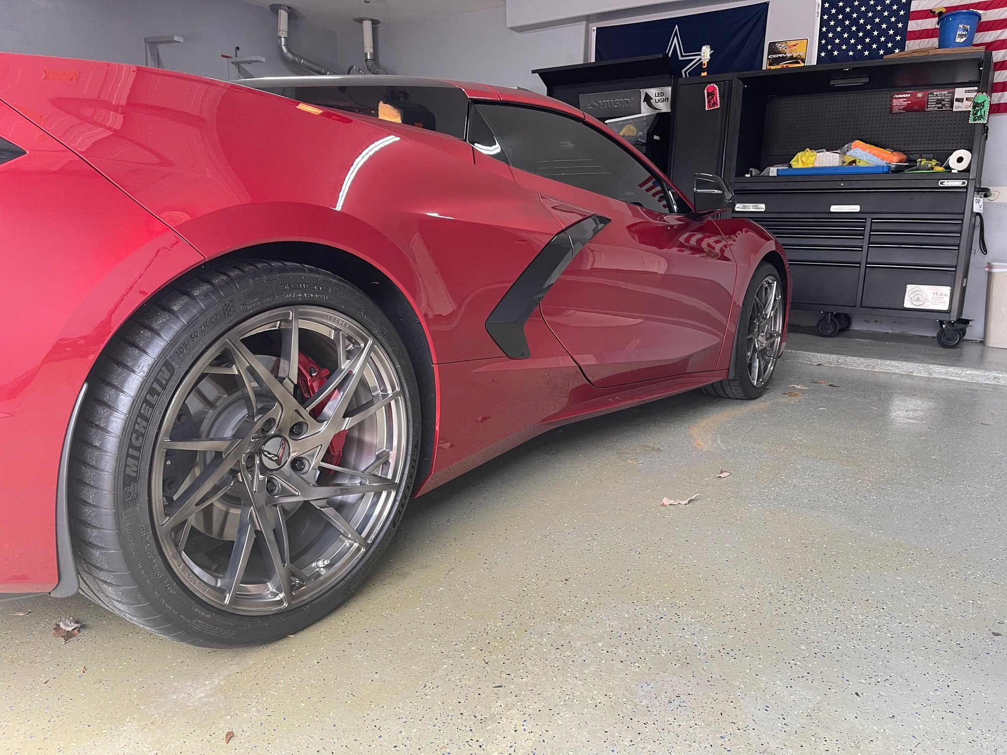

They finally arrived. The chrome lug nuts clashed with the Ghost Black in some lighting conditions so I switched to black locking nuts. I modified the center caps to use my stock faces.
The offset pushes them all the way out to the limit and looks great.
I had a guy chase me down in a parking lot asking where I got them first day out.
They look really good IMO.

Looks great! I ordered UFO Ghost Glazed/Polished and looking at yours, I am hoping they are not too bright 🤦🏻‍♂️

At night and in low light conditions they are darker.

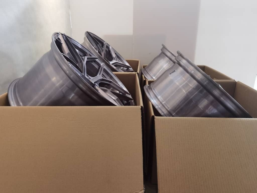

Have you received your wheels and if so post a pic. I ordered a set Oct 13, 2021 and still waiting. It is expected i will get them in Feb.

I’ve had them since July. They have actually been on my white htc and now my amplify orange htc.
