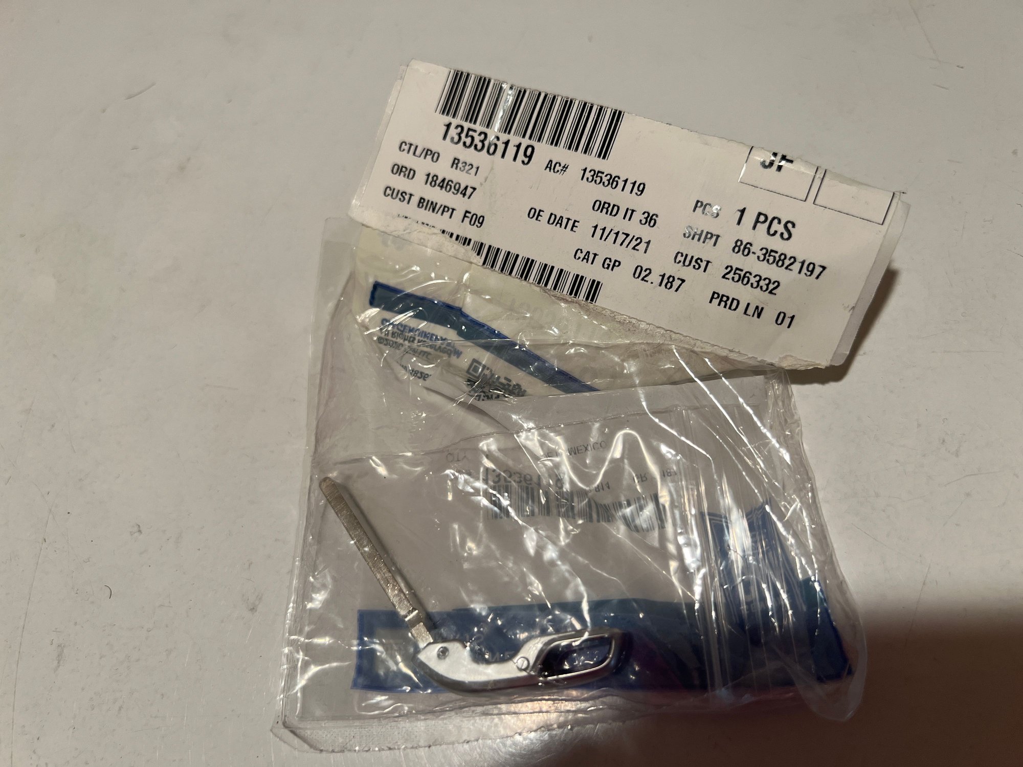

sleekvt's Avatar
sleekvt
Joined: Feb 2020
Posts: 240
Likes: 139
From: San Jose, California
Originally Posted by Bob Paris
And what might that key blank # be????? Sharing is caring.
Key blank for MY23 C8 13536119 - from the dealer it costs $78.70 plus $20 to cut - OUCH! Should have researched it more like the $7 aftermarket key in post #31 with $10 cutting at ACE hardware
Old Jul 3, 2022 | 06:11 AM
EC145Pilot's Avatar
EC145Pilot
Joined: Feb 2021
Posts: 422
Likes: 350
From: Mount Dora, FL
Emergency Key
The local ACE hardware cut it for $10. More than the price of the key blank. Works perfectly.
YMMV
