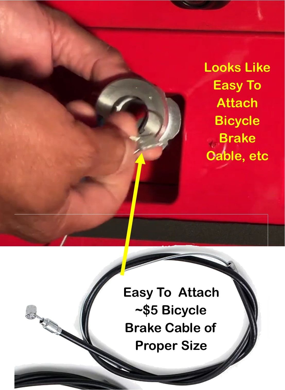

Here's part of the problem - the two 'posts' at the bottom appear to be where the bottom of the key lock cylinder bracket goes.
Definitely have to pull bumper off to figure out how to mount.
It looks like they plugged the original bolt areas.
It may have to be drilled out and nut/bolts (or rivets) used to install the key lock cylinder.
It would help if someone had a photo of a 2020-2022 of the inside showing how the key lock cylinder is installed.
It should be obvious, but it's unclear if they had other parts removed since my 2023 has a wide open area inside where the lock should be.

Originally Posted by sleekvt
Here's my trial fitment of the $12 eBay alternative for emergency trunk release for 2023 Corvette:
Geart Find! 5 STARS!
Was concerned when I 1st saw the device you showed that the key would not be able to exert enough force! That video clearly shows the key does not exert the force at all, it just is a locked cover to the cable!
I made a few pics from your video and added what I think would work best for a cable. As others have mentioned, a bicycle brake cable should work fine. AND have lots of experience with the design of MIG welding torch conducts. The materials and clearances are very important. A bike brake cable may use what we do in our industry, a steel spring like housing with a relatively tight fit to the inner cable (for welding an 0.035-inch diameter wire.) Amazon sells them with stainless cable, and you can get various lengths for ~$5. Bike shop can also supply what is needed. I would attach one end of the bicycle brake cable to the Kiddy Pull all behind the rear truck panel.
Look forward to the final install! Frankly would have been a smarter approach for GM as after using my mechanical key a number of times when my electrical connection failed (using long nose pliers as it was so hard to turn thought I would break the hinged connection) and another poster where the dealer tech broke the cable may be why they discontinued! It's very hard to turn the key. This avoids that issue altogether!
Note pic of latch is what I took when Tech repaired my electrical plug contact issue. He did not remove the bumper!
